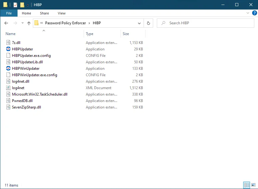

Step 1 – To access the HIBP Updater, navigate to the installation location:
...\Program Files\Password Policy Enforcer\HIBP\
Step 2 – Click HIBPWINUpdater.

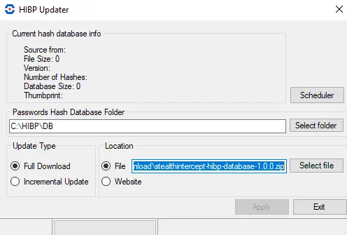

Passwords Hash Database
Password Policy Enforcer utilizes the Passwords Hash database to check if users’ new and pending password (i.e. during a password reset) matches the hash of a compromised password from a data breach.
NOTE: First-time configuration of this window requires downloading the HIBP database from the Netwrix website.
CAUTION: Ensure the initial update of the database occurs during non-office hours. Due to the size of the hash file, this download takes up a significant amount of CPU and download time.
Passwords Hash Database Folder – Central location of the Pwned database on the application server. The default path is:
…\HIBP\DB
Update Type:
Full Download – Download all data from the HIBP database hosted on the Netwrix website
Incremental Update – Download updates from the HIBP database hosted on the Netwrix website instead of downloading the full HIBP database. This option is enabled after a full download of the HIBP database has completed.
NOTE: Only the full HIBP database file obtained from the Netwrix website has version information. That full HIBP database file can be obtained using the Website option. Alternately, the HIBP database can be obtained outside of the application by downloading it directly from the Netwrix website using an FTP connection:
- https://releases.netwrix.com/resources/stealthintercept/stealthintercept-hibp-database-1.0.0.zip
- https://releases.netwrix.com/resources/stealthintercept/stealthintercept-hibp-database-1.0.0.zip.sha256.txt
Then, the File option can be used and incremental updates will be enabled.
Location:
- File – If the application server does not have internet access, you can manually download the HIBP database and select the File radio button to browse to your local copy of the database
- Web Site – This option points to the Netwrix website that hosts a copy of the latest HIBP database. This is the default option and the preferred method if the application server has internet access.
Apply:
- If Website is selected, then clicking Apply downloads the HIBP database from the Netwrix website and then processes the database for use by the application
- If File is selected, then clicking Apply will process the local copy of the (manually obtained) database for use by the application

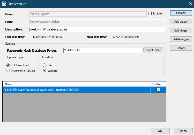

Scheduler
Password Policy Enforcer administrators can use the Scheduler portion of the HIBP Updater to automate the tool to retrieve and/or prepare the HIBP dataset. The Scheduler utilizes Microsoft Task Scheduler technology to execute the process.
How to Schedule a Task
Follow the steps to schedule a task.
Step 1 – Click Scheduler in the HIBP Updater.
Step 2 – Click Add Schedule. An Edit Schedule window appears that looks similar to the HIBP Updater window.
Step 3 – Enter the Name and Description of the schedule.
Step 4 – Select Add Trigger to add the interval that you wish to have the schedule run.
- You can add as many triggers as you want to a schedule.
Step 5 – Select the Update Type and Location to get the update.
Step 6 – Once you have setup your schedule, click OK to save the schedule.
The HIBP database will be updated according to the configurations.
Schedule List
The Schedule List window shows the names, run times, next run times, and whether the schedule is enabled or not.
Use this window to Add, Edit, or Delete schedules for the HIBP Updater.
