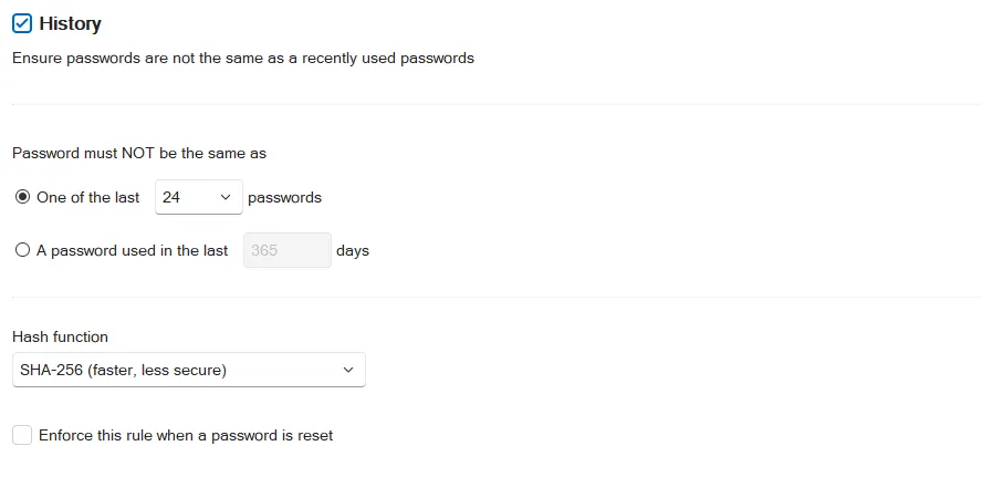

History rule
Select the History check box to enable the History rule.
Select one of the options:
One of the last option to stop passwords from being reused for a specified number of password changes. Choose the number of password changes from the drop-down list.
A password used in the last option to stop passwords from being reused for a specified number of days. Type the number of days in the text box.
Choose an item from the Hash function drop-down list. Argon2 is recommended for best security. The Argon2 option uses 100,000 times more computing power to create a hash, so an attacker needs 100,000 more computing power to crack Argon2 hashes. Argon2 increases password change times by 400%, so a domain controller that can handle 1,000 password changes a minute with SHA-256 can be expected to handle 250 password changes a minute with Argon2. All numbers are approximate. Use Argon2 if your domain controllers can handle the load.
NOTE: Changing the Hash function does not modify existing history records. It sets the function to be used for new password history records. If a user has Argon2 and SHA-256 hashes in their password history, then Password Policy Enforcer calculates both the Argon2 and SHA-256 hashes during a password change to ensure the new password is not in the password history.
The History rule is normally not enforced when a password is reset. Select the Enforce this rule when a password is reset check box to override the default behavior. You must also select the Enforce policy when password is reset option in the PPS Properties page to enforce this rule when a password is reset.

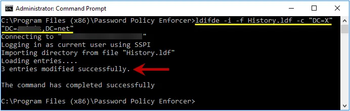

Follow the steps below to create a new Active Directory attribute for the password history.
Step 1 – Log on to the server holding the Schema Operations Master role with an account that is a member of the Schema Admins group.
Step 2 – Open a Command Prompt window to the Password Policy Enforcer installation folder.
(\Program Files (x86)\Password Policy Enforcer)
Step 3 – Type the following command:
: ldifde -i -f History.ldf -c "DC=X" "DC=yourdomain,DC=yourdomain"
Replacing the last parameter with your domain's DN.
Step 4 – Press ENTER and check the output for errors.
