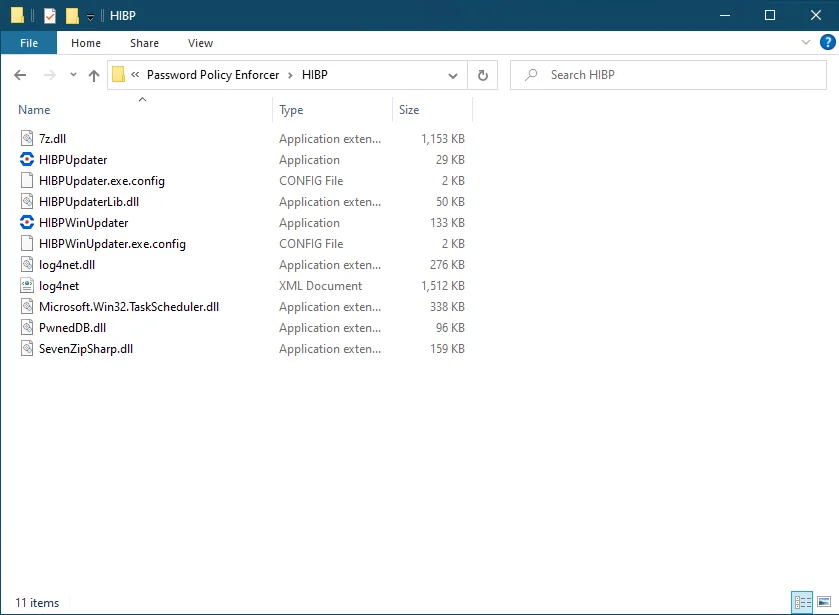

Step 1 – To access the HIBP Updater, navigate to the installation location:
*...\Program Files (x86)\Password Policy Enforcer\HIBP*
Step 2 – Click HIBPWINUpdater.

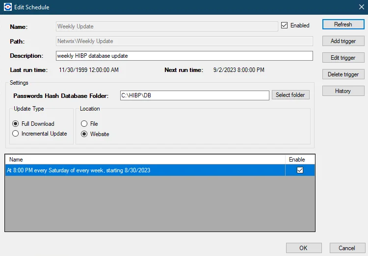

Step 1 – Click Scheduler in the HIBP Updater.
Step 2 – Click Add Schedule. An Edit Schedule window will appear that looks similar to the HIBP Updater window.
Step 3 – Enter the Name and Description of the schedule.
Step 4 – Select Add Trigger to add the interval that you wish to have the schedule run.
- You can add as many triggers as you want to a schedule.
Step 5 – Select the Update Type and Location to get the update.
Step 6 – Once you have setup your schedule, click OK to save the schedule.
The HIBP database will be updated according to the configurations.

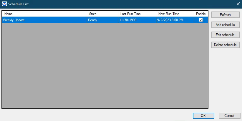

Schedule List
The Schedule List window shows the names, run times, next run times, and whether the schedule is enabled or not.
Use this window to Add, Edit, or Delete schedules for the HIBP Updater.
