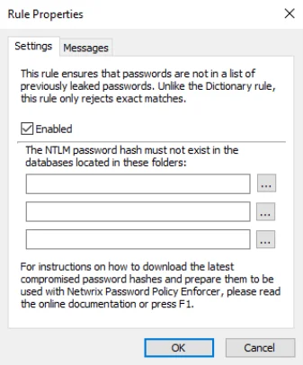

The Compromised rule rejects passwords from prior breaches. These passwords should not be used as they are vulnerable to credential stuffing attacks.
ppe_rules_6_337x406
Select the Enabled check box to enable the Compromised rule.
Click the ... (ellipsis) button beside each text box to select a hash file. You can also type a path into the text box. The path can contain environment variables like
CAUTION: %SystemRoot%. hash files should only be read from a local disk. Using shared hash files degrades performance, and could jeopardize security.
Click the Messages tab to customize the Password Policy Client rule inserts.
