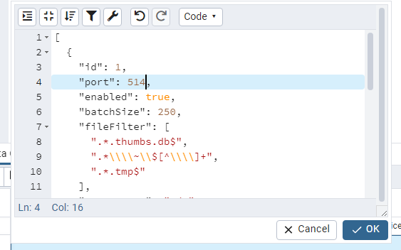

  5. Change Value for the port in question on line 2 (10000 is the default File System (FS) port and 10001 is the default Active Directory (AD) port):
[{"id":1,"port":10000,"enabled":true, ...}{"id":2,"port":10001,"enabled":true, ...}{...}]
For example, change the FS port to 514 and click OK:
pgAdmin JSON editor showing the FS port value changed to 514
