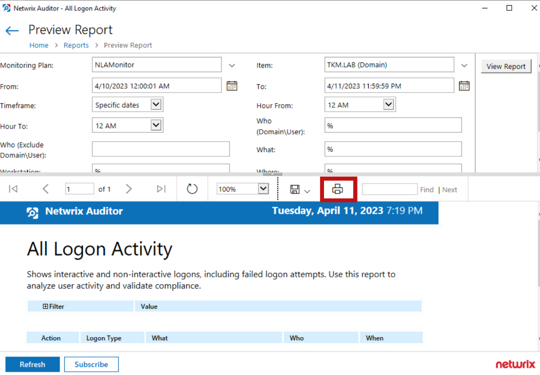

    1. In Netwrix Auditor, navigate to the Reports menu and run a report.
    2. Click the Print icon, select the appropriate format, and click Print.
      Print dialog or options
    3. Proceed with the further steps to save the report.
