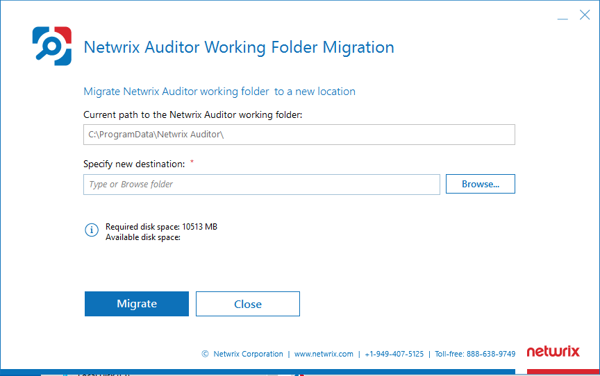

  1. Navigate to %Netwrix Auditor installation folder%\Audit Intelligence and launch the WorkingFolderMigration.exe utility.
  2. Specify the target folder in the Specify new destination field.
    User-added image
    IMPORTANT: Network shares are not supported − make sure the new Working Folder destination is a local folder.
  3. Click Migrate. All temporary data from %ProgramData%\Netwrix Auditor\ will be copied to the specified target folder.

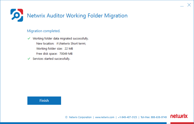

  4. Wait for the migration process to complete. Your final screen should look like the following screenshot in case the migration process was completed correctly:
If the migration process was completed successfully, proceed to steps described in Scenario A.

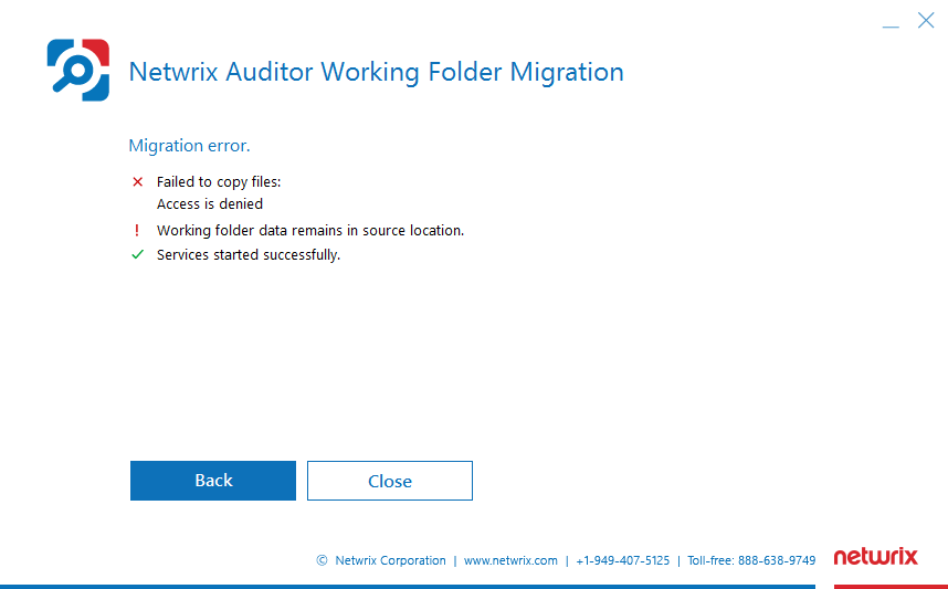

In case any error occurs during the migration process, the Working Folder contents will remain in the original location. The final screen might look like the following screenshot:
User-added image
In case the migration process was not completed successfully, follow the steps described in Scenario B.
Post-migration actions − Scenario A
If migration was completed successfully, refer to the following steps:
  1. Take 1 to 2 days to verify the new configuration — make sure there are no related errors in the Netwrix Auditor Health log.
  2. Once you have verified the proper operation, open the source location (original Working Folder) to remove old trace logs. Locate the following folders:
    • %ProgramData%\Netwrix Auditor\Logs\Archive
    • %ProgramData%\Netwrix Auditor\AuditCore\Logs
    • %ProgramData%\Netwrix Auditor\ShortTerm
    • %ProgramData%\Netwrix Auditor\SyslogCollection
    • %ProgramData%\Netwrix Auditor\FileStorageAuditor
  3. Make a backup copy of the contents, then remove these folders
NOTE: The %ProgramData%\Netwrix Auditor\AuditCore folder data other than trace logs usually does not occupy much space. If you do have to have this folder cleared, it is recommended to double-check and back up the contents before the cleanup.
Post-migration actions − Scenario B
If migration was completed with any errors, refer to the following steps:
  1. In the source location − Keep all source files as is in the source location (original Working Folder). Do not delete them from the source folder. Netwrix Auditor will continue working using the original folder files.
    IMPORTANT: Netwrix Auditor configuration changes only after a successful migration. Otherwise, if any error occurs, the configuration remains the same with the original Working Folder path preserved. Keep all files in the original location for Netwrix Auditor to be able to use that folder.
  2. In the target location − As the Netwrix Auditor configuration does not change in case of unsuccessful migration, you can safely remove the files found in the target location. After that you can run the migration utility once again. In case errors still occur during the migration process, contact Netwrix Technical Support: Open a Ticket · Netwrix 🧭
