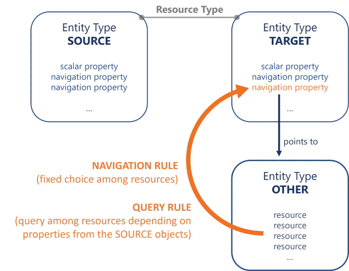

A navigation property's value can be computed by a navigation rule or a query rule, assigning a given resource from the entity type pointed by the navigation property (which can be the target entity type itself). Let's call this entity type the "other" one.
  • A Navigation rule assigns a fixed resource, which is chosen from among the "other" entity type's resources during the rule's creation. The assigned resource is the same for all impacted accounts. Use a navigation rule when a given resource must be assigned, regardless of users' attributes.
  • A Query rule assigns a resource from the "other" entity type too. However, the resource is chosen according to a query via a C# expression with conditions, based on the attributes of the source objects (usually users). Hence, contrary to a navigation rule, a query rule can assign a different resource for each impacted account, based on the attributes of the account's owner. Use a query rule when there is the need to use variables from among users' attributes to select the resource to assign.

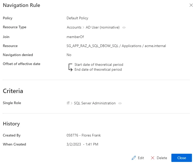

A navigation rule could add the AD group SG_APP_SQL to the memberOf navigation property to all AD nominative accounts provided that the user has the single role SQL Server Administration.

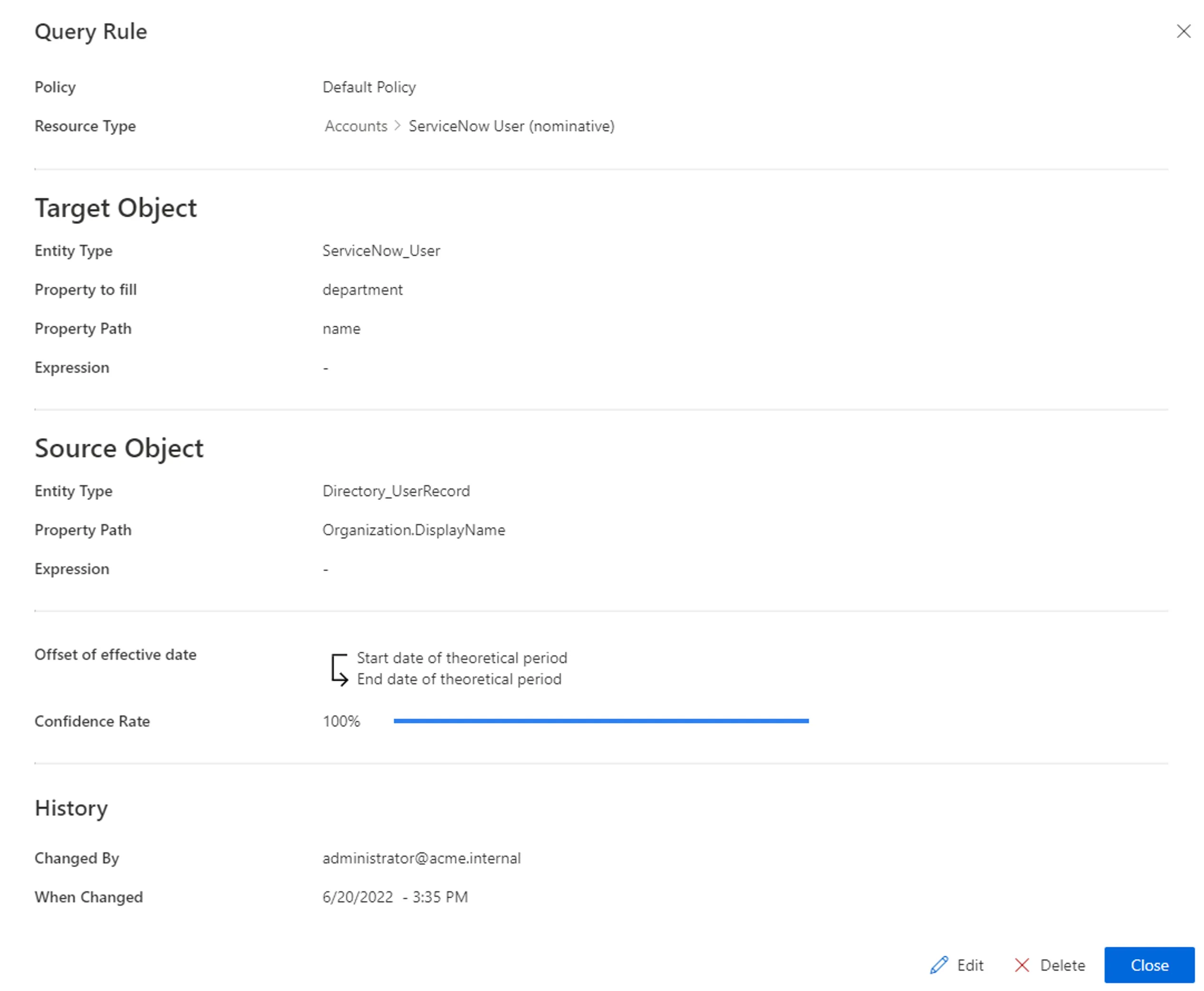

A query rule could compute the value of the department navigation property for ServiceNow nominative accounts (entity type ServiceNow_User), with a query from among resources from the ServiceNow_Department entity type, where the name of the resource would match the display name of the organization specified for the user (owner of the ServiceNow account).
We need here to query the ServiceNow_Department entity type in order to find the right department to update the value of department, which is specific to each ServiceNow account.
Thus, each user owning a ServiceNow account will see the value of department in their account updated with the resource from ServiceNow_Department which corresponds to the department specified for this user.

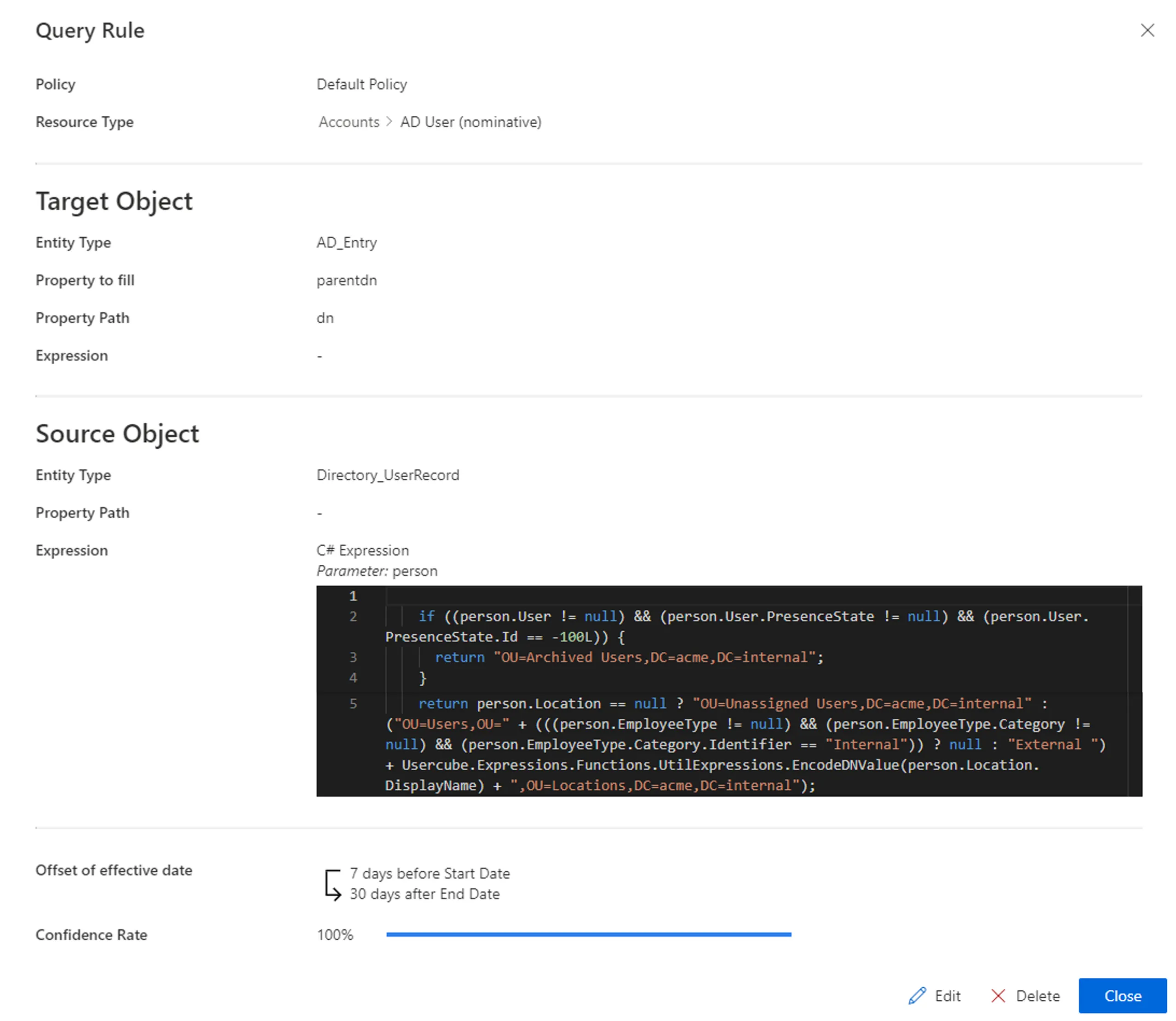

Another query rule could compute the parentdn attribute for AD nominative accounts, with a query from among AD entries, where the dn attribute of the resource would match a complex expression based on the user's (owner of the AD account) presence state, employee type, location, etc.
We need here to query the AD - Entry entity type in order to find the right dn to update the value of parentdn, which is specific to each AD nominative account.
Thus, each AD nominative account will have the value of its parentdn set according to its owner's attributes (presence state, employee type, location, etc.).
The application of a navigation rule can depend on the assignment of a single role, and/or user dimensions. See the Create Roles in the Role Catalog topic for additional information on the assignment of a single role and Conforming Assignments topic for additional information on dimensions.

In Identity Manager, a navigation property has two "sides", one for each linked element.
For example in the AD, the group membership of a user is represented by the properties member for groups (containing a list of users) and memberOf for users (containing a list of groups).
However, some managed systems only have one of these two sides.
The AD only uses member from among groups' properties. Users do not have a memberOf property. As Identity Manager uses and links both sides, it is able to "translate" the information, so that the corresponding navigation property, which actually exists in the managed system, is modified by the navigation/query rule.
Identity Manager assigns an entitlement to a user by assigning a group-membership to an account. Thus we can create a navigation rule which adds a group to the memberOf property of given accounts. Identity Manager will update the member property of groups accordingly (in Identity Manager), and then provision the member property of said groups in the AD, adding the impacted accounts.
A navigation rule will trigger the creation of a target resource for all impacted source resources (so all users), which are not yet correlated with a resource of this resource type.

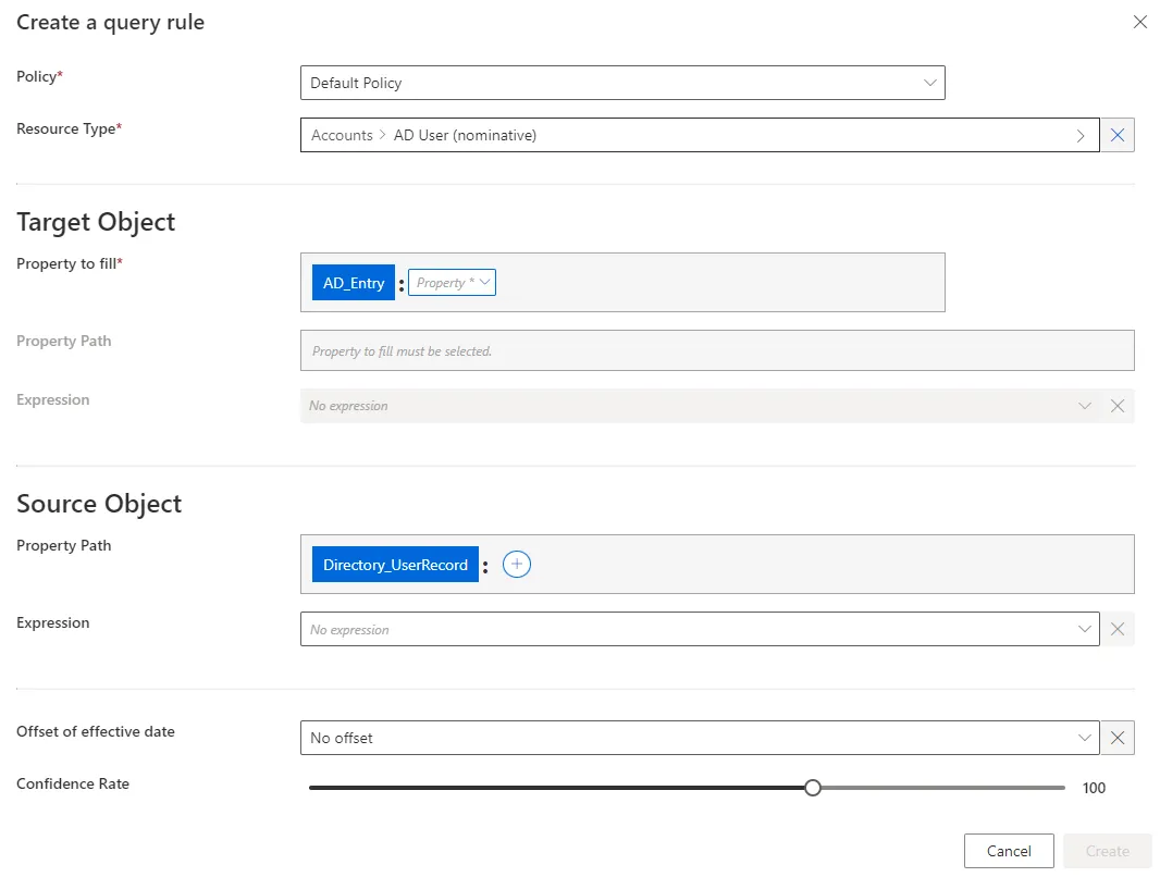

Create a Query Rule
Fill an entity type with a query rule by proceeding as follows:
Step 1 – Click on Access Rules on the home page in the Configuration section.
Home - Access Rules
Step 2 – In the dropdown menu at the top left, choose the source entity type for the future query rule.
Entity Type Choice
Step 3 – Click on the Queries tab and on the addition button at the top right corner.
Addition Icon
Fill in the fields.
Create Query Rule
Once the Resource Type is provided, more fields appear.
Query Rule Fields
  • Target Object > Property to fill: navigation property from the target entity type, whose value is to be impacted.
  • Target Object: property (or expression of properties) from the entity type pointed by the Property to fill, which will be the value of the Property to fill if it matches the source object. Can be defined by a property path and/or an expression. See the Expressions topic for additional information.
  • Source Object: property (or expression of properties) from the source entity type. Can be defined by a property path and/or an expression. See the Expressions topic for additional information.
  • Offset of effective date: time period that defines the actual effective date according to the value's start and/or end date. An offset of effective date can be useful for some attributes. For example, account activation and deactivation can be managed according to the start and/or end dates.
  • Confidence Rate: rate expressing the confidence in this link, and its priority order. See the Classify Resources topic for additional information.
Our examples would look like:
Query Rule Example
Query Rule Example 2
Click on Create and see a line added on the rules page.
