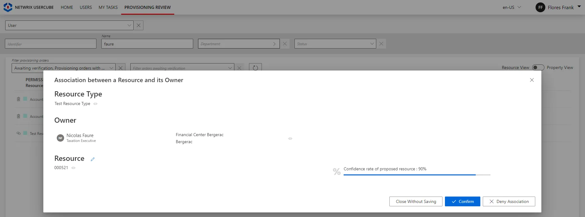

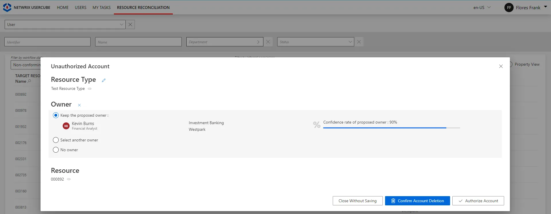

When the confidence rate is below 100%, correlation and classification reviews are to be done:
on the Provisioning Review page when the owned resource is allowed by the role model, i.e. requested manually or assigned automatically by a resource type rule;
on the Resource Reconciliation page when the owned resource is not allowed by the role model, i.e. not requested manually nor assigned by a resource type rule. For example, the creation of a correlation rule without a resource type rule triggers unauthorized accounts on the Resource Reconciliation page.
Broadly speaking, the Resource Reconciliation page displays non-conforming assignments/values (gaps), i.e. resources and property values from the managed systems that are not allowed by a rule in Identity Manager. The Provisioning Review page displays the resource and property changes whose workflows require a manual approval.

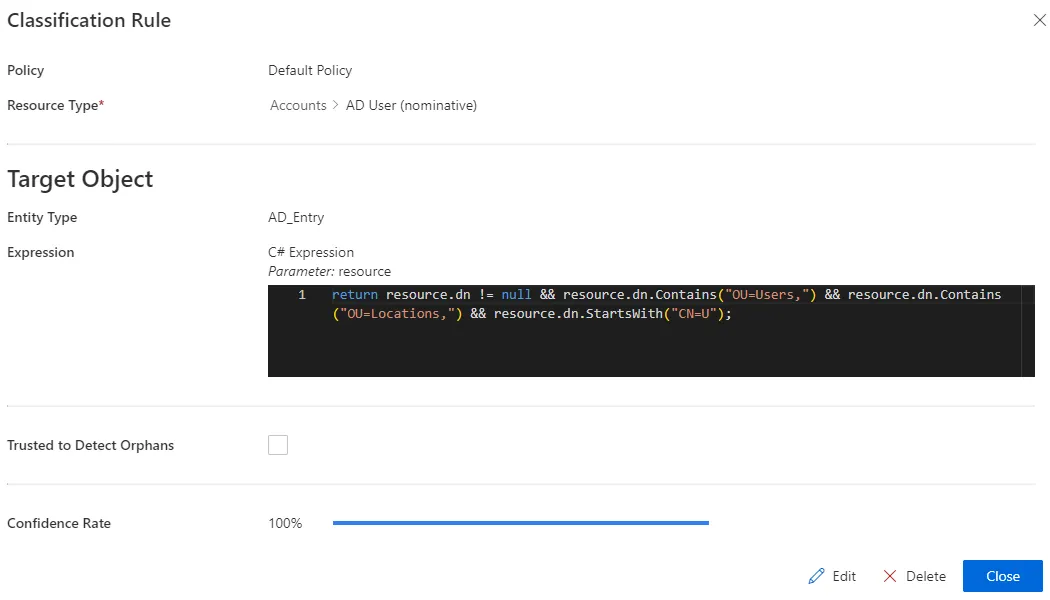

Consider an organization that places basic users in organizational units Users
and Locations
with a CN starting with U
. This means that a basic user should have a dn
attribute different
from zero, containing OU=Users
and OU=Locations
, and starting with CN=U
. Then, a
classification rule could take as a target expression:
return resource.dn != null && resource.dn.Contains("OU=Users,") && resource.dn.Contains("OU=Locations,") && resource.dn.StartsWith("CN=U");

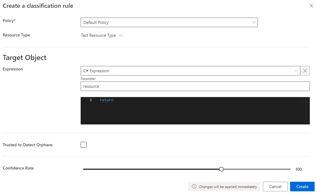

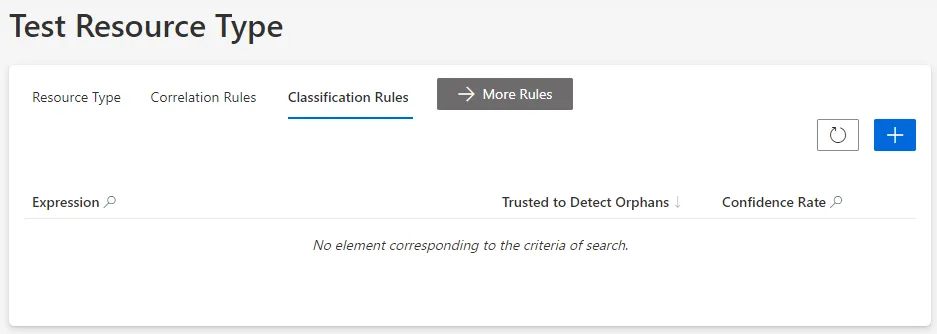

On the relevant resource type's page, click on Classification Rules and the addition icon.
Classification rules can also be created through the Access Rules screen (accessible from the home page, in the Configuration section), clicking on the Classifications tab and the addition button at the top right corner.
Fill in the fields.
- Target Object >
Expression
: C# expression based on the resource that needs to be classified. Confidence Rate
: rate expressing the rule's reliability, and its priority order..Our overview example would look like:
- Target Object >
Click on Create and see a line added on the rules page.

An action (addition/modification/deletion) on a classification rule doesn't trigger a new computation of classification for the resources that are already categorized, i.e. both classified and correlated. The new version of said classification rule will be applied only to new resources along with the existing resources whose correlation and/or classification was not yet reviewed (as unauthorized accounts on the Resource Reconciliation screen).
Thus only non-conforming resources (unauthorized accounts on the Resource Reconciliation screen) can have their correlation and classification re-computed.
Even without selecting an owner, reviewing unauthorized accounts on the Resource Reconciliation screen "blocks" correlation and classification "as is". Neither will be re-computed.
This also means that only non-conforming resources (displayed on the Resource Reconciliation screen) can have their classification questioned and re-computed.

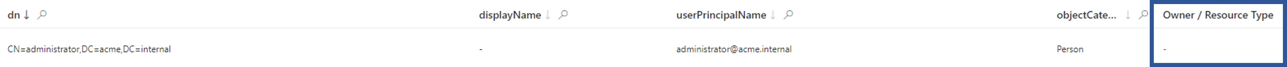

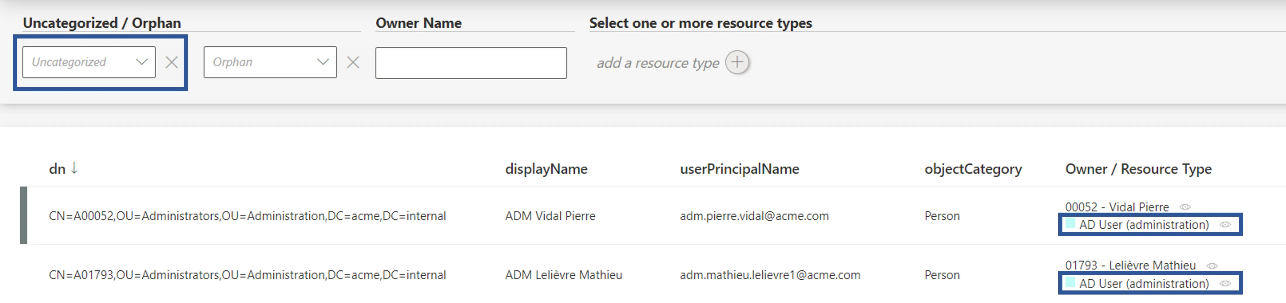

In order to verify the process, analyze samples and check that all objects are classified, and well classified. To do so, click on the target entity type(s) affected by your rule(s) in the left menu of the home page.
The entity type's page can be configured via XML to customize all displayed columns and available filters, especially the Uncategorized filter that spots unclassified resources, and the Owner / Resource Type column that shows the resource type assigned to each resource.
Therefore, check that all resources show here a resource type. Moreover, a knowledgeable person must analyze a few samples to ensure that resources are classified in the right resource type.
