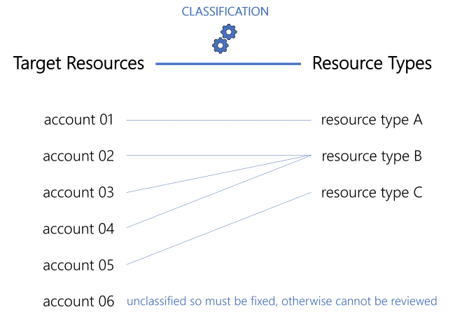

Classification is a process that simply aims to assign a resource type to specific resources. A specific resource can only be assigned a single resource type. See the Entitlement Management topic for additional information.
Classification Schema
Any resource that is unclassified will not be available for review.

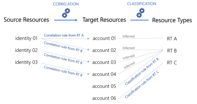

Sometimes you may not know if your rules are always going to apply. Therefore, each rule expresses a certain level of confidence. Identity Manager will establish a priority order between rules based on the confidence rate, and will also act differently depending on whether the confidence rate is above or below 100%. See the Correlate Resources topic for additional information.
A resource type can have zero correlation rules, since accounts can be without owners. But a resource type with neither correlation nor classification rules serves no purpose.
Correlation triggers classification: a matching correlation rule for a given resource type will perform both actions of categorization: both correlating a resource with its owner, and classifying the resource at the same time.
