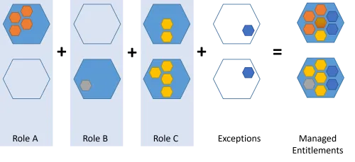

Composite roles can also be created based on the rules provided by Role Mining. Rules link roles to dimensions. See the Perform Role Mining topic for additional information.
The following example shows single roles from A to F. Role Mining suggested the rules on the schema, linking these single roles to the organizations R&D and Project as well as to the functions developer, writer, contractor and project manager. The idea is to use these rules to create composite roles. Here, we clearly have one role for R&D-developer, one for R&D-writer, Project-contractor and Project-project manager. Thus, it is clear here that composite roles add an abstraction layer.
Single role rules link composite roles to single roles: a single role rule states that specific single roles are assigned according to specific criteria, particularly composite roles. See the Single Role Rule and Create Roles in the Role Catalog topics for additional information. Thus, a composite role assignment can imply specific single role assignments.

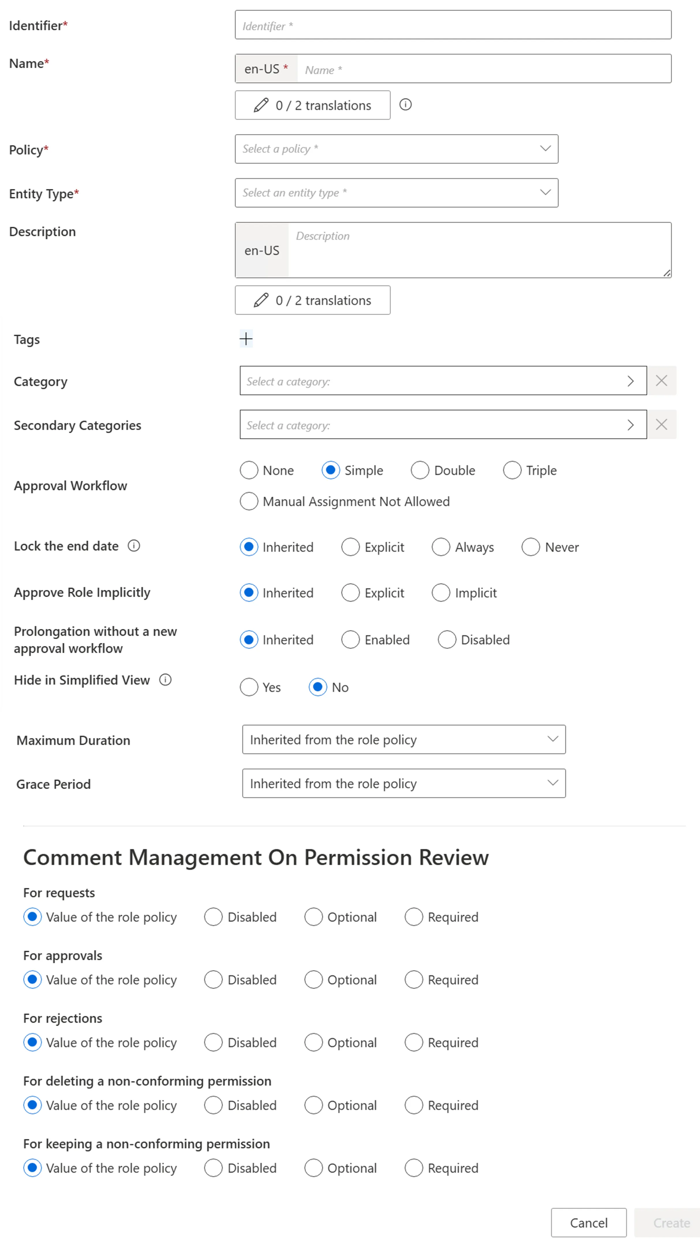

Step 3 – Fill in the fields.
Identifier: must be unique among roles and without any whitespace.
Name: will be displayed in the UI to identify the single role.
Policy: policy in which the role exists.
Entity Type: entity type targeted by the role.
Category: category assigned to the role.
Secondary Categories: other potential categories assigned to the role.
Approval Workflow: represents the number of validations required to assign the role.
Lock the end date: locks manual permission at the end date. Has four options:
- Inherited: the policy's setting will be used.
- Explicit: at the time of assignment, the end date can be specified manually or can be locked to the applicable context rule.
- Never: the end date will never be locked and needs to be specified manually.
- Always: the end date is always locked according to the applicable context rule.
Approve Role Implicitly: needs at least a simple approval workflow. Implicit mode bypasses the approval step(s) if the person who issues the role request is also the role officer. Explicit refuses said bypass. Inherited follows the policy decision to approve roles implicitly or not.
Hide in Simplified View: hides the role from the users' Simplified View in View Permissions dialog. This setting does not apply to roles which are either inferred or have workflow states which require manual action.
Comment Management on Permission Review: to change if different from the role policy.
Maximum Duration: duration (in minutes) after which the role will be automatically revoked, if no earlier end date is specified. It impacts only the roles which are manually assigned after the maximum duration is set. Pre-assigned roles are not impacted. If no duration is set on the role, the MaxDuration of the associated policy is applied. If the MaxDuration is set to 0 on the role, it prevents the associated policy from applying its MaxDuration to it.
