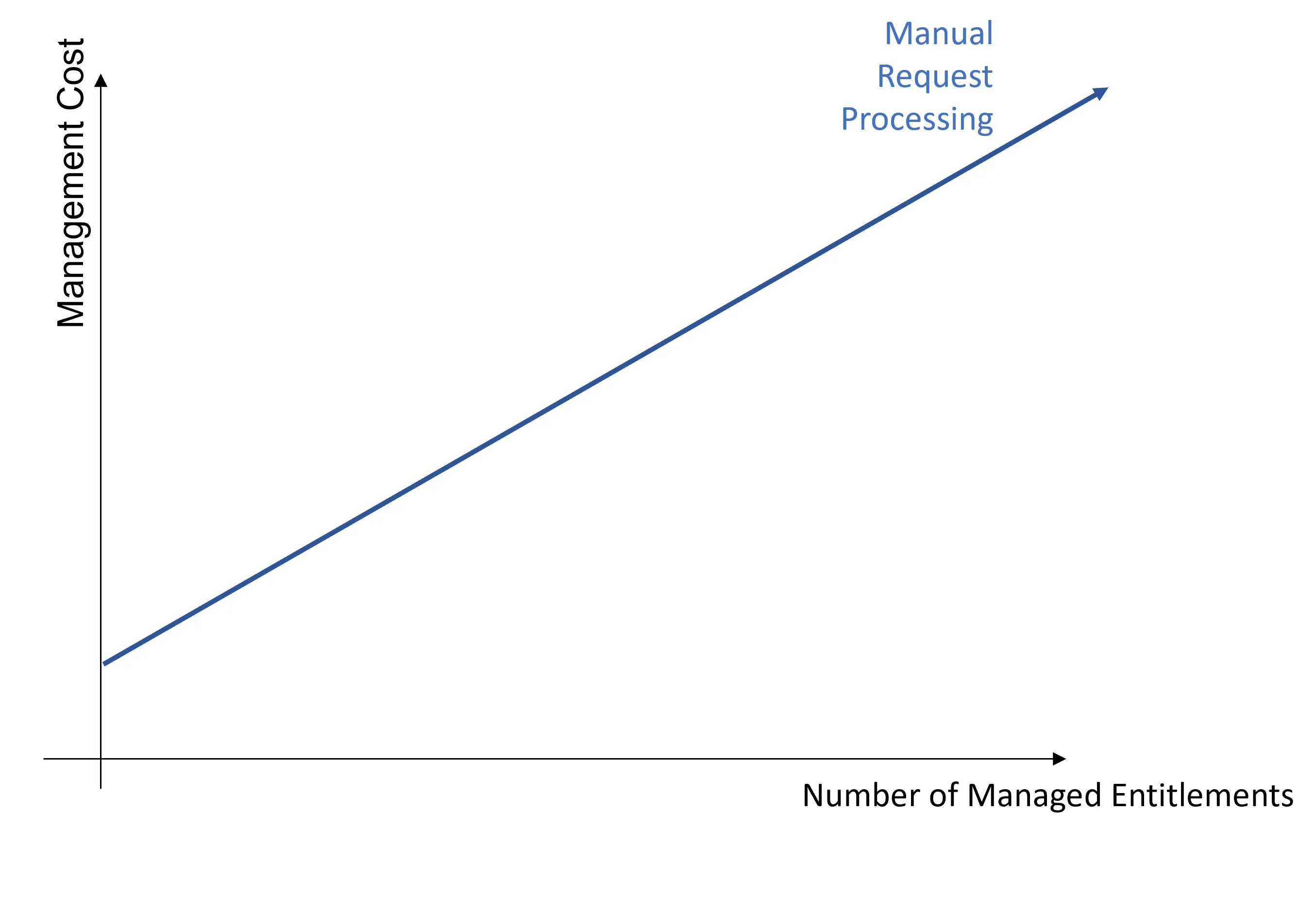

The entitlement management cost mainly varies according to the number of managed entitlements. Manual processing for entitlement requests implies a linear growth of the management cost according to the number of managed entitlements.
Optimal Cost Chart - Manual Assignments

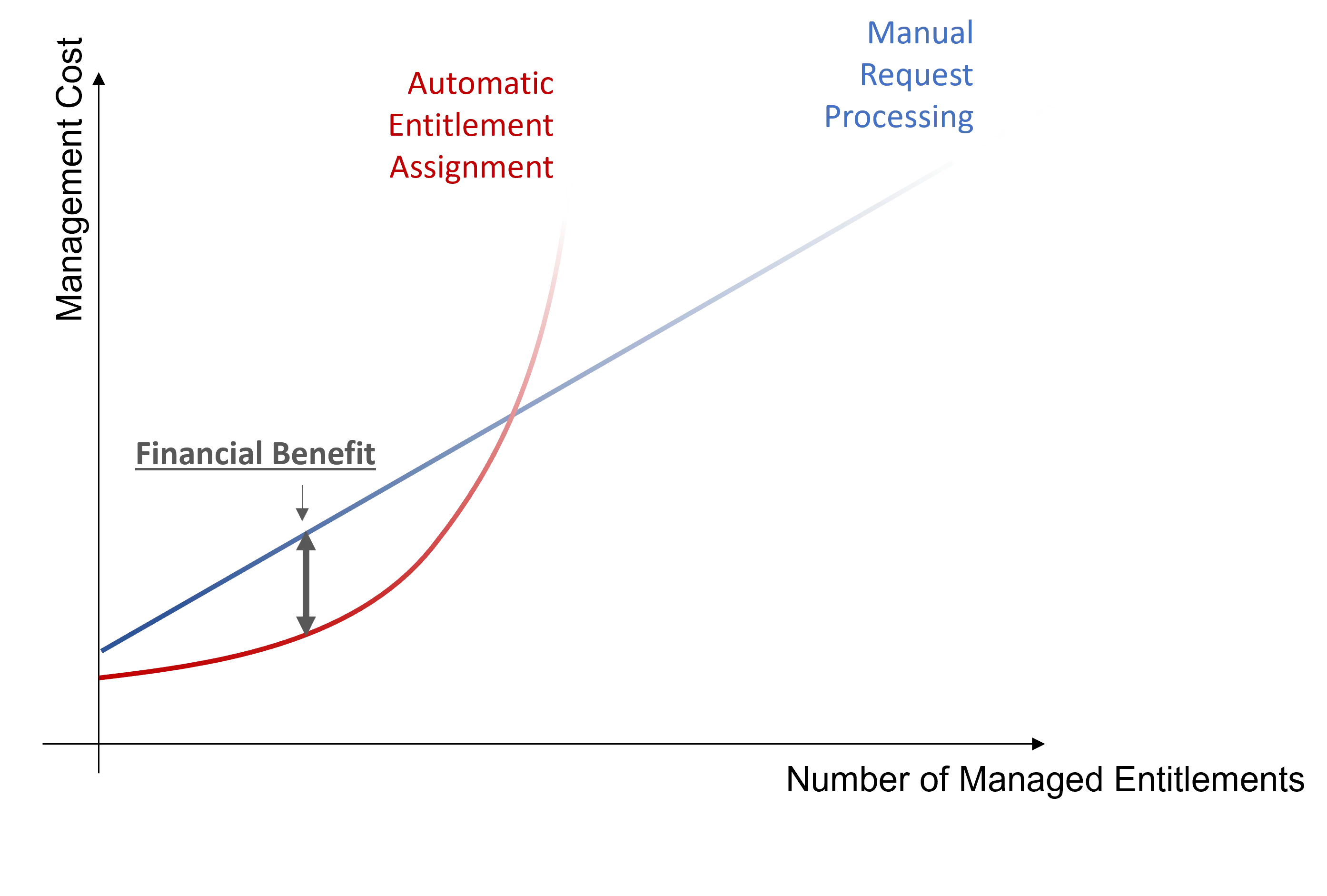

There is a high potential gain coming with the automation of assignment decisions:
  • Machine Learning masters the error rate, as it is used as a parameter for Role Mining, i.e. masters false positive assignments (entitlements assigned to a user while they ought not to) which constitute a security breach, and false negative assignments (entitlements not assigned to a user who needs it) which are functionnaly blocking;
  • Machine Learning achieves lower error rates than people;
  • Machine Learning can compute the role model way faster than a person. Consequently, the model can be computed more frequently and thus sticks closer to reality.
Optimal Cost Chart - Automation Benefits
Automation helps integrators find basic assignment rules and face the previous risks, thus reducing cost.

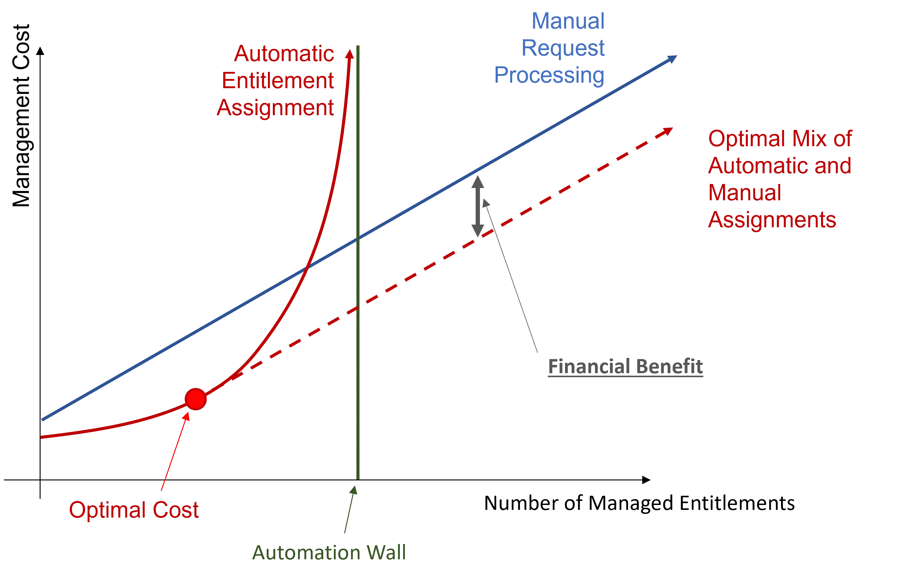

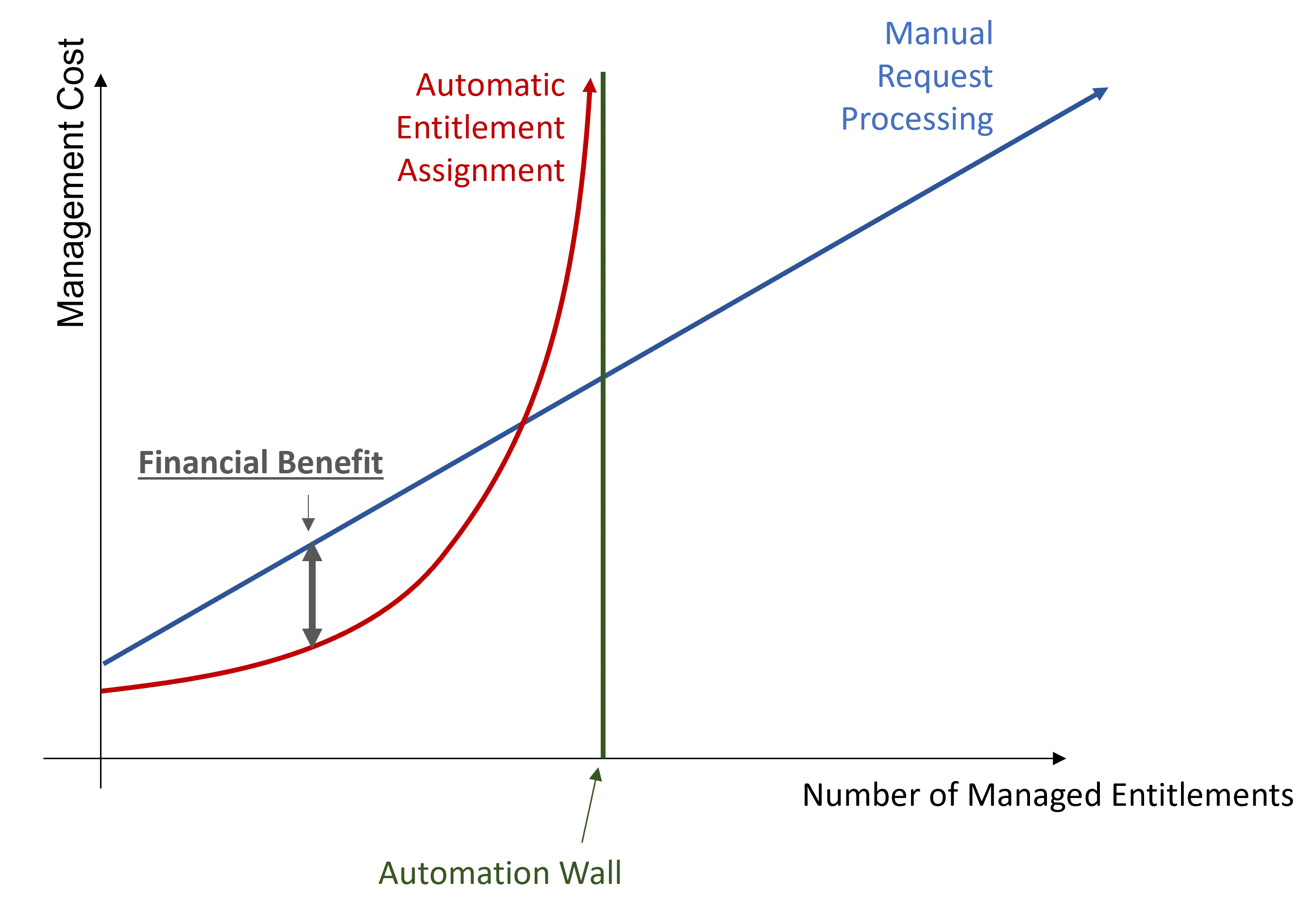

However, automation implies an increasing number of rules. And a high number of rules implies a certain complexity in rule model understanding, and consequently hiring expensive expert contractors to write the right rules. It drives up costs considerably and draws you near the automation wall.
Optimal Cost Chart - Automation Limits

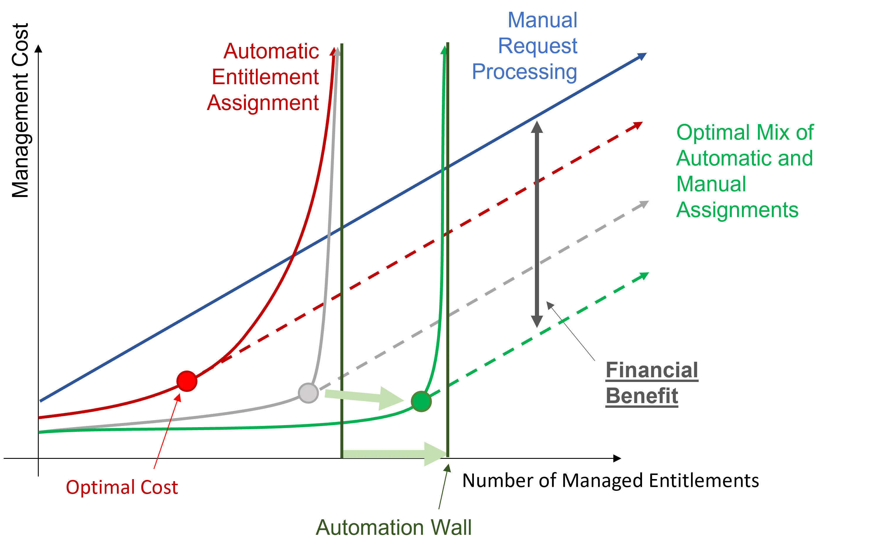

The automation wall represents the automation threshold that cannot be overcome. It mostly comes from the fact that with limited data, automation capabilities are also limited. Everything cannot be automated.
Automation strategy

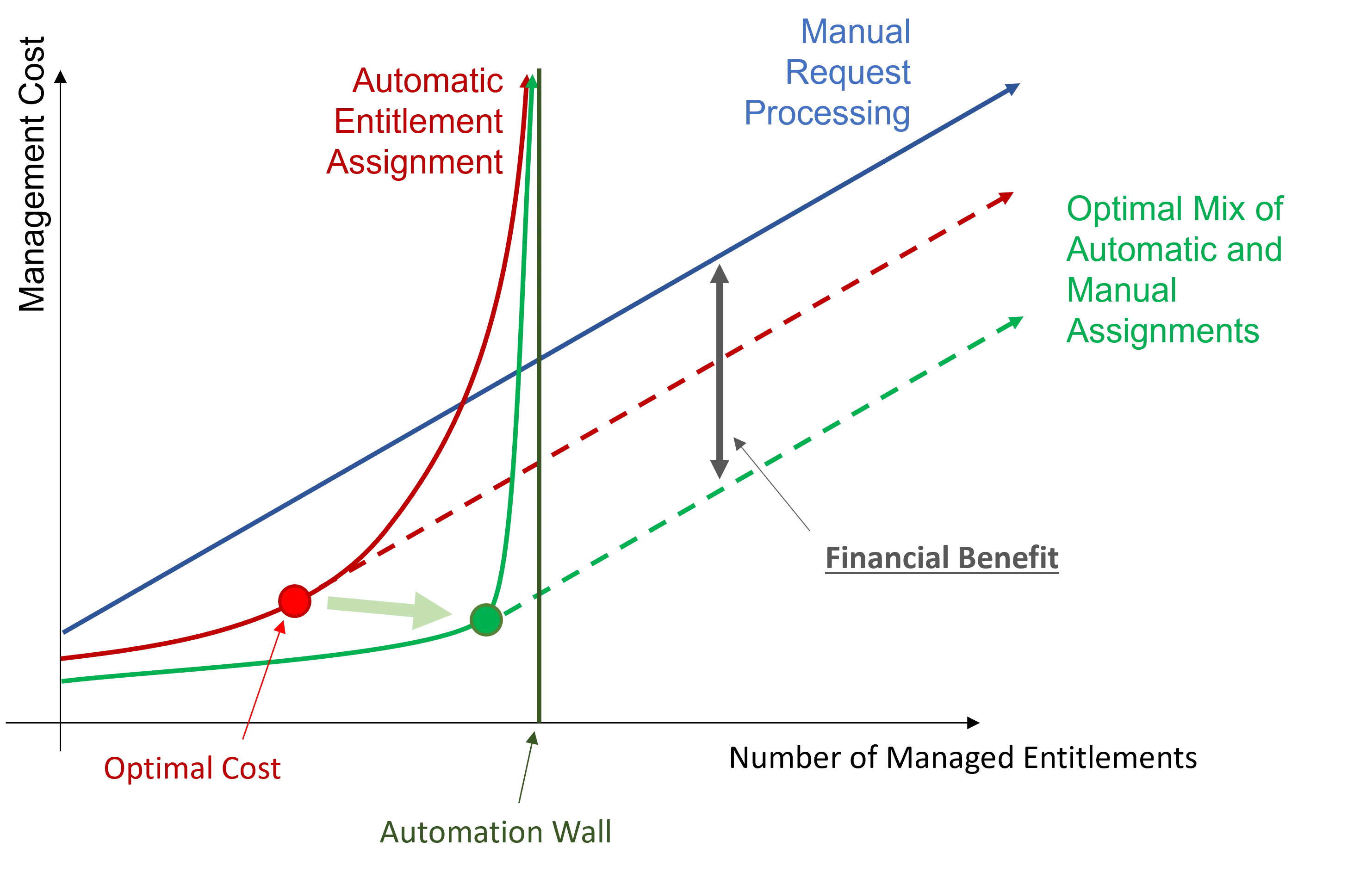

The idea is to stop automation when the automatic cost curve increases faster than the manual cost curve. The optimal profitability is represented on the chart and can be achieved via the optimal mix of automatic and manual assignments.
Optimal Cost Chart
Automation strategy consists in using Machine Learning through Role Mining to get closer to the automation wall. And, as Role Mining doesn't enable overcoming said wall, the goal is to move the wall further away by improving data quality and quantity.

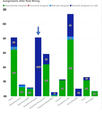

  2. Generate Reports and analyze them with tools like Power BI to assess the automation wall and identify improvement areas.
    For example in the following Power BI chart, automation is, on average, highly implemented except for SharePoint Projects. This fact reveals a low level of awareness among the workers about their respective projects. This is a typical area for improvement in data quality.
