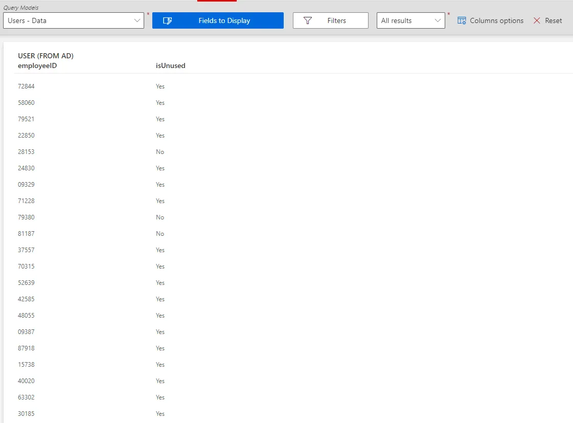

Once this "unused" property is created, a list of all unused accounts can be displayed thanks to the filters in the query module, based on said property. See the Generate Reports topic for additional information.
The previous example about the AD's isUnused property can be complemented in the query module by displaying this property alongside users' EmployeeId.
Query of Unused Accounts

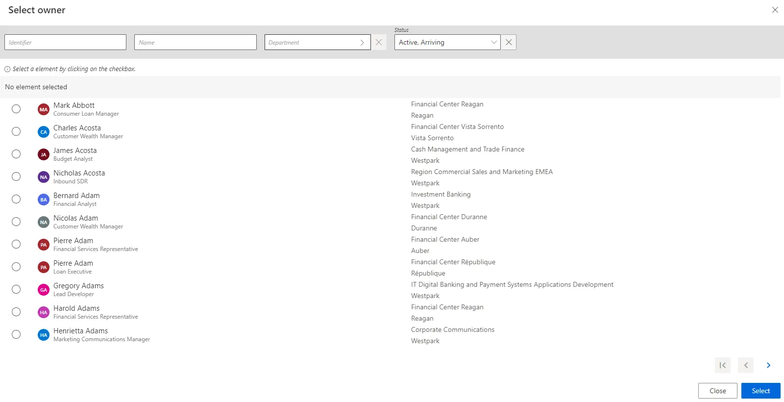

Step 4 – Click on the line of an account without an owner.
Select Owner
In the following example, the nominative AD account linked to the email address nathan.smith@acme.com has no owner.
You can Select owner from the list by clicking on the check box.
Owners List

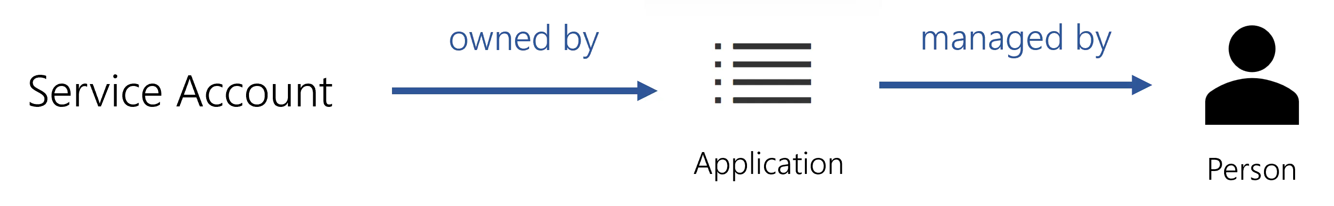

NOTE: We said that useful service accounts must be connected to their owners due to the fact that an orphaned account cannot be certified. .See the Perform Access Certification topic for additional information. But a service account must not be linked to a person, for the departure of said person from the company may trigger the loss of the service account.
This is why we create identities with Application as their UserType, each application-identity linked to a person supposed to manage it. Thus,service accounts must be connected to application identities, themselves owned by people. That way, if the owner of the application leaves, the application-identity is not deleted, and the service accounts it owns are not deprovisioned.
See the schema below this note.
Schema - Service Accounts
