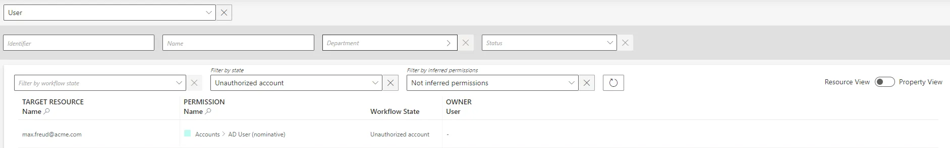

  3. Select Unauthorized account as the Workflow State. Orphaned accounts appear with no owner.
    Resource Reconciliation Page
  4. Choose the default resource view or the property view with the top right toggle.
  5. Click on the line of an account with an owner.

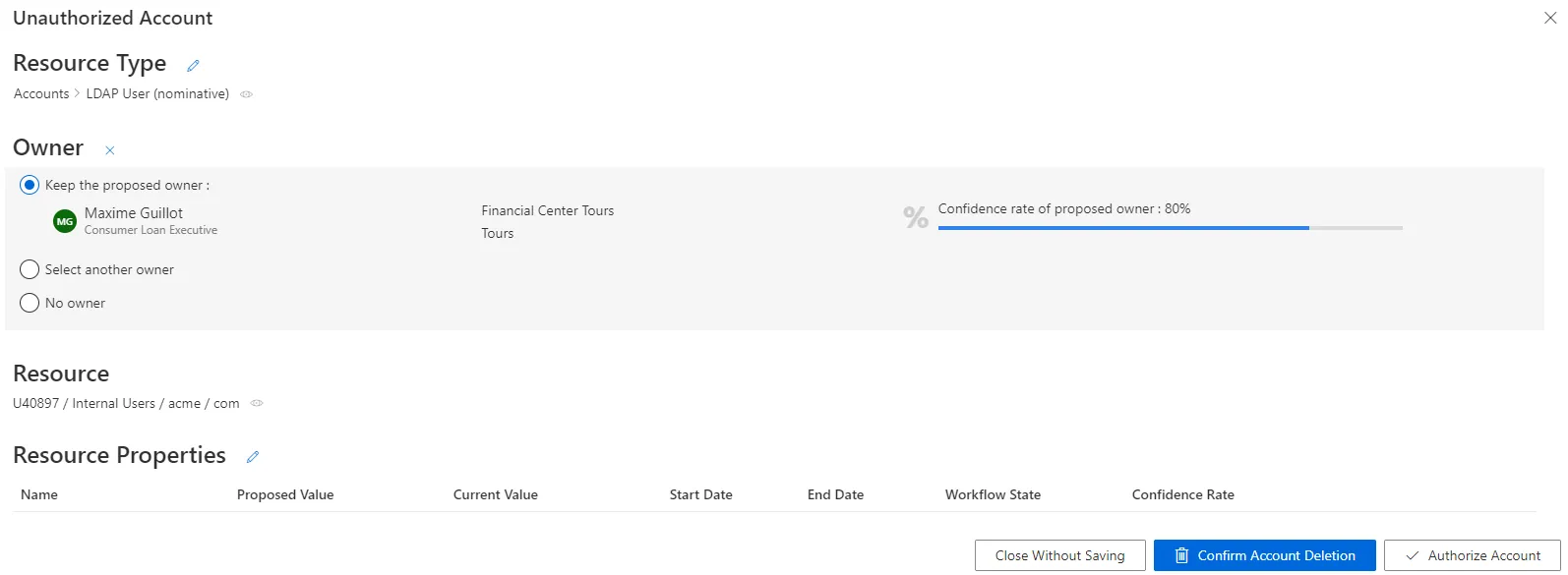

    In the following example, the nominative LDAP account linked to the resource U40897 / Internal Users / acme / com has the owner Maxime Guillot with an 80% confidence rate.
    Select Decision
    The displayed confidence rate means that a rule actually assigned the account to the identity, but with a confidence rate too low to imply full automatic assignment. Approval will be required. See the Classify Resources topic for additional information.
    The Resource Properties frame shows all the properties of the resources. They can be updated by clicking on the edit button. See the Reconcile a Property topic for additional information.
    Edit Button
  6. Select the appropriate decision.
    Decisions must be made with caution as they cannot be undone.
  7. Click on Confirm Account Deletion or Authorize Account according to the previous decision.

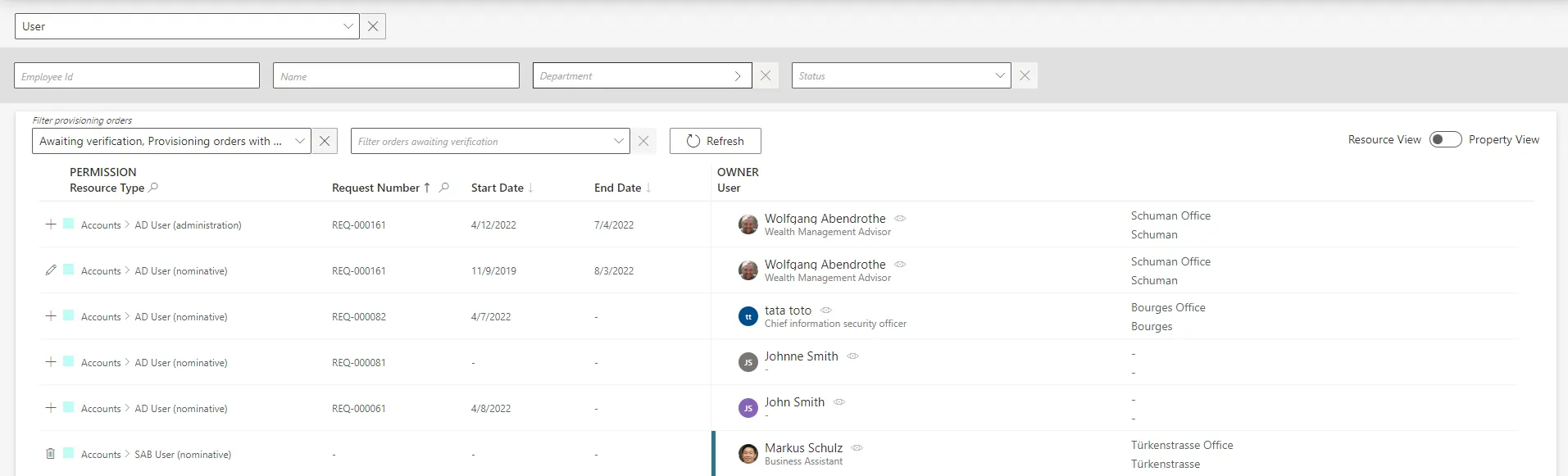

  8. Trigger the Provision by launching, on the appropriate connector's overview page, Jobs > Generate Provisioning Orders, then, after this first task is done, Jobs > Fulfill.

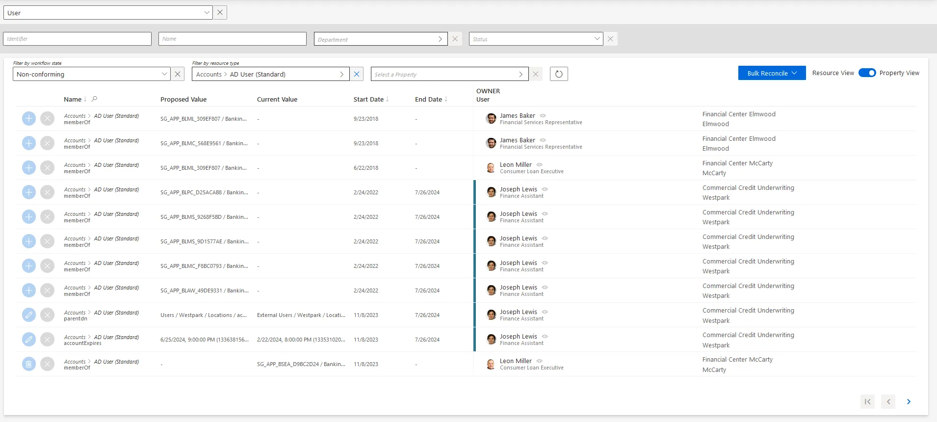

Use property view
By default, non-conforming assignments are listed by resource. It is possible to click on a resource and then access the list of all unreconciled properties for said resource.
Resource View
It can be helpful to have the non-conforming assignments regrouped by property, as some of the changes can be similar, so very likely to be validated by the same user. This is why a property view can be enabled by clicking on the Property View toggle at the top right corner.
Once enabled, select a resource type to display all unreconciled properties linked to said resource type. In addition, select a property to display only the unreconciled properties linked to said resource type and property.
Property View
The review process is the same with both views. However with property view, reviewers don't click on a given line, but choose a decision directly on the left of the property line.
In addition, using property view enables bulk reconciliation to approve the proposed values or keep the current values for several resources simultaneously.
Bulk Reconcile
Bulk keeping non-authorized accounts, by clicking on Bulk Reconcile then Approve Current Values, does not approve their unreconciled properties which will still be displayed on this screen.
