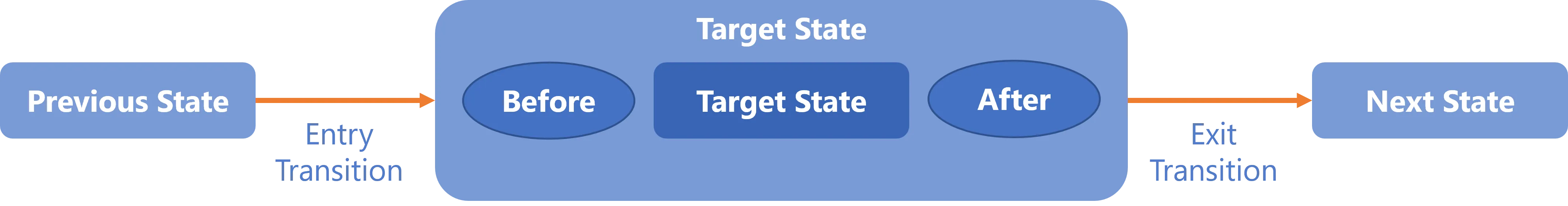

A pointcut is a mechanism telling Identity Manager when to execute the linked Aspects.
The position of the pointcut is specified by an activity state and a mode (before or after).
pointcut Schema
PropertyDetails
Activity requiredType Int64 Description Identifier of the activity whose specified state triggers the aspect.
ActivityState requiredType Enumeration Description Identifier of the activity state that triggers the aspect.
Mode default value: 0Type PointCutMode Description Mode defining when exactly the aspect is triggered around the specified workflow's activity state. 0 - Before: the aspect will be executed on entry to the specified activity state, regardless of the transition used. 1 - After: the aspect will be executed on exit from the specified activity state, regardless of the transition used.
