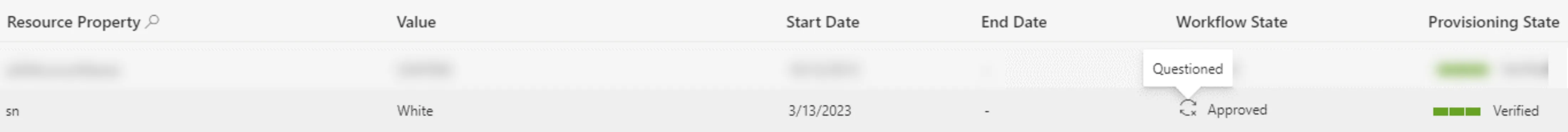

DiscardManualAssignments

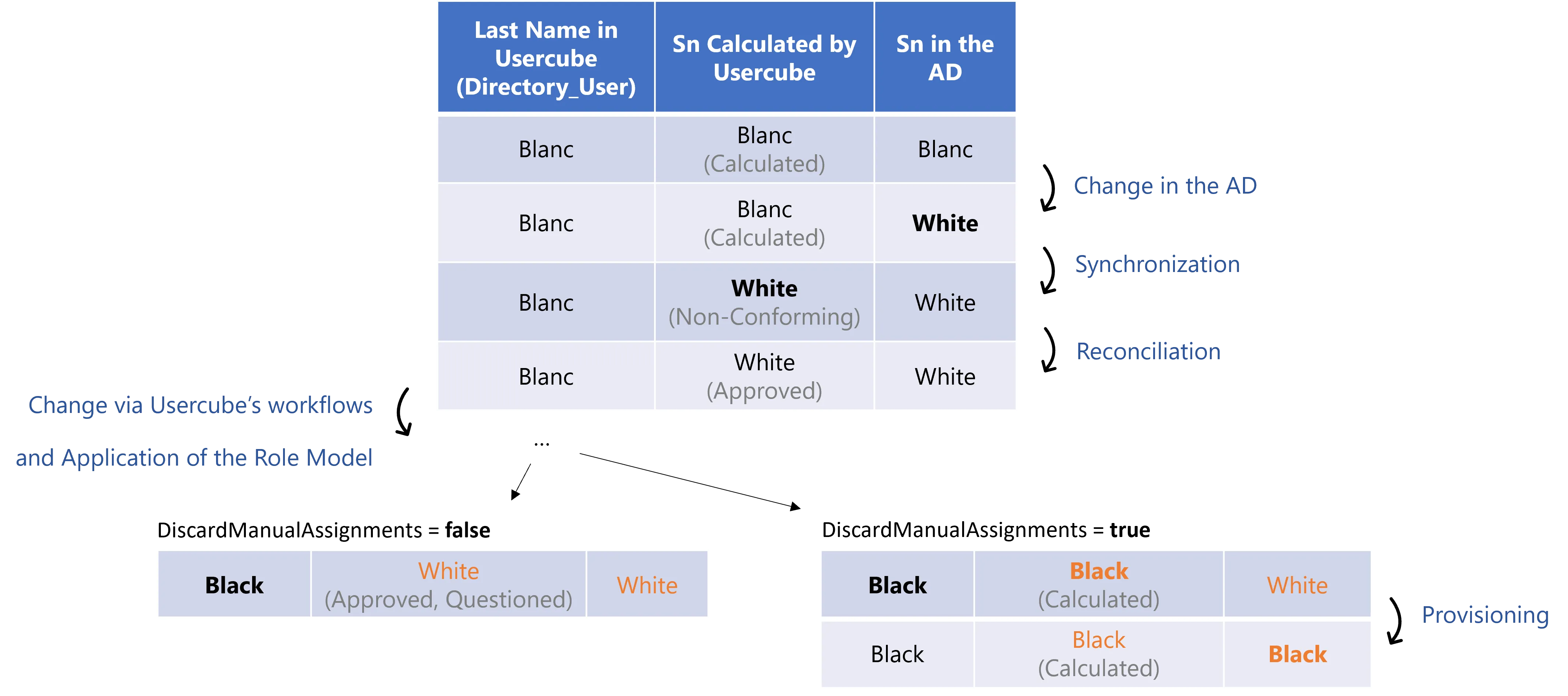

This option is used to set Identity Manager as authoritative following a manual change in a managed system.

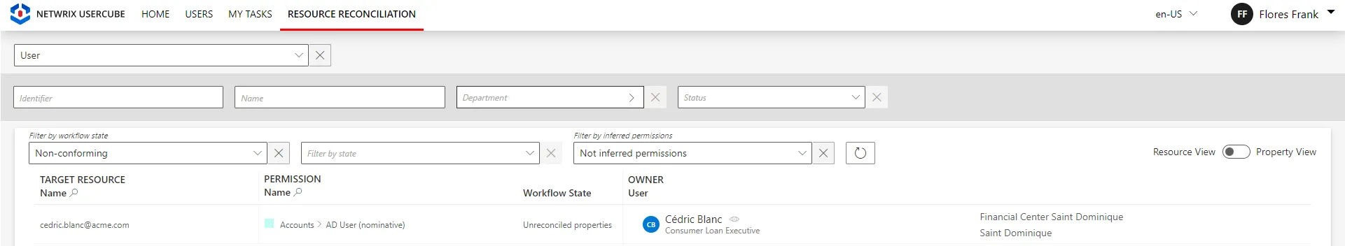

Suppose a resource type managing the provisioning of Active Directory nominative accounts based on users data in Identity Manager (Directory_User). Suppose a scalar rule that provisions the AD's sn property based on users' last names.

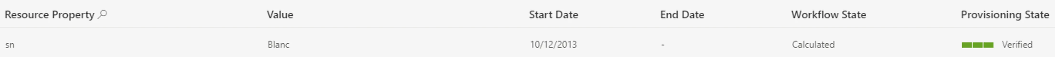

The following scenario is about a user named Cedric Blanc, whose AD's sn property is set by the scalar rule to Blanc.
Example - State 0

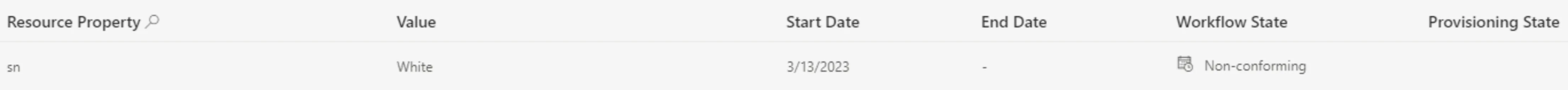

Let's see what happens when the user's name is changed manually directly in the AD.
Suppose that we change in the AD the last name to White. As the scalar rule computes the sn value based on the user's data which still states the last name Blanc, such a change induces a difference between the value calculated by the rule and the actual value in the AD. This difference is spotted by the next synchronization, triggering a non-conforming assignment on the Resource Reconciliation page.

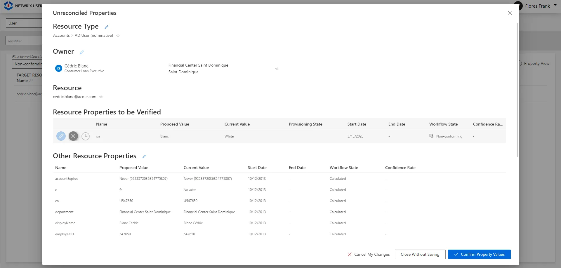

Example - State 1
Example - Step 1
Example - Step 2

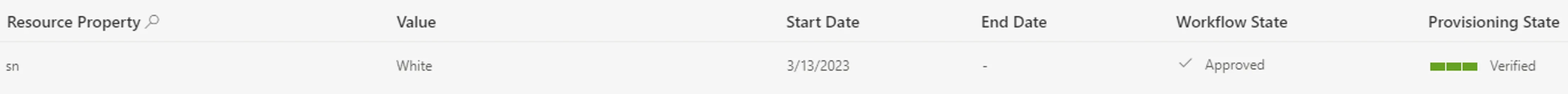

Once this manual new value is confirmed, the property is stated as Approved.
Example - State 2

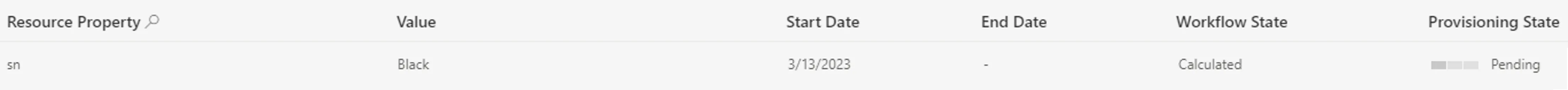

Now suppose that the user's last name is changed to Black via Identity Manager's workflows. As the source data is changed, the scalar rule computes a new value for sn. There are two options:
  • The default configuration (DiscardManualAssignments set to false) considers manual assignments, i.e. changes made directly in the managed system, as authoritative. So there will be no provisioning of the newly computed value for sn. The current sn value that was written manually in the AD stays as is, no matter the changes in the source data (here the user's last name). Identity Manager only states the property's value as Questioned.
    Example - State 3
    NOTE: No change in the source data can affect the property's value. However, any manual change made in the managed system will trigger a non-conforming assignment. Then, reconciling the property by choosing to keep Identity Manager's suggested value will make the property's value go back to Calculated and thus follow the changes in the source data.
    NOTE: If DiscardManualAssignments is changed from False to True, then the state of the property's value does not matter. Identity Manager applies the rules of the role model, and generates a provisioning order to overwrite the manual change White with the newly computed value Black.
    Example - State 4
In this scenario for Cedric Blanc, these behaviors can be summed up like the following:

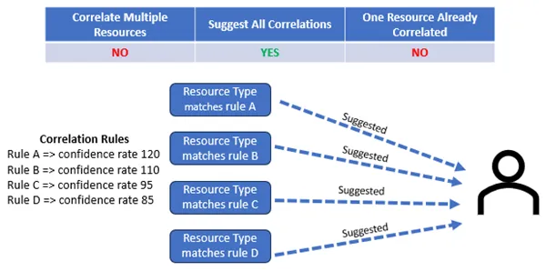

Correlate Multiple Resources

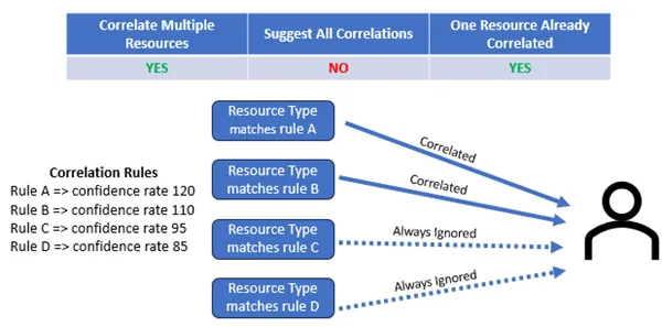

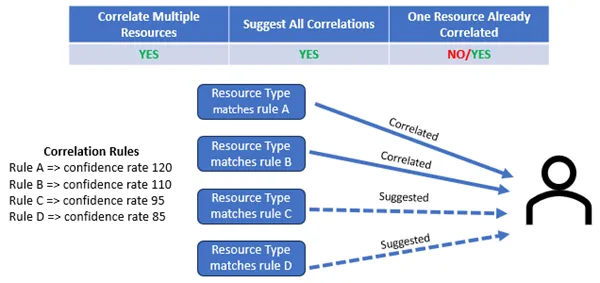

With the Correlation Multiple Resources option, Identity Manager can link a single owner to several existing target objects of the same resource type. This setting can be used in conjunction with the Suggest all resources option to fine tune the behavior.
Below, we illustrate the different scenarios that are possible, taking into consideration whether a resource type has previously been correlated to the owner or not.

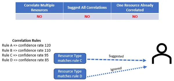

suggestallcorrelations-nnn
  • The value for both Correlate Multiple Resources and Suggest All Correlations is No there is no Resource already correlated so the first match with the highest confidence rate is Correlated if it is > 100 or Suggested if it is < 100. As for all other matches with lower confidence rate they will be ignored.

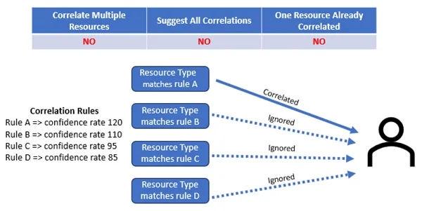

    suggestallcorrelations-nnn2
    If there are no Resources to be correlated with a confidence rate >100, the ones below with confidence rate below 100 are Suggested or Ignored.

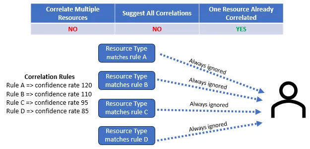

    suggestallcorrelations-nny
  • The value for both Correlate Multiple Resources and Suggest All Correlations is No there is one Resource already correlated so due to this all future correlations will be ignored.
    suggestallcorrelations-nyn
  • The value for Correlate Multiple Resources is No, Suggest All Correlations is Yes there is no Resource already correlated so all Resource Types will be Suggested.
    suggestallcorrelations-nyy
  • The value for Correlate Multiple Resources is No, Suggest All Correlations Yes there is one Resource already correlated so the Resource Types that have a confidence rate >100 will be Suggested. As for all other matches with lower confidence rate they will be ignored.

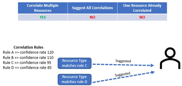

    suggestallcorrelations-ynn
  • The value for Correlate Multiple Resources is Yes, Suggest All Correlations No, and there is no Resource already correlated so Resource Types that have a confidence rate >100 will be Correlated and the ones <100 will be Suggested if there are no higher matches otherwise they will be ignored.
    suggestallcorrelations-ynn2
    If there are no Resources to be correlated with a confidence rate >100, the ones with confidence rate below 100 are Suggested.
    suggestallcorrelations-yny
  • The value for Correlate Multiple Resources is Yes, Suggest All Correlations No there is one Resource already correlated so the matches with confidence rate >100 will be Correlated and the ones <100 will be ignored.
    suggestallcorrelations-yyny
  • The value for Correlate Multiple Resources is Yes, Suggest All Correlations Yes one Resource could be already correlated or not so the matches with confidence rate >100 will be Correlated and the ones <100 will be Suggested.

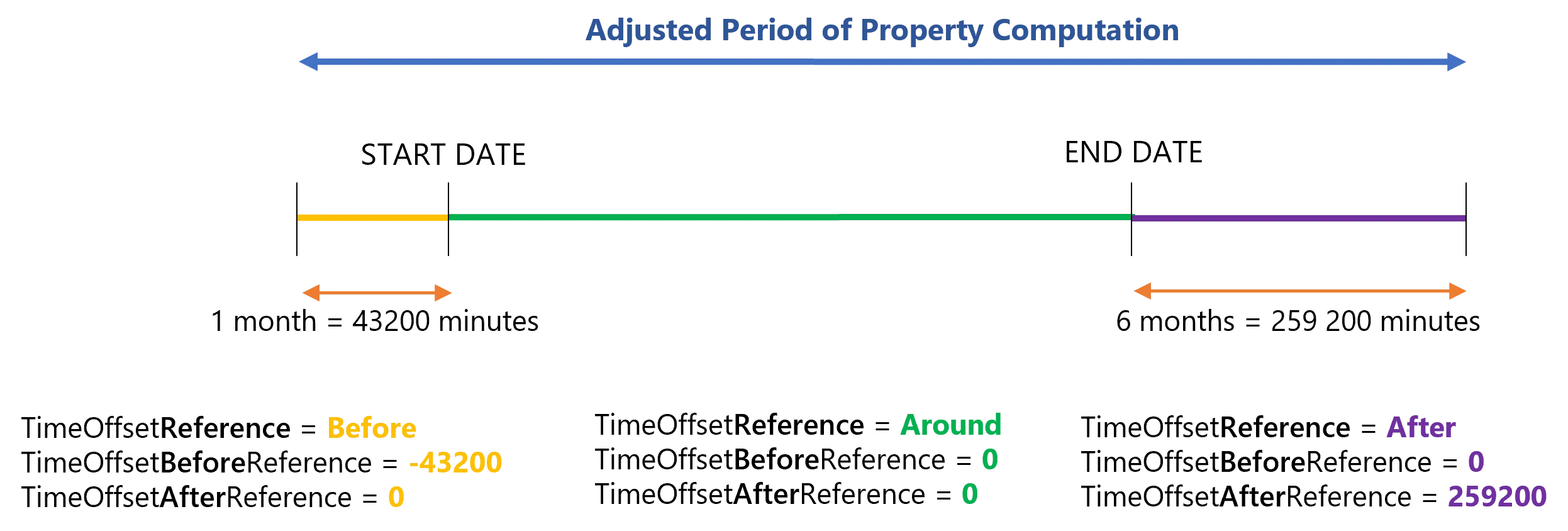

ManualAssignmentEndDateLockedToContextMode default value: ExplicitNotContextBoundByDefaultManualAssignmentEndDateLockedToContextModeThe values are: 0 - ExplicitNotContextBoundByDefault — By default, the assignment's end date will not be context bound in order to encourage the manual entry of an end date 1 - ExplicitContextBoundByDefault — By default, the assignment's end date will be context bound and therefore locked, but a manual date can be entered. 2 - Never — The assignment's end date will never be locked and needs to be specified manually 3 - Always — The assignment's end date is always locked according to the applicable context rule.

TimeOffset
A scalar rule is applied according to reference start and end dates (configured through record sections and context rules), usually users' arrival and departure days. It means that, for a user matching the rule's criteria, a property is to be computed, by default, from the user's arrival day until their departure day. See the Record Section and Context Rule topics for additional information.
Schema - Default Application Period
A time offset adjusts the period for which the rule applies and computes a property's value.
The following example impacts the property for the activation of nominative AD accounts:
  • The first rule deactivates the account from its creation, i.e. 1 month before the user's arrival day, until the arrival day;
  • The second rule activates the account from the user's arrival day until their departure;
  • The third rule deactivates the account from the user's departure day and until its deletion, i.e. 6 months after the departure day.
Code attributes enclosed with <> need to be replaced with a custom value before entering the script in the command line.
<ResourceType Identifier="AD_Entry_NominativeUser" Policy="Default" TargetEntityType="AD_Entry" Category="Accounts" SourceEntityType="Directory_User" ApprovalWorkflowType="None">    <ScalarRule Property="accountEnabled" Expression="C#:person:return &quot;false&quot;;" TimeOffsetReference="Before" TimeOffsetBeforeReference="-43200" TimeOffsetAfterReference="0" />    <ScalarRule Property="accountEnabled" Expression="C#:person:return person.Leave.GetValueOrDefault() ? &quot;false&quot; : &quot;true&quot;;" TimeOffsetReference="Around" TimeOffsetBeforeReference="0" TimeOffsetAfterReference="0" />    <ScalarRule Property="accountEnabled" Expression="C#:person:return &quot;false&quot;;" TimeOffsetReference="After" TimeOffsetBeforeReference="0" TimeOffsetAfterReference="259200" />    ...
</ResourceType>
Schema - Offset Application Period
If the time period of property computation exceeds the limits of the period of resource type assignment, then the period of resource type assignment is extended accordingly.
Note that the rules are applied in a specific order according to their offset reference: After, Before, Around and Default. Each rule overwrites pre-existing values. Thus in case of overlapping rules, Default-offset rules overwrite the values of Around-offset rules, which overwrite the values of Before-offset rules, which overwrite the values of After-offset rules. We could have the following:
Schema - Overlapping Offsets
