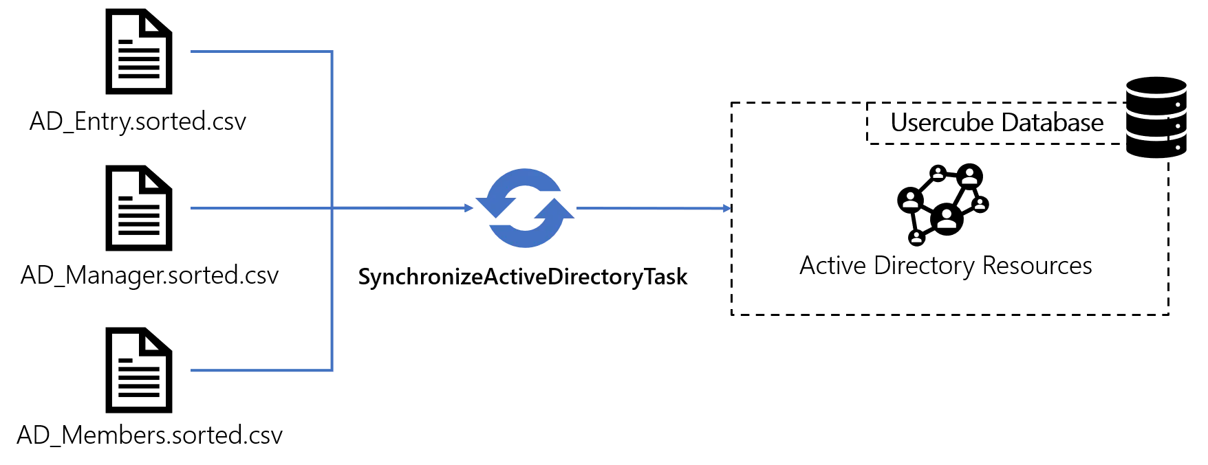

The following example demonstrates the native Active Directory export process.
Exporting data from an Active Directory can be achieved by using the Export Task task within a Job.
The Tasks requests from the source Active Directory all entries that match a configured filter. It outputs a set of CSV source files, containing raw AD Entries data (ad_entries.csv), information about group membership (ad_members.csv) and about the hierarchical organization (ad_managers.csv).
Active Directory Export Example

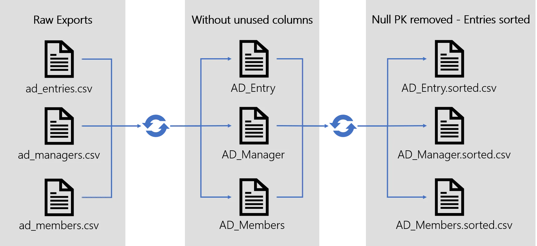

Example
The following illustration models the complete prepare-synchronization steps applied to an Active Directory export. The matching Connector defines an Entity Type AD Entry and two associations: members and manager.
Active Directory Prepare-Synchronization Example

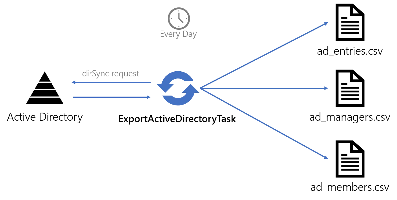

Example
This example illustrates the complete loading of Active Directory .sorted files into Identity Manager database.
Active Directory Synchronization Example
