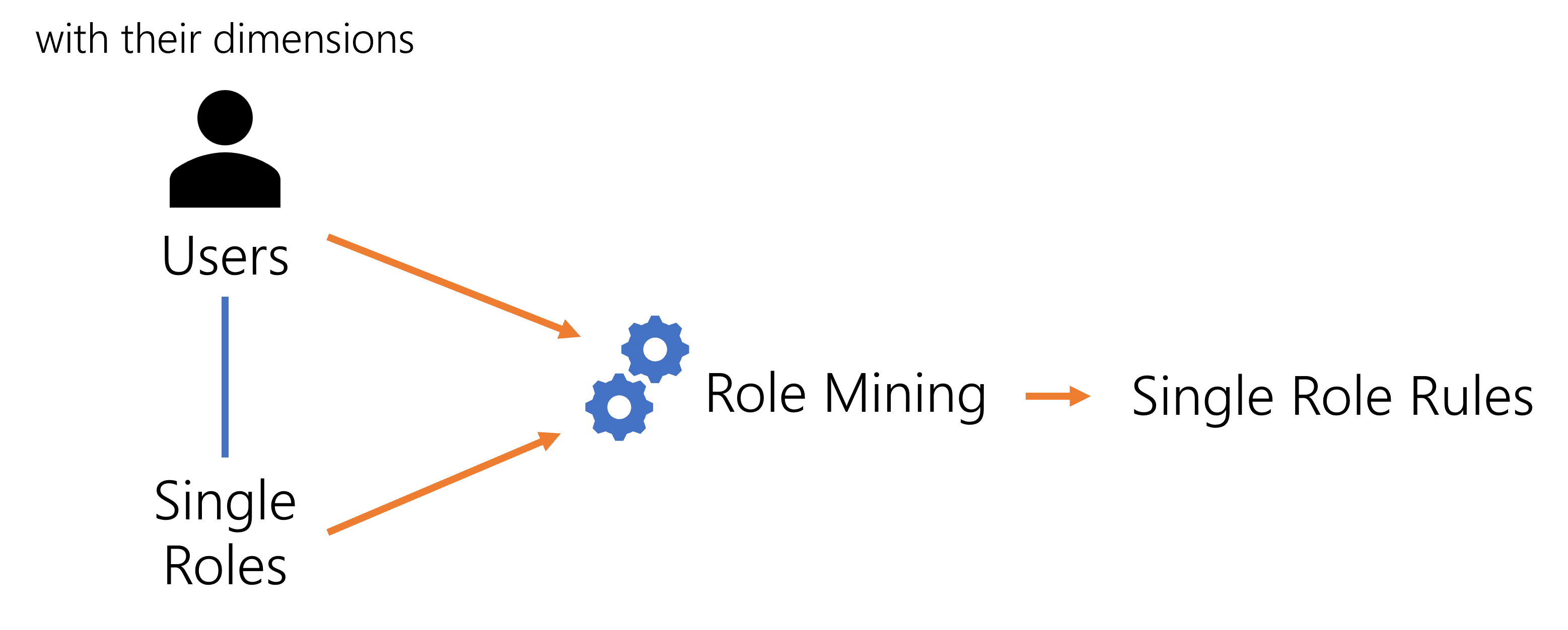

Schema - Role Mining
Role mining is a Machine Learning process. It is a statistic tool used to emphasize the dimensions that constitute the key criteria for existing role assignments. See the Conforming Assignments topic for additional information. It detects the most probable links between identities dimensions and their roles in order to suggest the appropriate entitlement assignment rules.

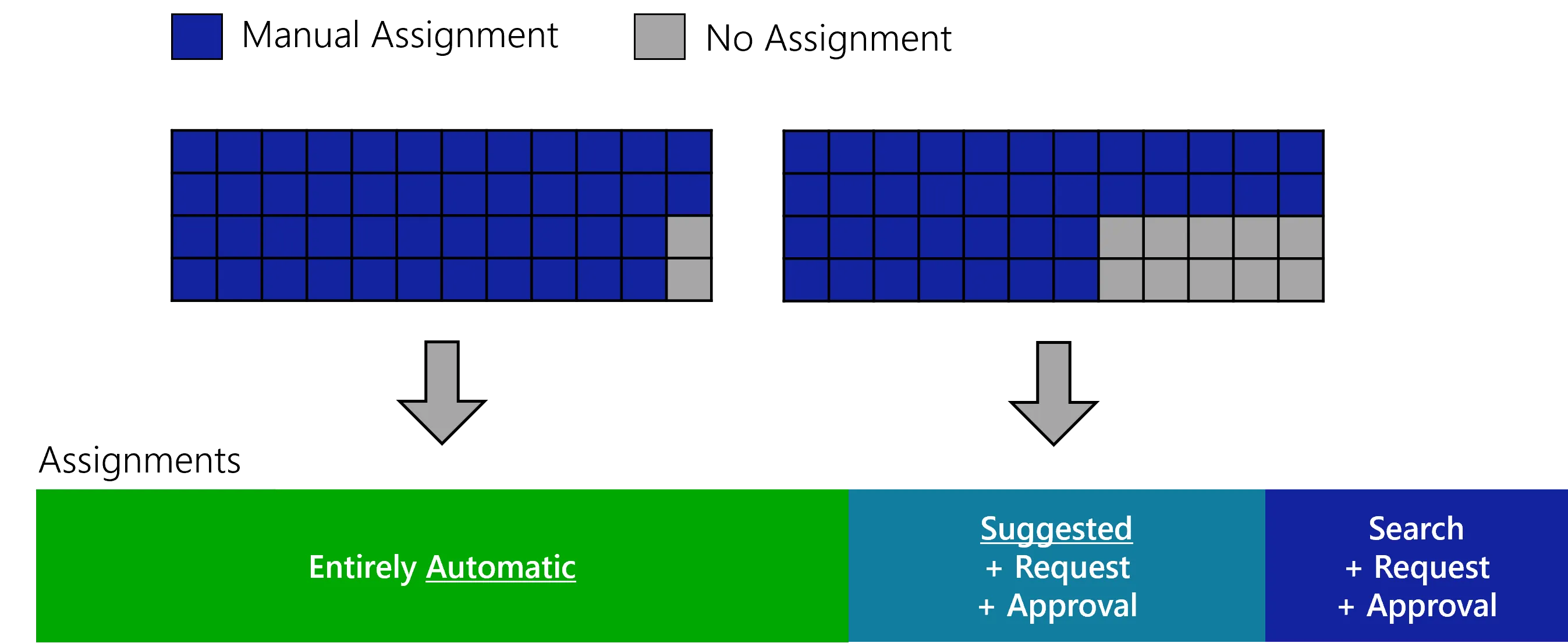

Mining rules can be configured to generate:
  1. automatic rules, i.e. rules which assign roles automatically with or without a validation;

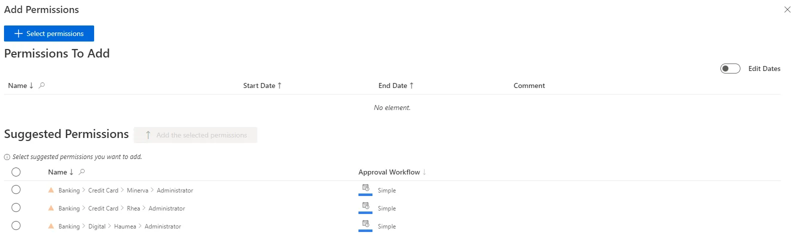

  2. suggested rules, i.e. rules which don't assign roles directly, but suggest them during an entitlement request for a user.
    Suggested
You can generate both automatic and suggested rules for the same role, with different precision levels and different approval workflows.
Consider an organization where an unknown ratio of users have a given role. Using the precision settings, we can create a mining rule to generate automatic assignment rules when the ratio is above 95% and a second mining rule to generate suggested assignment rules when the ratio is between 75% and 95%.

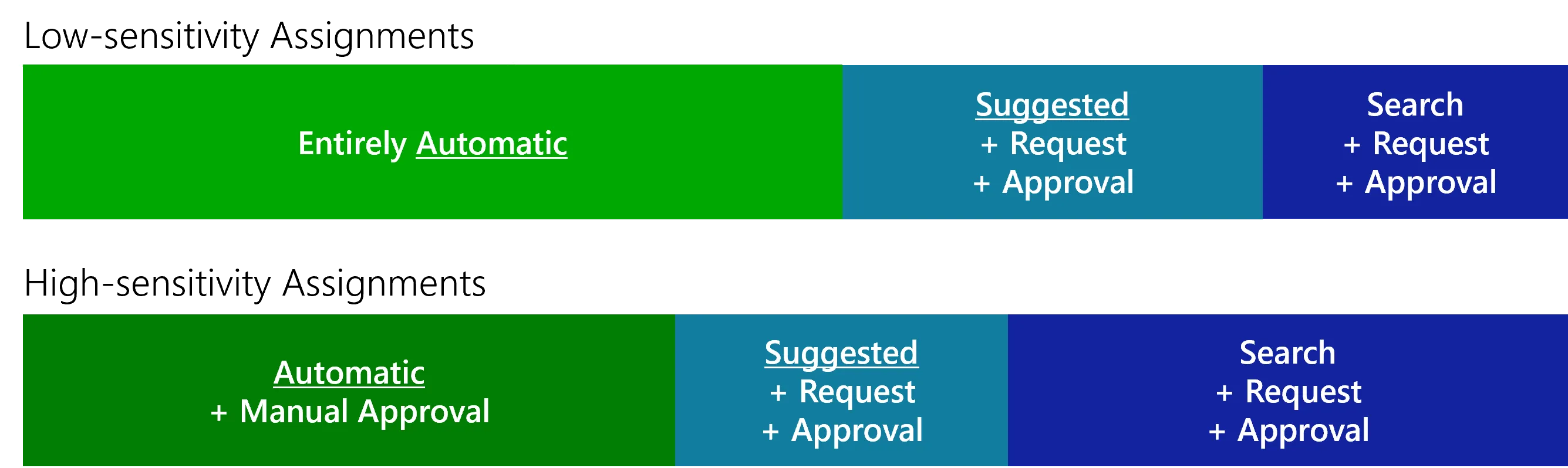

Rule Types
You can also differentiate entitlements according to their sensitivity, for example require additional reviews following the request of a sensitive entitlement:
Rule Types - Sensitivity
The automation of entitlement assignments according to sensitivity brings greater confidence in basic entitlements assignment which won't need to be certified anymore. Thus, automation lets certification campaigns focus on more sensitive entitlements.

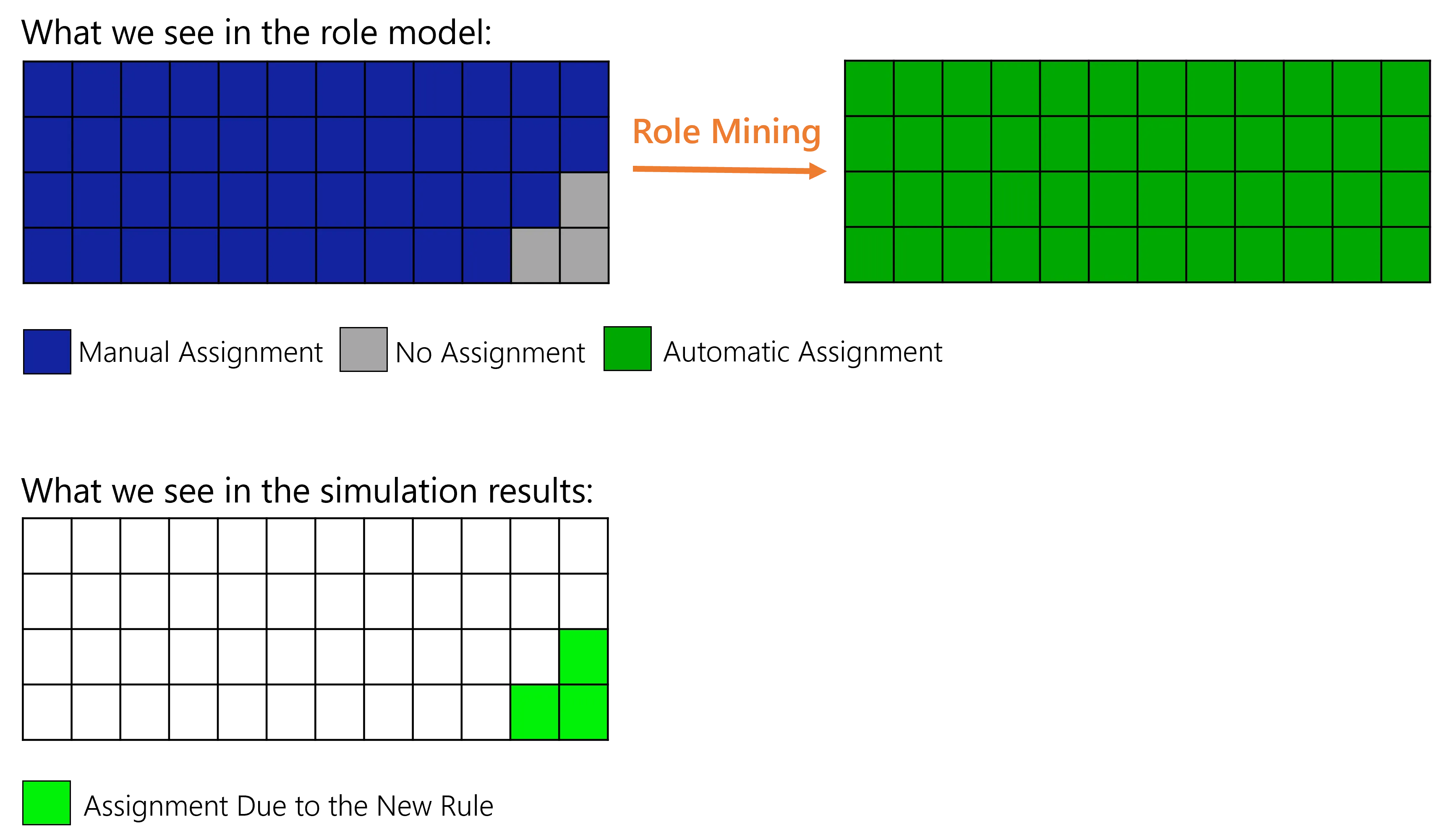

Impact on users' entitlements
Consider that all users from a given organization have a given role. Then role mining will create a single role rule to assign automatically this role to any user of this organization. Then users' entitlements remain unchanged:
Impact Example - Use Case 1

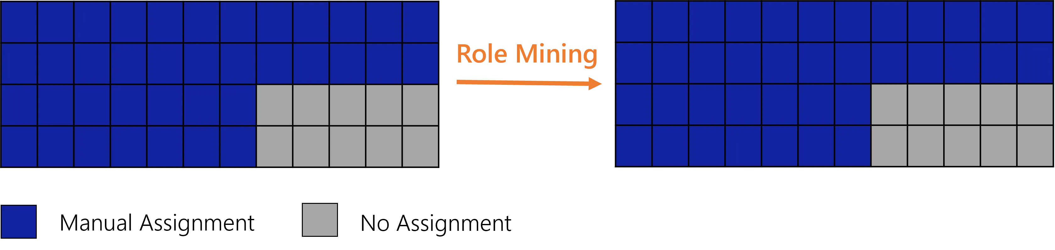

Now consider that half of users in the organization have the role. Then role mining will not generate a role assignment rule. Then users' entitlements remain unchanged:
Impact Example - Use Case 2

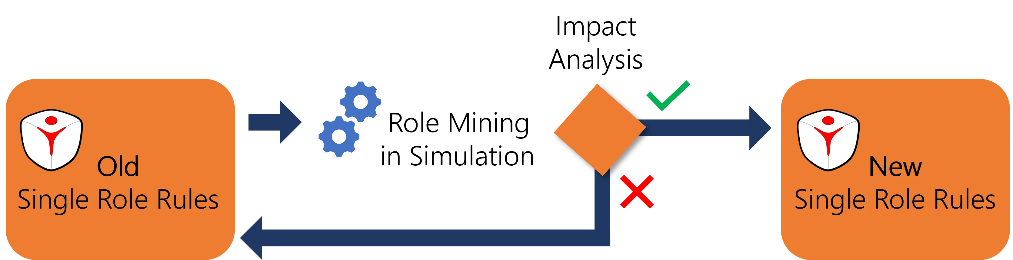

Simulation
Be aware that you can configure the Get Role Mining Task to generate role assignment rules either directly or in a Simulation.
Simulating the results of role mining allows a knowledgeable user to analyze the impact of role mining on the role model, before applying them.
The simulation tool gives another point of view on the role model as it emphasizes the changes.
Identity Manager recommends simulating role mining before applying the results.
