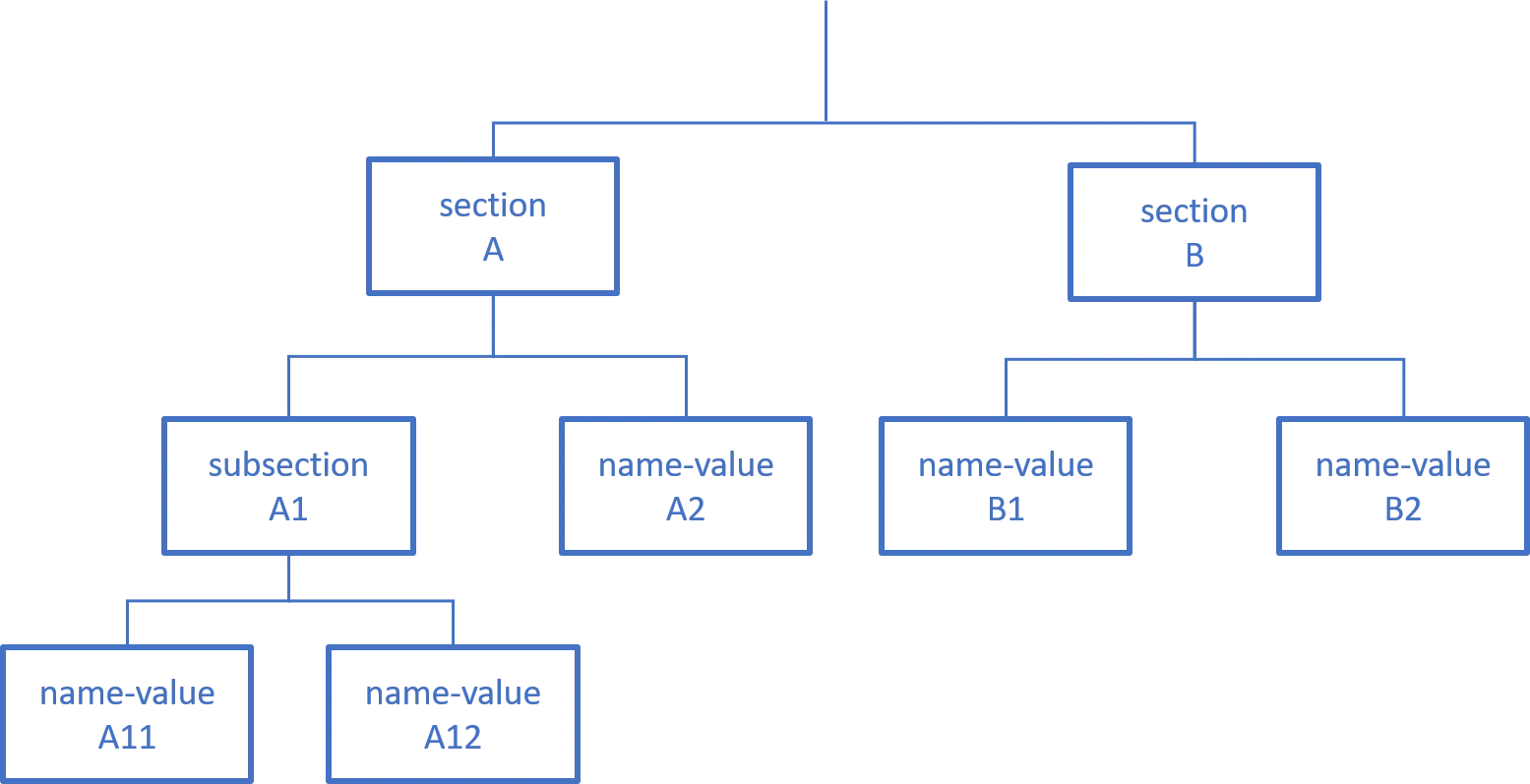

Each set can be seen as a tree-like structure where leaves are a name-value pair: the name of the setting and the value of the setting.
Within a Configuration Set Tree, settings are organized into meaningful sections which can be further organized into subsections, leading to a tree-like structure where sections are nodes. For example, settings involving end-user authentication are gathered in the Authentication section, containing another subsection for every authentication method such as OpenId or OAuth.
This means that every setting value either belongs to the settings root node or to a section, itself belonging to a parent section.
tree like structure
