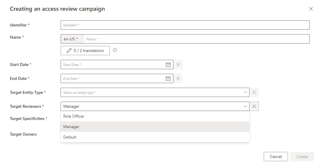

Assigning an access certification campaign policy to an access certification campaign allows the creation of campaigns dedicated specifically to one set of reviewers.
The following example creates a new policy named Manager.
Code attributes enclosed with <> need to be replaced with a custom value before entering the script in the command line.
<AccessCertificationCampaignPolicy Id="-2" Identifier="Manager" DisplayName_L1="Manager" DisplayName_L2="Responsable"/>
It automatically appears on the campaign creation screen, and binds itself to the created campaign:
Campaign creation screen with policies
To use it, modify the access control rules by adding a filter on the campaign policy. See the Access Control Rule topic for additional information.
