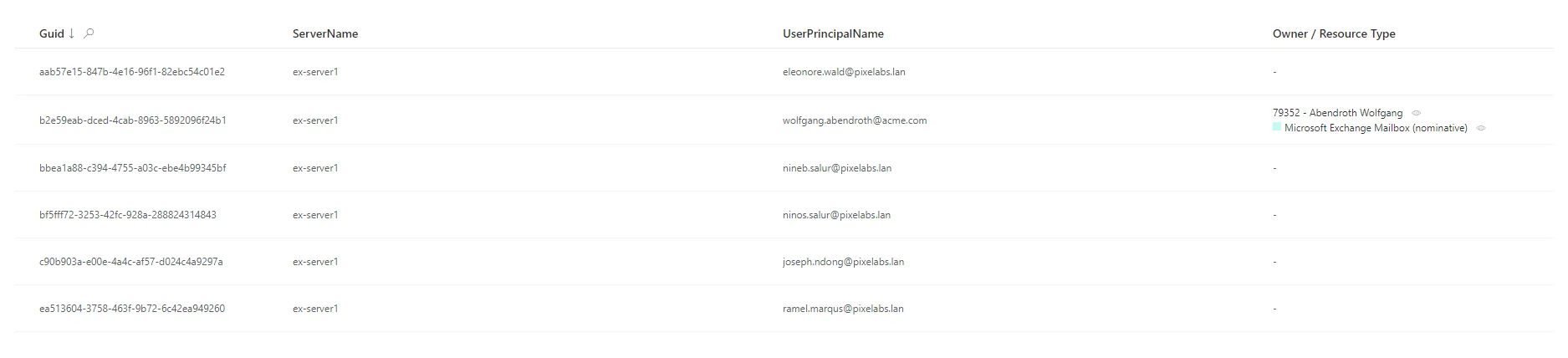

Display
This step focuses on configuring a nice display for the synchronized list of resources in the UI.
A Menu Item can be added to include a link to the resources list in the left menu on the UI home screen.
It is strongly recommended that you gather synchronized resources menu items under parent menu items. This is usually declared in the Nav.xml file in the configuration root folder.
NETWRIX also advises to use a new MicrosoftExchange Nav.xml file in the MicrosoftExchange connector's folder to add a mailboxes and databases menu item.
Example
Conf/MicrosoftExchange/MicrosoftExchange Nav.xml
<MenuItem Identifier="Nav_Connectors_MicrosoftExchange" DisplayName_L1="Microsoft Exchange" DisplayName_L2="Microsoft Exchange" ParentMenuItem="Nav_Connectors"> <MenuItem Identifier="Nav_Connectors_ADMicrosoftExchange_Entry" DisplayName_L1="AD Entries" DisplayName_L2="Entr�es AD" EntityType="ADMicrosoftExchange_Entry" /> <MenuItem Identifier="Nav_Connectors_MicrosoftExchange_Database" DisplayName_L1="Databases" DisplayName_L2="Bases de donn�es" EntityType="MicrosoftExchange_Database" /> <MenuItem Identifier="Nav_Connectors_MicrosoftExchange_Mailbox" DisplayName_L1="Mailboxes" DisplayName_L2="Boites mails" EntityType="MicrosoftExchange_Mailbox" /></MenuItem>...
This example adds a new menu item under the Nav_Connectors menu item declared in the root Conf/Nav.xml file. This new menu item gives access to the list of synchronized Microsoft Exchange entities.
Microsoft Exchange Menu Items
Configuration
It is strongly recommended that the display configuration be written to a new MicrosoftExchange UI.xml file in the MicrosoftExchange connector's folder.

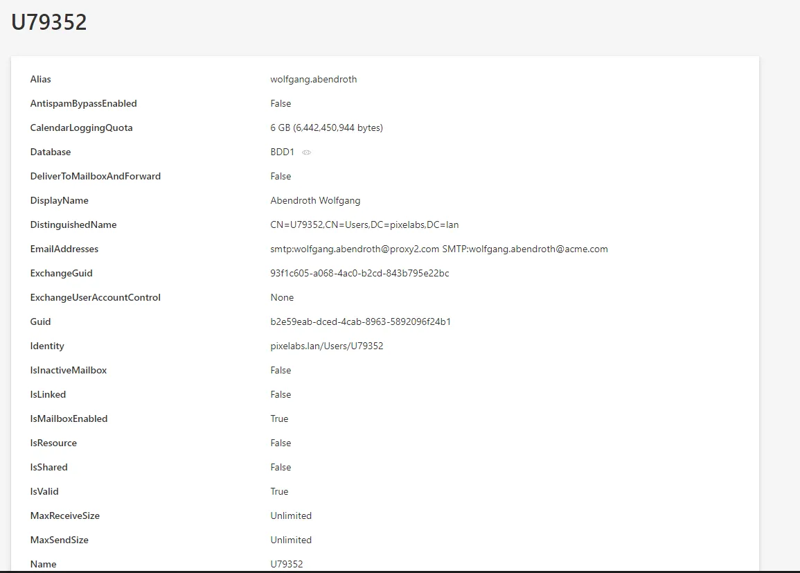

Display Entity Type
The Display Entity Type describes how a single resource should be displayed.
Example
Conf/MicrosoftExchange/MicrosoftExchange UI.xml
<DisplayEntityType Identifier="MicrosoftExchange_Database"> <Property OutputType="BasicCollection" Identifier="Mailboxes" /></DisplayEntityType>...
This example configures the following display for wolfgang.abendroth@acme.com.
Microsoft Exchange Display Entity Type

Display Table
The Display Table elements describe how a list of resources should be displayed.
The Display Table contains a list of Display Table columns elements that identify which properties should be included in the list display.
Example
<DisplayTable Identifier="MicrosoftExchange_Database" EntityType="MicrosoftExchange_Database" DisplayTableDesignElement="table" IsEntityTypeDefault="true"> <Column DefaultSortPriority="1" DisplayBinding="Guid" IsDisplayInSummaryView="true" IsResizable="true" IsSortable="true" CanBeFiltered="true" ColumnSize="1" /> <Column DisplayBinding="Name" IsDisplayInSummaryView="true" IsResizable="true" IsSortable="true" CanBeFiltered="true" ColumnSize="2" /> <Column DisplayBinding="Server" IsDisplayInSummaryView="true" IsResizable="true" IsSortable="true" CanBeFiltered="true" ColumnSize="2" /></DisplayTable><DisplayTable Identifier="MicrosoftExchange_Mailbox" EntityType="MicrosoftExchange_Mailbox" DisplayTableDesignElement="resourcetable" IsEntityTypeDefault="true"> <Column DefaultSortPriority="1" DisplayBinding="Guid" IsDisplayInSummaryView="true" IsResizable="true" IsSortable="true" CanBeFiltered="true" ColumnSize="1" /> <Column DisplayBinding="ServerName" IsDisplayInSummaryView="true" IsResizable="true" IsSortable="true" CanBeFiltered="true" ColumnSize="2" /> <Column DisplayBinding="UserPrincipalName" IsDisplayInSummaryView="true" IsResizable="true" IsSortable="true" CanBeFiltered="true" ColumnSize="2" /></DisplayTable>...
This example configures the following list display:
Microsoft Exchange Display Table

After execution, Microsoft Exchange resources and databases should be in the UR_Resources table of the SQL Server database.
The results can also be viewed on the UI:
