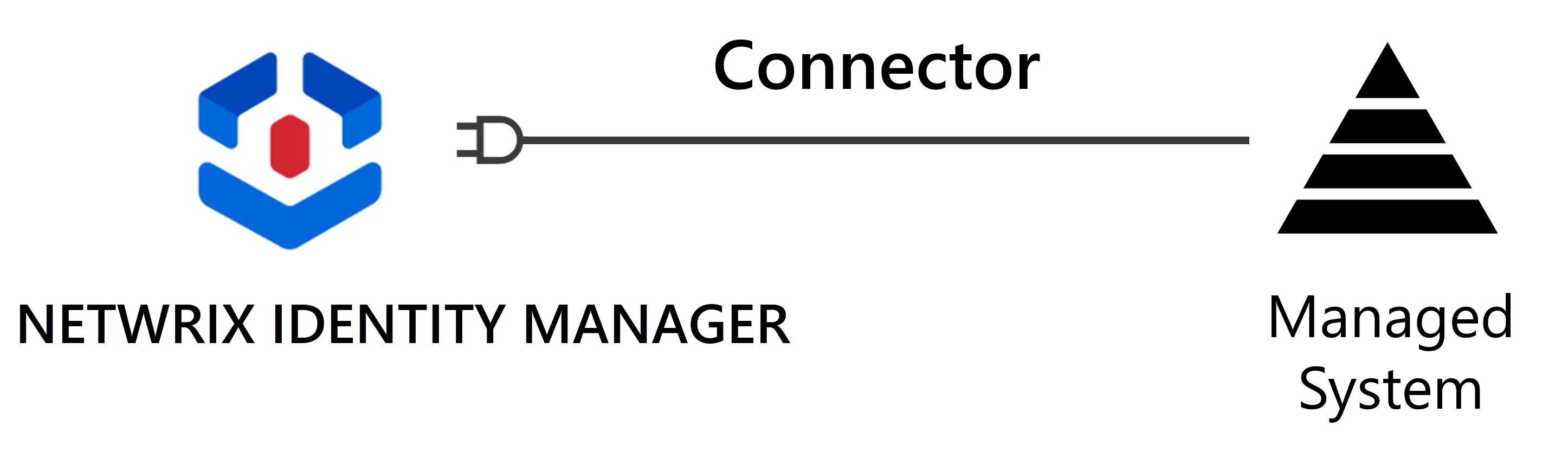

Connectors are the mechanisms that enable Identity Manager to read and write data to/from your organization's systems. The feedback mechanism ensures Identity Manager's reliability.
In this documentation, we talk about managed systems (sometimes called external systems) to refer to third-party applications, i.e. the applications used in your organization, such as Active Directory, ServiceNow, EasyVista, SAP, SharePoint, etc.
A connector, therefore, acts as an interface between Identity Manager and a managed system.
Connector Schema
Netwrix Identity Manager (formerly Usercube)strongly recommends the creation of one connector for each application.
For example, integrators may create an AD connector with the goal of importing an Active Directory's data into Identity Manager, and writing to the Active Directory from Identity Manager, either manually for administration accounts, or automatically for basic accounts.
Integrators may create a SharePoint connector in order to manage read and write entitlements for users in SharePoint.

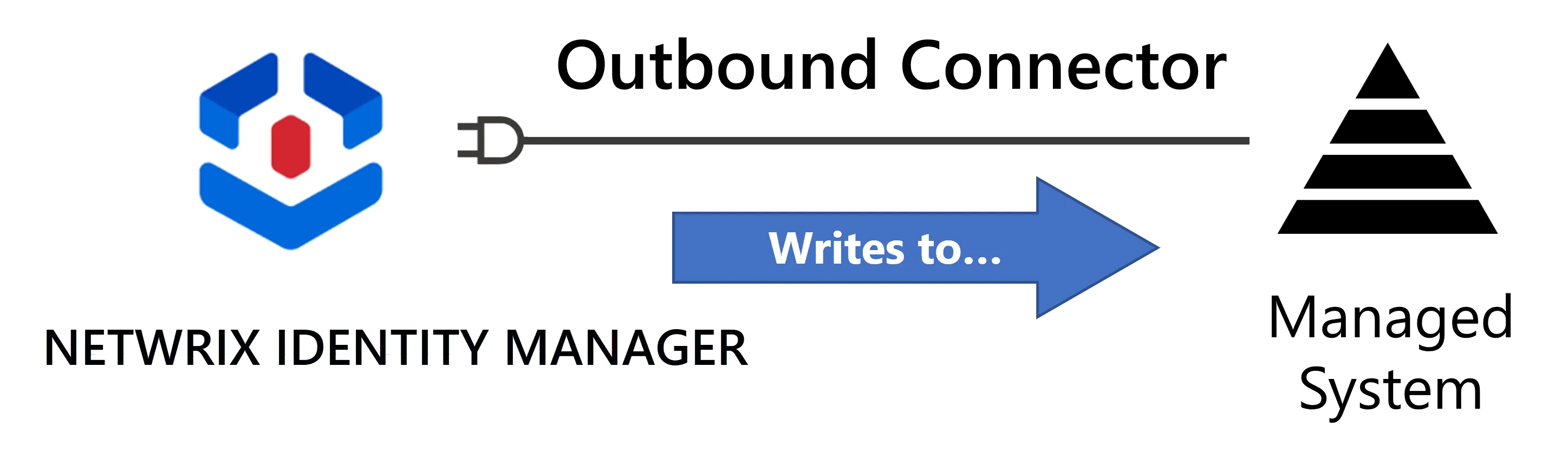

In the early steps of a project, we'll consider most of our connectors to be outbound, i.e. Identity Manager will feed data into connected managed systems.
Outbound System=
In this case, data flows between Identity Manager and the managed system are also called:
  • Synchronization in the managed system-to-Identity Manager direction
  • Provisioning in the Identity Manager-to-managed system direction
For a connector's synchronization, Identity Manager provides tools to perform a basic extraction of the system's data in the form of CSV files. These files are cleaned and loaded into Identity Manager. In other words, synchronizing means taking a snapshot of the managed system's data and loading into Identity Manager.
For provisioning, Identity Manager generates provisioning orders and the connector provides tools to either automatically write these orders to the managed system or to create a ticket for manual provisioning.
For example, we can use the data from Identity Manager's identity repository to fill in later the AD's fields, such as users' display names based on their first names and last names from the repository. See the Create the Workforce Repository topic for additional information.
Identity Manager can also benefit from inbound connectors, that will write data to Identity Manager's central identity repository. While both inbound and outbound connectors allow data to flow both ways, they do not work in the same manner. See the Create an HR Connector topic for additional information.

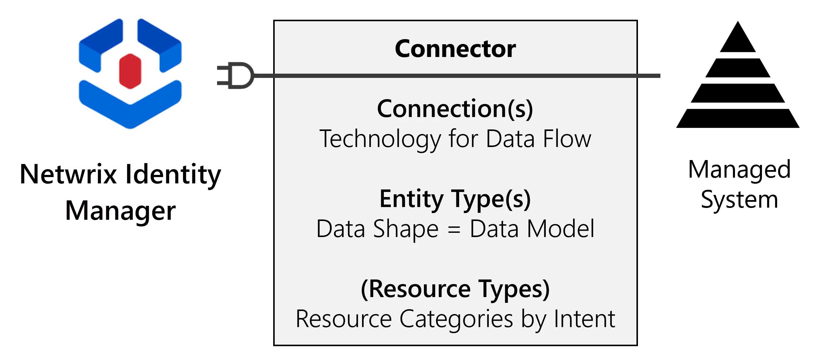

Identity Manager's connectors all operate on the same basic principles. Technically speaking:
For example, let's say that we want to connect Identity Manager to our Active Directory, or AD:
  • A connector must be created, first as a named container which will include the connections and entity types related to one managed system; See the Connector topic for additional information.
    We create a connector named AD (so far, an empty shell).
  • A connector is linked to an agent which acts as the go-between for Identity Manager's server and the managed system; See the Architecture topic for additional information.
    Our AD connector uses the provided SaaS agent.
  • A connection describes the technology used that enables data to flow back and forth between Identity Manager and the managed system; See the Connection topic for additional information.
    We want to use a connection Directory/Active Directory to perform synchronization and automated provisioning, and a second connection Ticket/identitymanager to perform manual provisioning through Identity Manager.
    You can find standard connections dedicated to one application (AD, Microsoft Entra ID, etc.), and generic connections to communicate with any application (CSV, Powershell, RobotFramework, SQL, etc.).
  • The shape of the extracted managed system's data is modeled by entity types (we will use the term resource to refer to an entity type that has been instantiated); See the Entity Type topic for additional information.
    We create a single entity type AD - Entry which contains all the attributes that will describe its resources, i.e. AD groups and users. The attributes include the department, the employee identifier, the manager, the group membership (member/memberOf), the dn, the parent dn, etc.
  • The intent of resources within the managed system is made clear by categorizing resources into resource types. See the Resource Type and Categorize Resources topics for additional information.
    We categorize AD resources into distinct resource types: AD User (nominative) for basic accounts, which we want Identity Manager to provision automatically; AD User (administration) for sensitive administration accounts, which we want to provision manually through Identity Manager.
Connector Technical Schema
A connector requires at least one connection and one entity type.
When provisioning a managed system, the corresponding connector also needs at least one resource type.
Local vs. Saas agents — To simplify things, Identity Manager has made it possible to start configuring connectors without installing a local agent in your organization's network. Instead, you can use the agent integrated with Identity Manager's server in the Cloud (SaaS agent). See the Architecture topic for additional information.
