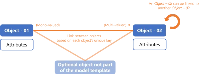

All templates are detailed with examples and schemas with the following key:
Schemas' Key
During the technical modeling inside Identity Manager, these objects will become entity types, their attributes will become scalar properties, the links between them will become navigation properties.

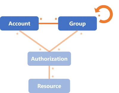

User-Group
Authorization mechanisms
The User-Group template is better suited to represent typical Role-Based Access Control authorization mechanisms, where a user is authorized to perform an action according to their account's membership to a specific group. Instead of groups, some systems talk about roles or profiles: users are authorized to perform an action through a given role or profile which they are assigned, instead of a group membership. It is all the same idea, and the User-Group template is perfect for them too.
Groups can also be categorized and grouped into larger groups.
Users are represented by the accounts they own.
Model
User-Group Model
Thus you need to create one entity type to represent groups (or roles or profiles) and one for accounts.
Each entity type needs to be shaped with properties, chosen according to the data useful for entitlement assignment.
The only sensitive and required properties are those constituting the link between both entity types, i.e. the navigation properties representing the group membership.

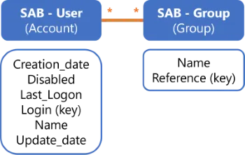

Example - SAB
The SAB system handles authorizations using users and groups. A user is authorized to perform an action according to their group membership.
We define two entity types SAB - User and SAB - Group. We fill them with a few attributes useful to manage entitlements in the SAB application. Finally, we add a navigation property in both entity types in order to link User with Group with an "n-to-n" relationship.
User-Group Example - SAB

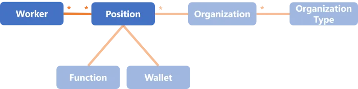

Example - SDGE
The SDGE connector is used not to manage people but positions, so the application screens depend on the user's position. In other words, Identity Manager is going to manage users' entitlements in SDGE through their positions.
The object User or Account from the template, which contains users' accounts, is called here Worker.
The object Group from the template is called here Position (grouped into organizations, themselves grouped into organization types). It contains the way an entitlement is given, here through a given position and wallet.
User-Group Example - SDGE
For SDGE, Identity Manager provisions only workers and the link between workers and positions.

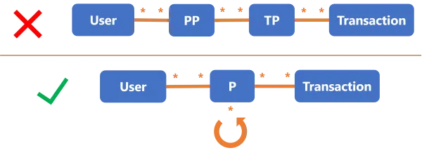

Instead of creating as many Profile objects as there are categories of profile, NETWRIX recommends shaping the Profile object with a category attribute. Indeed, a multiple-object model complexifies the addition of new profiles in the future. And as new profiles can be created in the future though, then you must plan for it.
For example, instead of modeling two artificial types of profiles called PP for "Privilege Profile" and TP for "Technical Profile", prefer a single object P that represents all profiles using a specific attribute to differenciate technical from privilege profiles. This way, the model sticks to the real capacity of the technical tool and all use-cases are considered.
See the schema below this note.
Profiles Example
Transactions are not mandatory in a model. Most of the time, the profile packages are predefined once and for all, or are the responsibility of the application owner. Then Identity Manager doesn't need to manage the specific transactions for a profile directly inside the managed system. You can hence avoid modeling transactions altogether. In this case, you fall back on the User-Group model with a twist: if profile categories are relevant in the system's authorization mechanism, then you must take them into account.

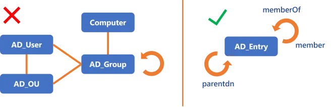

Let's say we are modeling an Active Directory, which handles authorization through the group memberships of accounts. In other words, to assign an entitlement to an identity, we make the AD account of said identity member of the corresponding AD group. That is exactly what the User-Group template is designed to handle. See the Model the Data topic for additional information.
User-Group Model
Step 2: adapt the model to your reality.

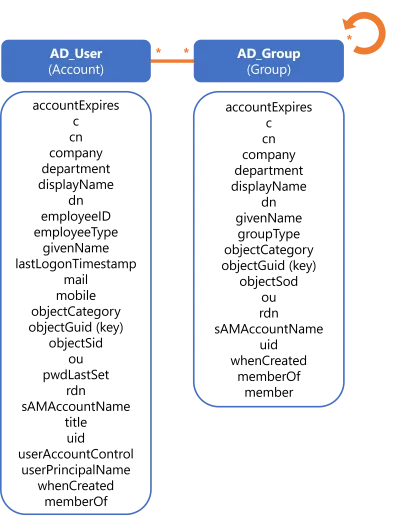

We start by renaming the Account object as AD_User and the Group object as AD_Group.
AD Example - Step 1
Step 3: define useful data close to your reality.
We shape these objects with the following attributes:
AD Example - Step 2
Step 4: ensure that all objects have unique keys.
Indeed we defined objectGuid as a key for both accounts and groups.
Step 5: ensure the guidelines' enforcement.
We could content ourselves with this model. The main benefit of this model is to closely mimic the reality of the AD authorization mechanism. But we'd like to go a bit further, applying a "keep it open to changes" approach.
Observe the similarities between AD_User and AD_Group. There are many attributes repeating between the two entity types.
We can simplify: prefer a single object AD_Entry that can represent both users and groups. The difference between the two types of object will be made clear via specific properties like objectCategory, member and memberOf.
Beyond avoiding repetition, this makes the model easily adaptable if new elements pop up.
For example, we could want to include computers or organizational units in the model in the future. Instead of creating two new additional objects AD_Computer and AD_OU, the existing object AD_Entry can represent them both at no additional modeling cost. Even though we could add AD_Computer and AD_OU without merging groups with entries, designing AD_Entry with all these attributes provides the means to add objects without creating new entity types.
AD_Entry Example
