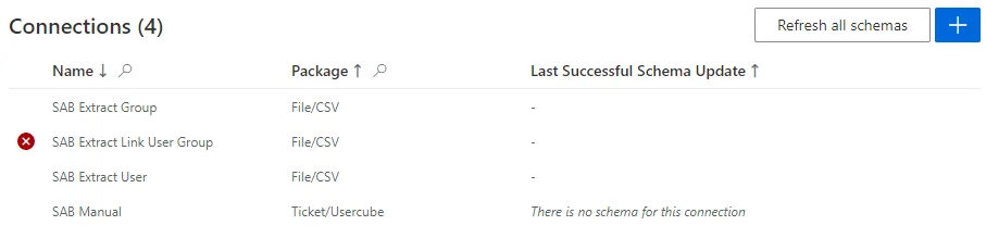

In the Connections frame, either the last successful schema update is indicated or an icon is shown if the refresh schema failed.
Failed Refresh Schemas
Some packages don't generate a schema. For these packages, the Refresh Schema button isn't displayed on the connection's page. On the connector's page, a connection without schema is indicated by the sentence "There is no schema for this connection".

If the Failed icon appears, then:
Decline Icon
Ensure that the schema of the connection is refreshed.
If the schema couldn't be recovered, then:
Schema Not Recovered
  • Ensure that the managed system is properly connected.
  • Check the connection's settings.
    Example: For a CSV connection, ensure that the file paths are written correctly in full, such as C:/UsercubeDemo/Sources/Directory.xlsx.
You may have a schema that could not be recovered if you work with a system without a direct access to the agent. In this case, schema refreshment will fail but that does not mean that there necessarily is a problem.
Try again from a system that can access the agent.
