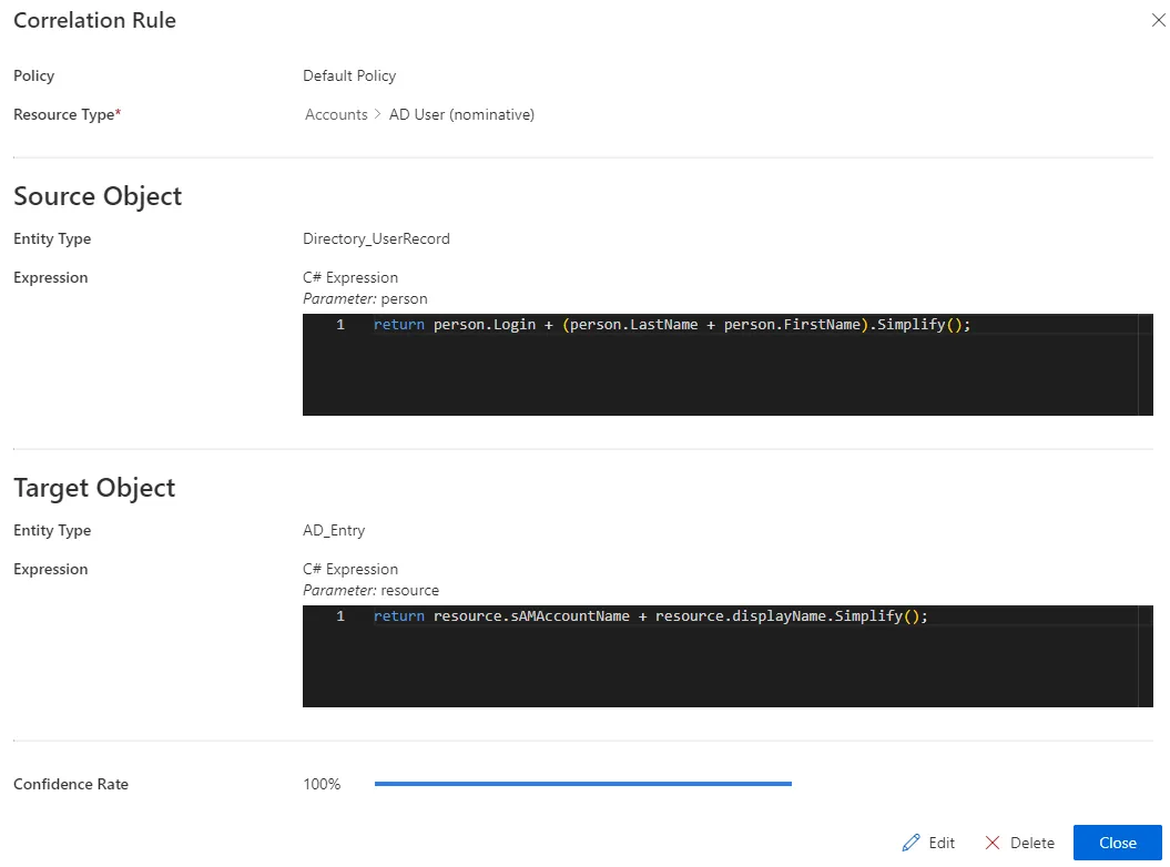

Correlation rules don't have to compare equivalent properties from Identity Manager and from the
managed system. A rule can compare for example users' Login
from Identity Manager with their
sAMAccountName
from the AD, even using C# expressions if needed.

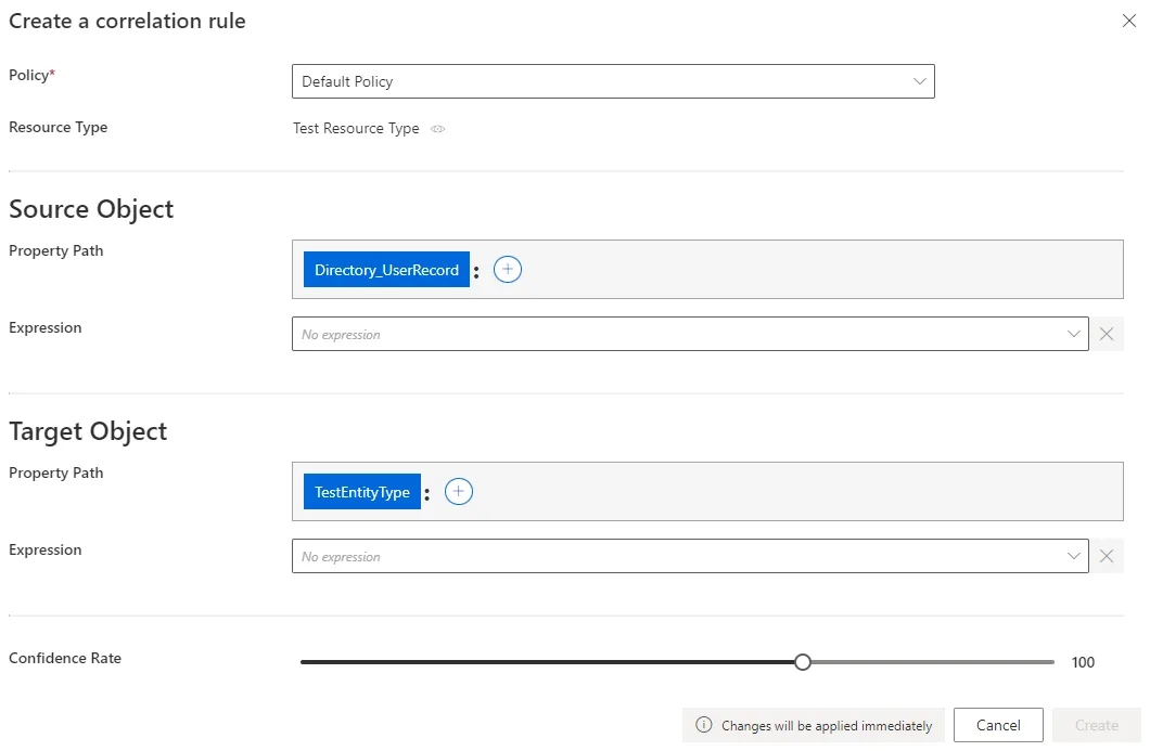

On the relevant resource type's page, click on Correlation Rules and + New.
Correlation rules can also be created through the Access Rules screen (accessible from the home page, in the Configuration section), clicking on the Correlations tab and the addition button at the top right corner.
Fill in the fields.
- Source Object: at least one property from the source system that is going to be linked to a given target object. Can be defined by a property path and/or an Expressions.
- Target Object: one property from the managed system that is going to be linked to a given source object. Can be defined by a property path and/or an Expressions.
Confidence Rate
: rate expressing the rule's reliability, and its priority order.In this example, a person via their login and name, is the owner of a nominative AD account via its
sAMAccountName
attribute and display name:
Click on Create and see a line added on the rules page.

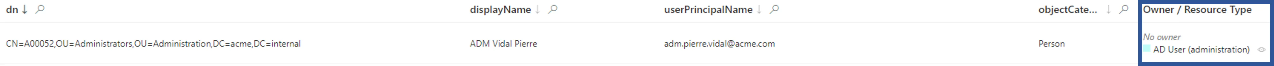

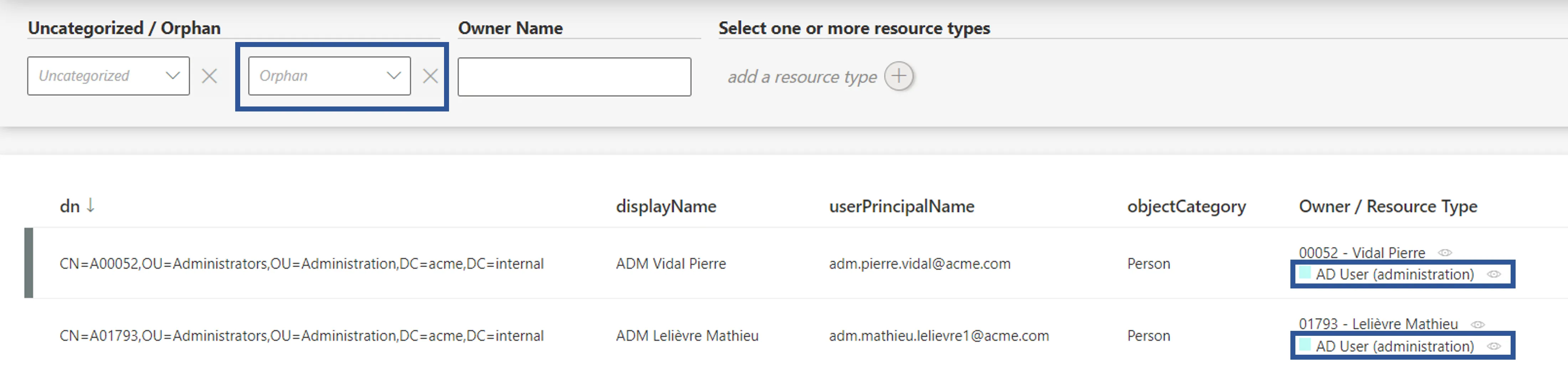

In order to verify the process, check the list of Review Orphaned and Unused Accounts and analyze them to look for patterns revealing correlation issues. To do so, click on the target entity type(s) affected by your rule(s) in the left menu of the home page.
The entity type's page can be configured via XML to customize all displayed columns and available filters, especially the Orphan filter that spots resources without an owner, and the Owner / Resource Type column that shows the owner assigned to each resource.
A knowledgeable person must analyze a few samples to ensure that resources' owners can all be justified, meaning that orphaned accounts are supposed to be so, and that correlated resources are matched with the right owner.
