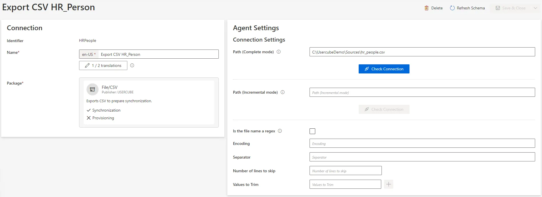

  3. Create an Export CSV connection for each HR file to connect. See the Create a Connection topic for additional information.
    HR Connection

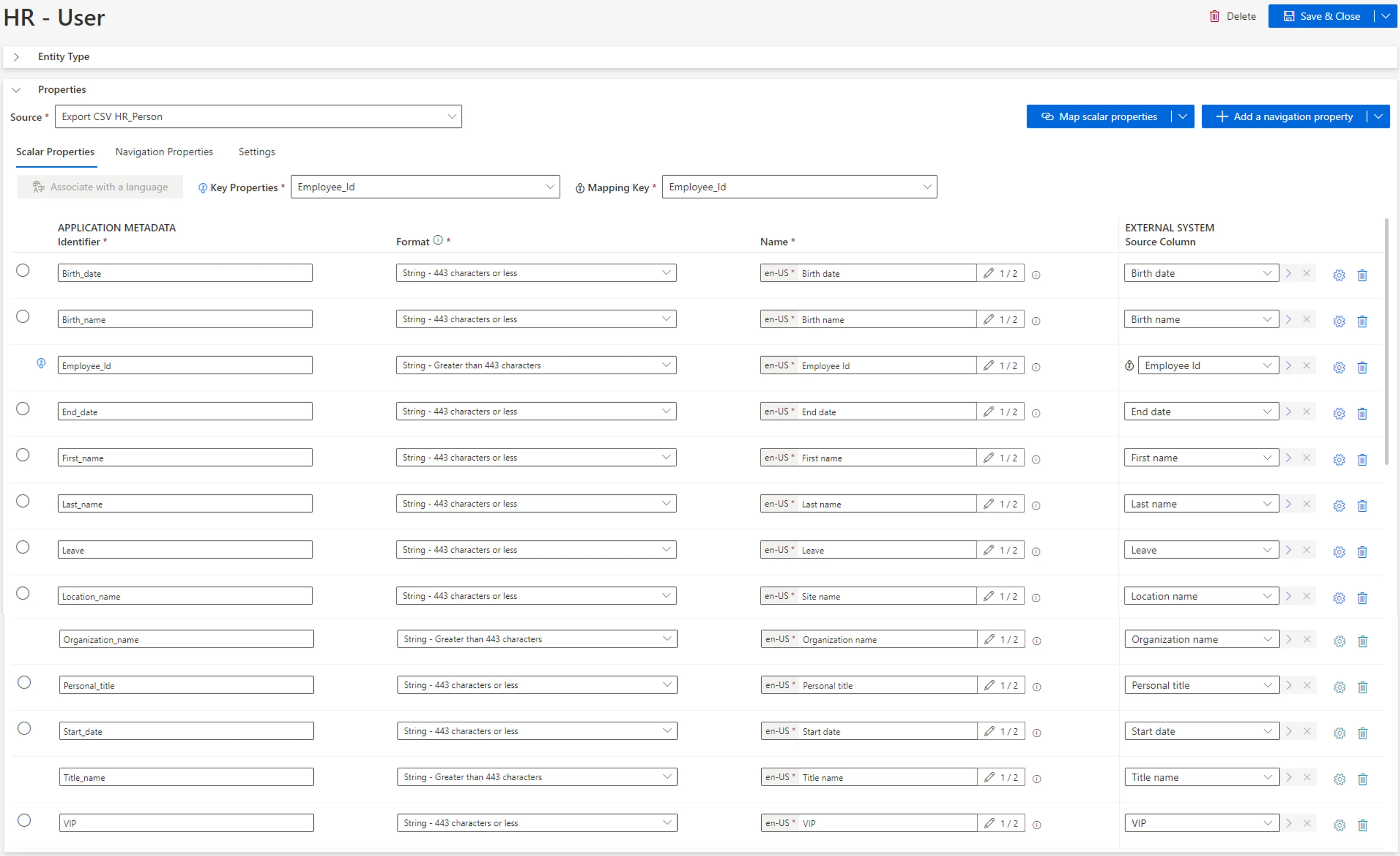

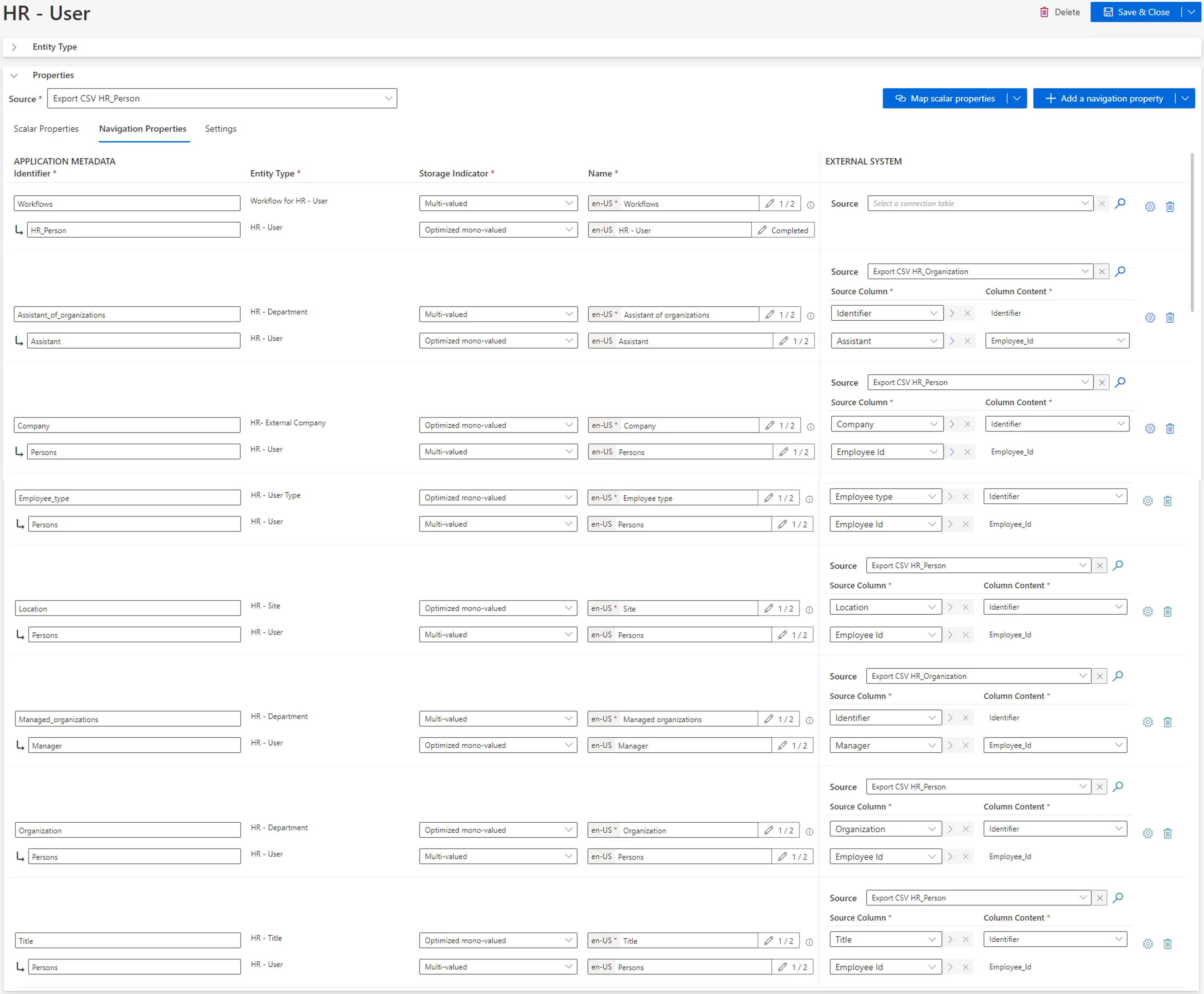

  4. Create an Entity Type corresponding to your model. For example:
    HR Entity Type - Scalar Properties
    HR Entity Type - Navigation Properties

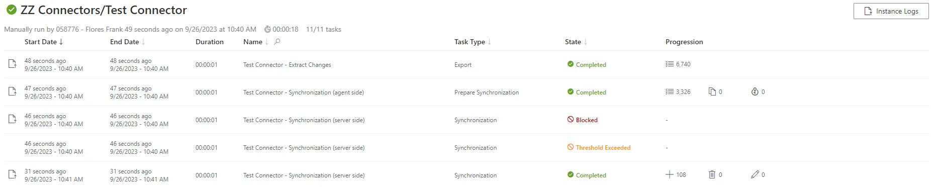

  1. Launch synchronization.
  2. Access the connector's logs (from Job Results on the connector's dashboard) to ensure that synchronization completed successfully.
    Jobs Results
