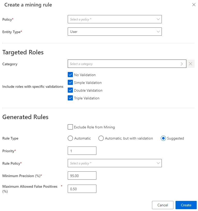

Create a Mining Rule
Create a mining rule by proceeding as follows:
  1. On the home page in the Configuration section, click on the Role Mining button.
    Home page - Connectors

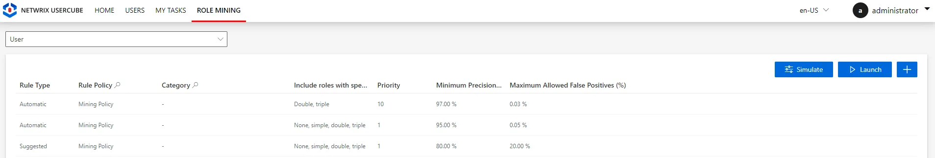

    You will see all existing mining rules.
  2. Click on the addition button at the top right and fill in the fields.
    Addition Icon
    New Mining Rule
    • Policy: Create a Policy in which the mining rule exists.
    • Entity Type: Create an Entity Type on which the mining rule is applied, i.e. the entity type targeted by role mining's entitlement analysis.
    • Category: Create a Category containing the roles targeted by role mining's analysis.
    • Include roles with specific validations: includes in role mining's analysis the roles requiring zero and/or one and/or two and/or three validations.
    • Exclude Role from Mining: ignores the specified roles during the mining process triggered by the next mining rules (in terms of priority).
    • Rule Policy: Create a Policy in which the single role rules will be generated.
      Netwrix Identity Manager (formerly Usercube) recommends using a policy dedicated to role mining in order not to remove existing assignment rules.
    • Rule Type: type of the generated single role rules, which defines the type of role assignment that can be: Suggested so that the resource type is listed among suggested permissions in the permission basket of users matching the criteria during an entitlement request, suggested assignments must be selected manually to be requested; or Automatic so that the resource type is automatically assigned to users matching the criteria; or Automatic but with validation so that the resource type is listed in the permission basket of new workers, these assignments can still be modified.
    • Priority: priority order of the mining rule. Identity Manager applies mining rules one after the other in descending order.
    • Minimum Precision: minimum authorized percentage of correct role assignments, considering both the roles that are assigned to users who should have them, and the roles that are not assigned to users who should not have them.
      NETWRIX recommends around 99.5%, to be lowered when working on a sensitive application and/or a large user population, and vice versa.
    • Maximum Allowed False Positives: maximum authorized percentage of false positive assignments, i.e. roles that are assigned to users who should not have them.
      NETWRIX recommends around 1%, to be lowered when working on a sensitive application and/or a large user population, and vice versa.
    Enlarge the number of managed entitlements by tolerating errors:
    Automation reduces the error rate by avoiding human mistakes. Errors can still occur such as "false positives", i.e. users receiving inappropriate entitlements, and thus creating security issues. However, experience shows that a slight error tolerance in role mining can highly benefit automation.
  3. Click on Create and see a line added on the rules page.
  4. Click on Simulate to perfom role mining in a simulation. See the Perform a Simulation topic for additional information.
    Role Mining Jobs
    If you need to bypass the simulation process, clicking on Launch will perform role mining and apply its results directly. NETWRIX recommends always performing role mining in simulation.
