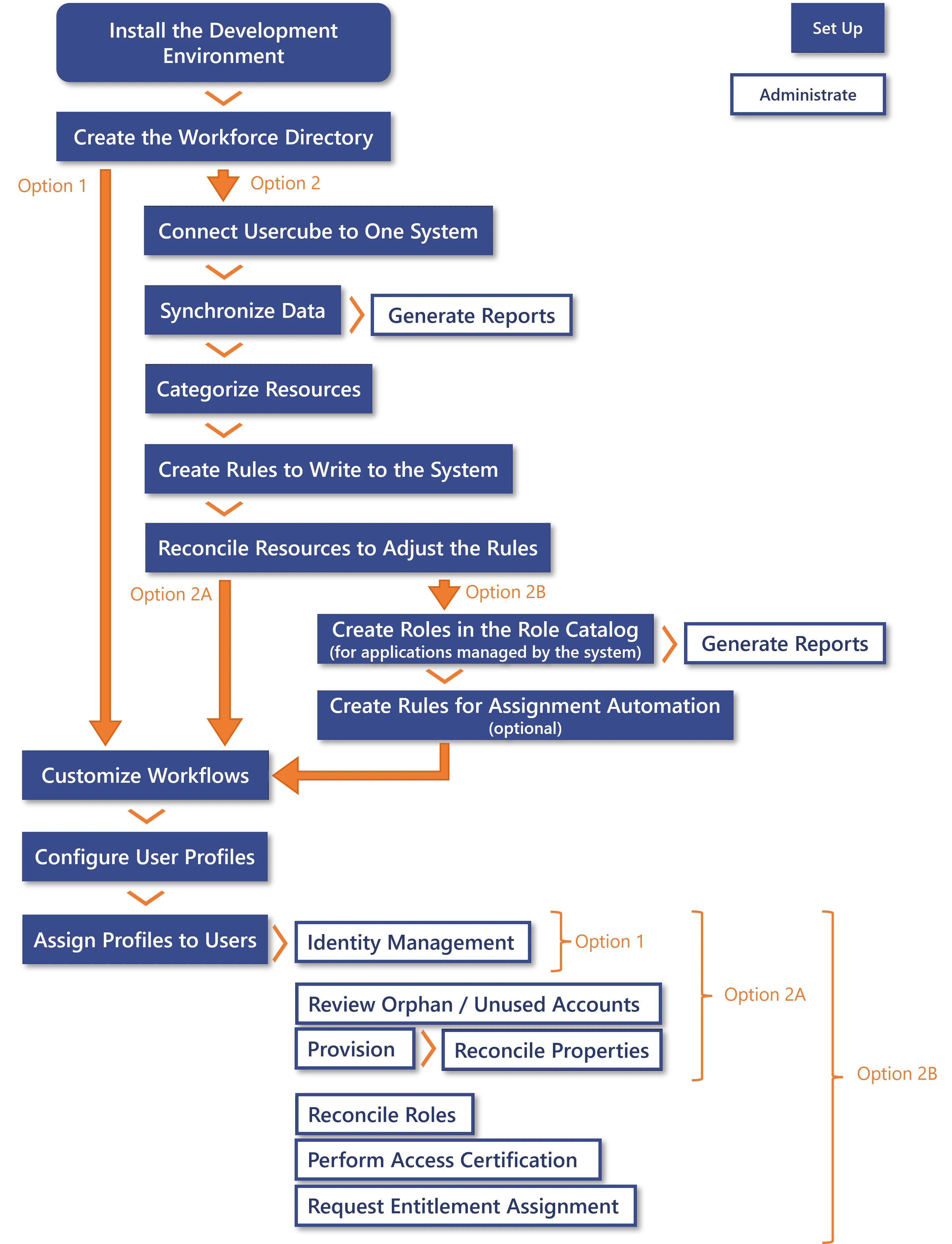

Process Schema - How to Start with Usercube

Common starting steps
  1. Install the Development Environment.
  2. Create the Workforce Repository : configure the generation of unique properties; load workforce identities to Identity Manager; adjust the data model.
After these first steps, two process options are available according to your needs: either aim directly to identity management and the opening of Identity Manager to end-users, or first connect Identity Manager to an external system in order to enable more administration activities. Both options can be started simultaneously.
Option 1: Based on the workforce directory
Starting with the workforce directory does not require the installation of a local agent.
Go directly to the common final steps (step 10).
Option 2: Based on an external system
Starting with an external system requires the installation of a local agent.
  1. Connect Identity Manager to the system by creating a connector. See the Connect to a Managed System topic for additional information.
  2. Synchronize Data the system's data into Identity Manager.
    Based on this, you can Generate Reports , for example the list of resources in the system. A few predefined reports are available from the start, you can generate any report from this list as soon as it makes sense according to the integration progress.
  3. Categorize Resources in order to classify them according to their intent, and correlate these resources with their owners.
  4. Create a Provisioning Rule to write to the system in order to update the resources' properties directly in the system.
  5. Adjust the rules by reconciling resources, i.e. analyze the differences spotted between the reality of resources' properties and those computed by the previously established rules. Especially, verify that accounts are correlated to the right owners and that their properties have the right values. See the Reconcile a Property topic for additional information.
    Either the integrator handles the customization of the rules and the review of non-conforming resources, or they can assign an application administrator profile to a given user to perform it. Assigning this profile requires profile configuration, see steps 11 and 12.
After connecting Identity Manager to an external system, two process options are available according to your needs: either aim directly to identity management and the opening of Identity Manager to end-users, or first build the role model in order to enable more administration activities. Both options can be started simultaneously.
Option 2A: Straight to identity management
Option 2B: First build the role model
  1. Create Roles in the Role Catalog for applications managed by the system.
  2. Automate Role Assignments if needed: use Role Mining to create single role rules in bulk; adjust the generated rules individually and manually.
Common final steps
  1. Adjust HR workflows to keep the workforce directory updated (only in XML configuration).
  2. Define the permissions for your user profiles. See the Configure a User Profile topic for additional information.
  3. Define the authentication mode by configuring SelectUserByIdentityQueryHandlerSetting (only in XML configuration), and Assign Users a Profile to open the application to end-users.
