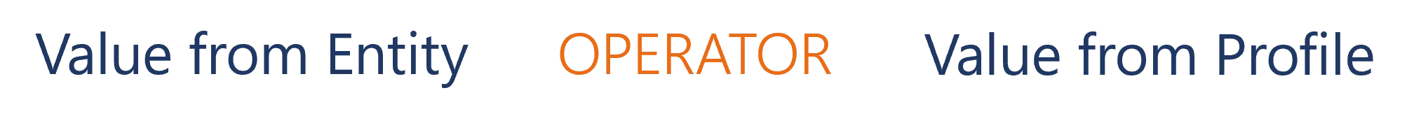

This condition is actually a comparison expression between two elements:
- The value of a property which is originating from an entity targeted by the rule
- A comparison value that can be constant, or originating from the user profile
