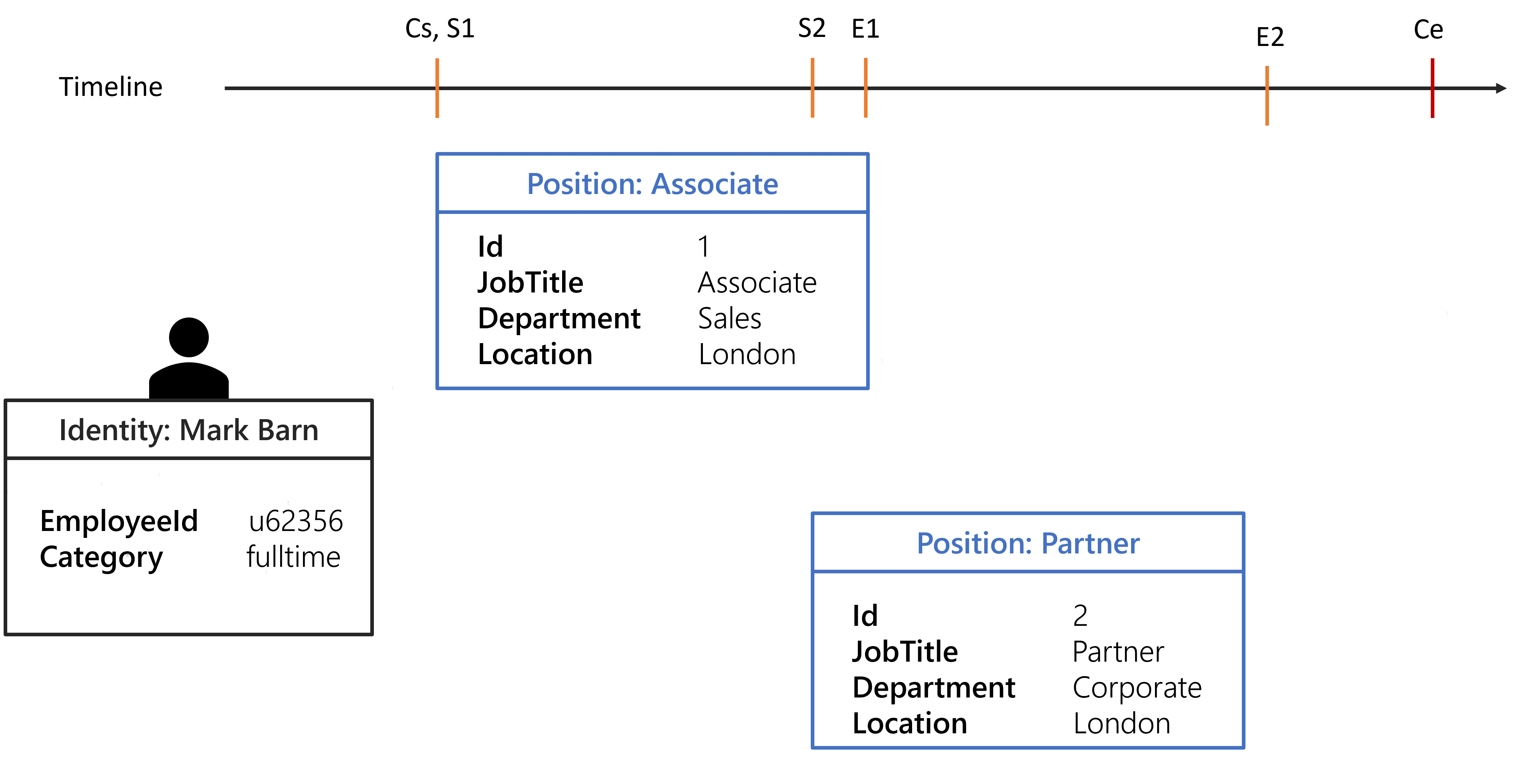

The following image shows the positions of Mark Barn in a defined timeline.
simple-recordsection-identity

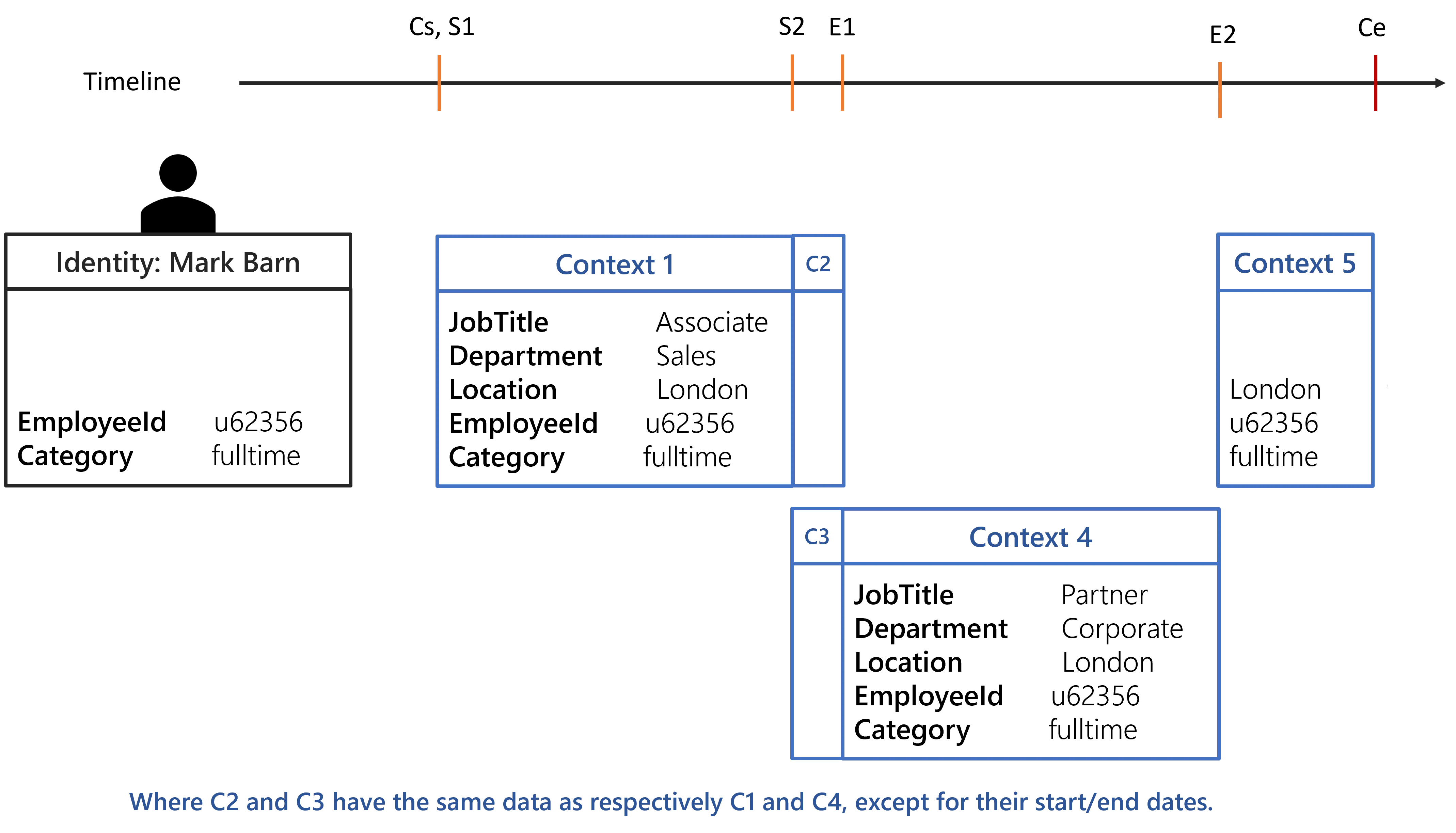

With the given configuration and the identity of Mark Barn, the following contexts are generated:
simple-recordsection-result
Each computed context will be used to create a set of dimension-value pairs, thus having 3 sets for the Evaluate Policy algorithm.
Any rules targeting identities with a fulltimeCategorywill be assigned toMark BarnfromCstoCe```.
Any rules targeting identities working in London will be assigned to Mark Barn from S1 to E2.
Any rules targeting all identities will be assigned to Mark Barn from Cs to E2 because from E2 to Ce there isn't any position. This behavior can be overridden by specifying ExtensionKind="None" on the Directory_UserRecord_Position section.

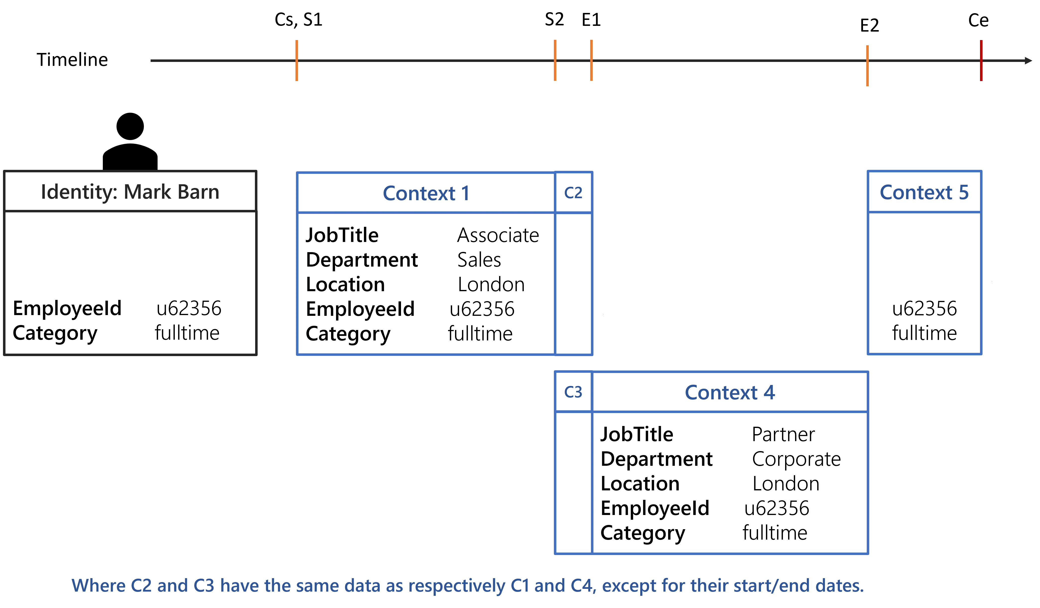

Using the identity of Mark Barn the computed contexts should be as followed:
recordsection-withvaluecopy-result1
Any rules targeting identities working in London will be assigned to Mark Barn from Cs to Ce.

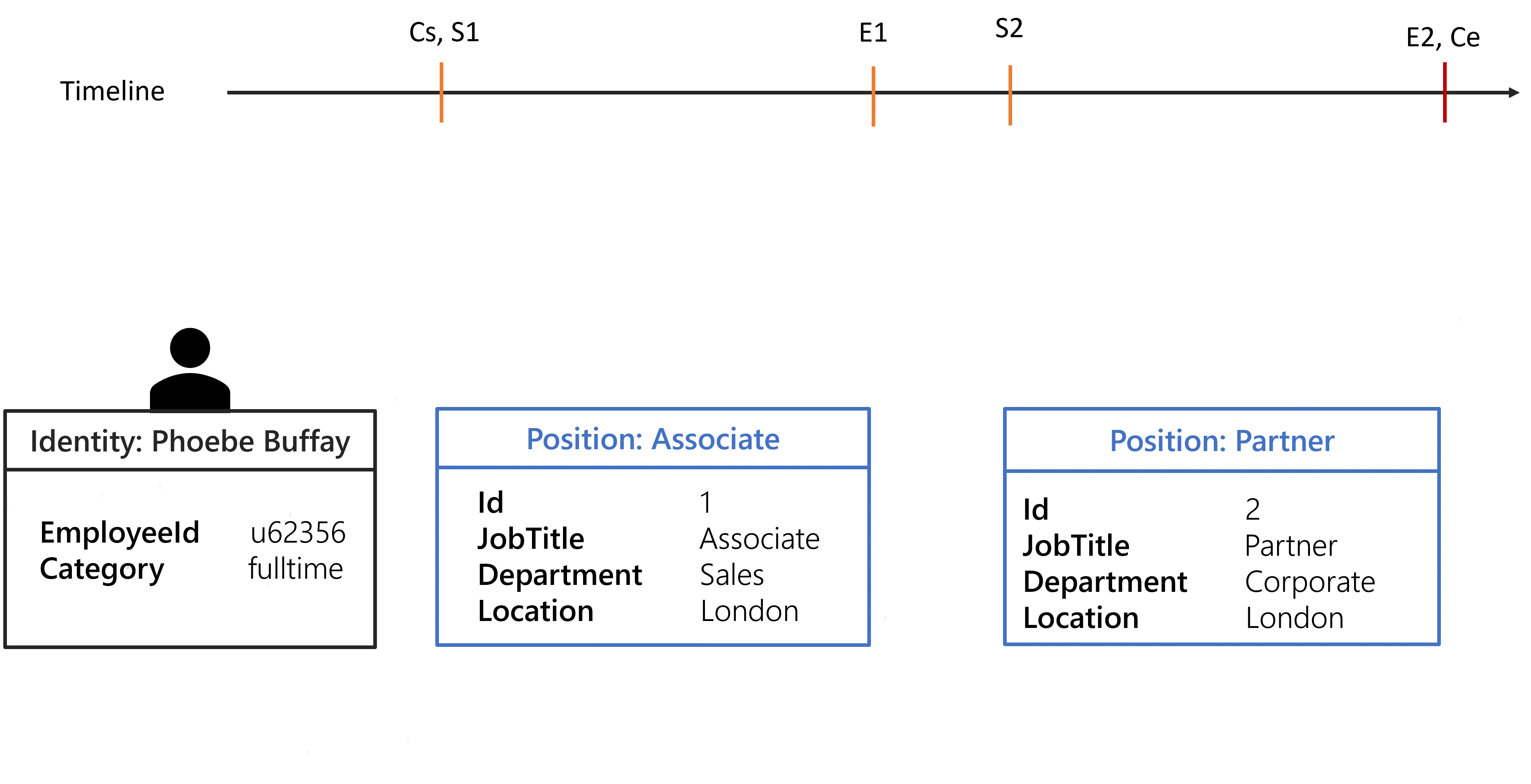

The property value copy can be leveraged to extend a chosen position when for some time the identity does not have one. The following configuration and the identity of Phoebe Buffay will be used to showcase a position extension. It is done by removing the ExtensionKind="None" of the position properties.
Default section:
<RecordSection Identifier="Directory_UserRecord_Default" DisplayName_L1="Contract Properties" SourceEntityType="Directory_User" ResourceEntityType="Directory_UserRecord" StartProperty="ContractStartDate" EndProperty="ContractEndDate">
</RecordSection>
Position record section:
<RecordSection Identifier="Directory_UserRecord_Position" DisplayName_L1="Position Properties" SourceEntityType="Directory_User" ResourceEntityType="Directory_UserRecord" StartProperty="StartDate" EndProperty="EndDate">
<Property Property="Department" /> <Property Property="Location" /> <Property Property="JobTitle" />
</RecordSection>
positionextension-identity

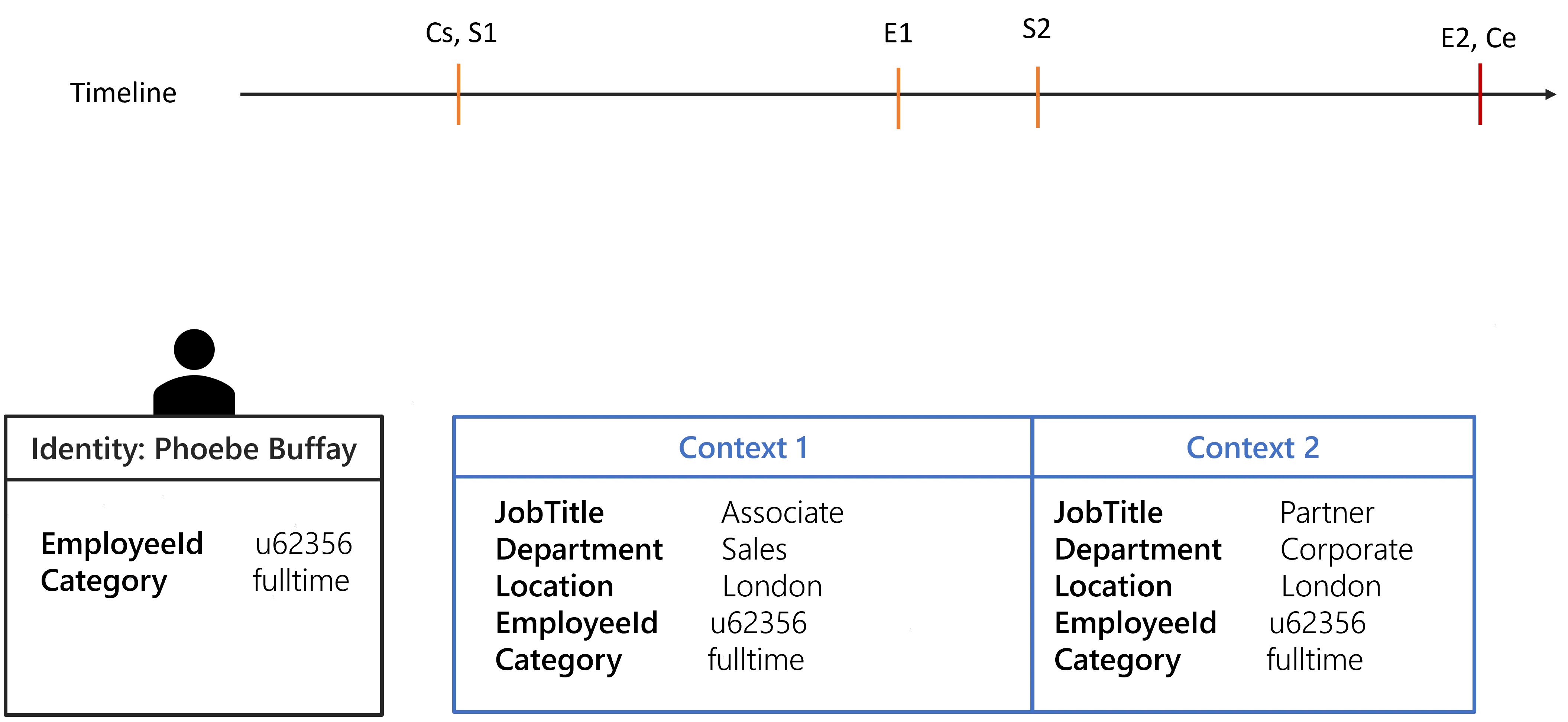

Two contexts will be generated.
positionextension-result
By default, the previous position is extended when there is a gap. If there isn't any previous position then the next position will be anticipated.
The choice of the position to extend can be configured by leveraging the SortKeyExpression in the position Record Section .
