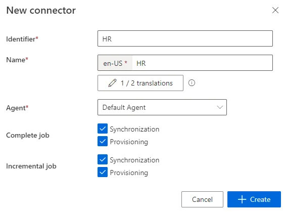

  2. Declare an HR connector using your local agent.
    HR Connector Declaration

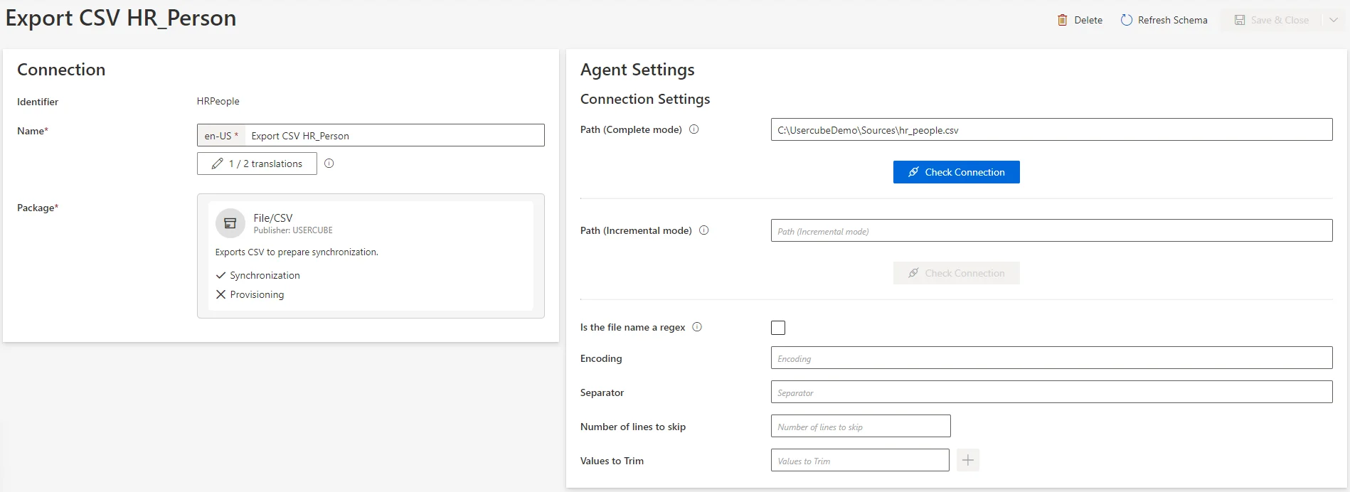

  3. Create an Export CSV connection for each HR file to connect.
    HR Connection

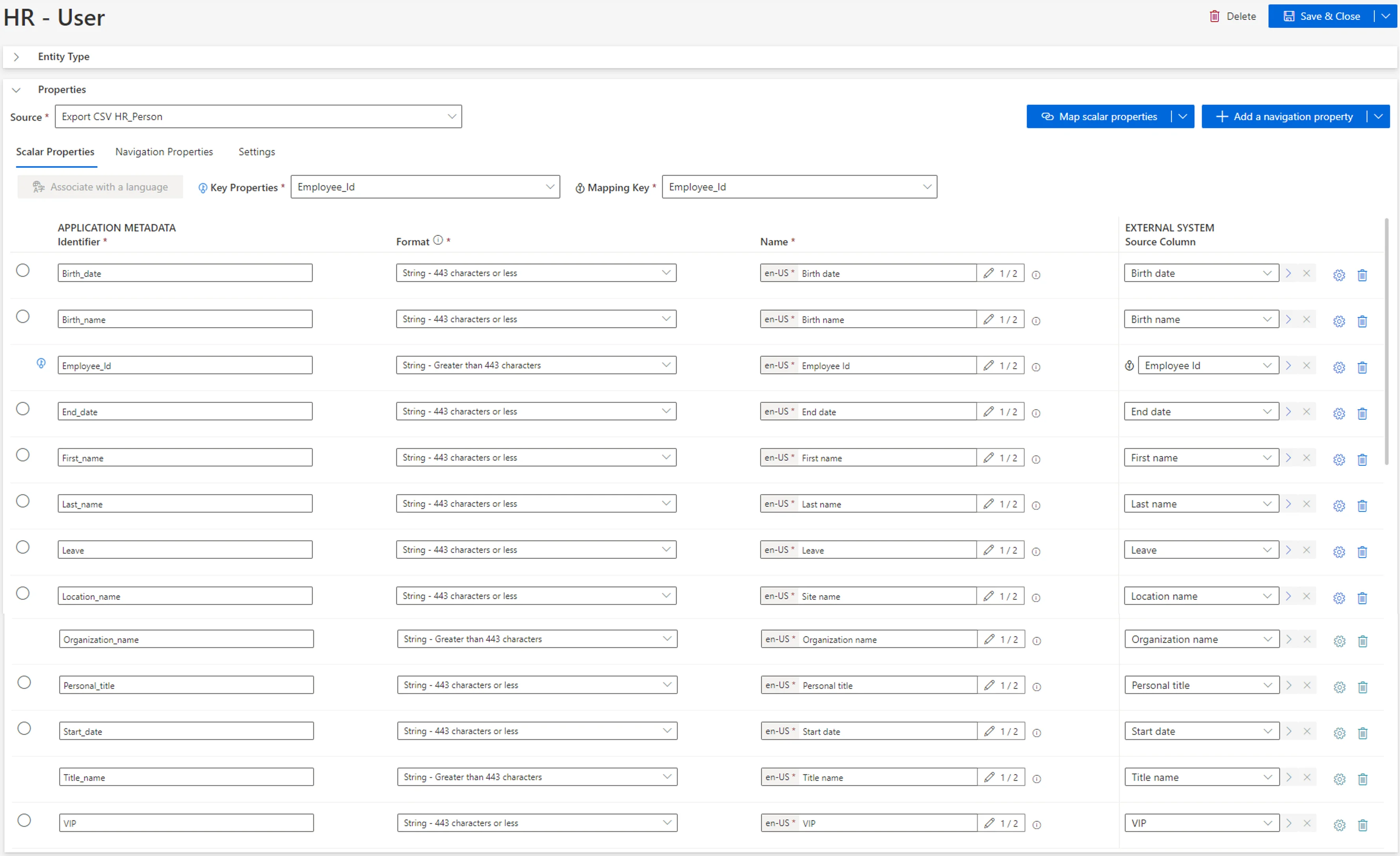

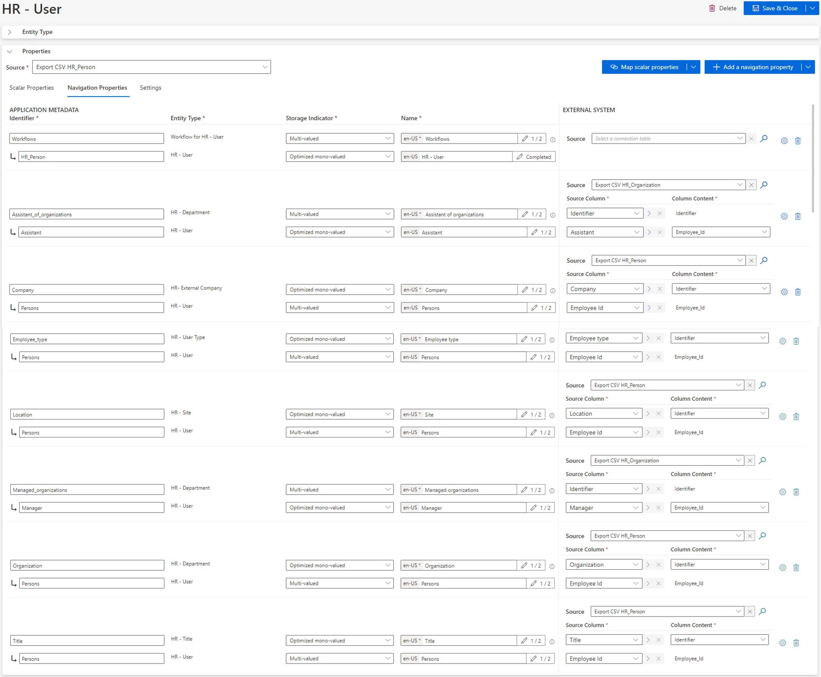

  4. Create the entity types corresponding to your model. For example:
    HR Entity Type - Scalar Properties
    HR Entity Type - Navigation Properties

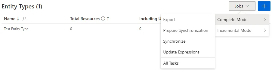

  5. Don't forget to reload and synchronize to access HR data within Usercube.
    Reload
    Synchronize Job

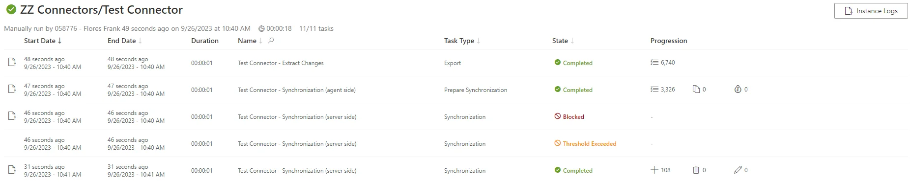

  1. Launch synchronization.
  2. Access the connector's logs (from Job Results on the connector's dashboard) to ensure that synchronization completed successfully.
    Jobs Results
