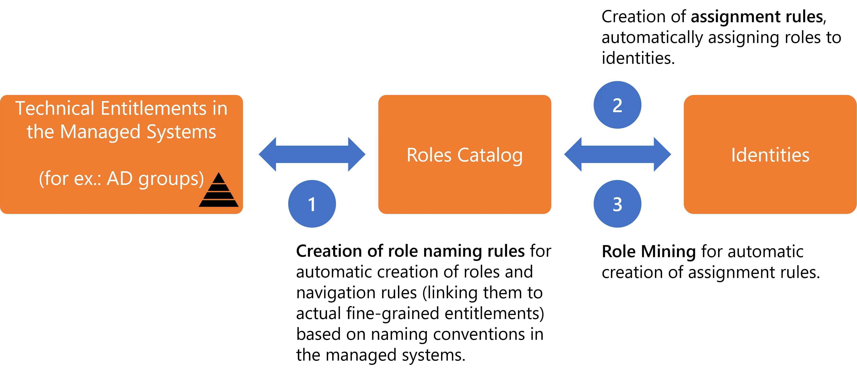

The strategy for the automation of entitlement assignment lies in the automatic making of assignment decisions, based on several automation levels provided by Usercube:
  1. Automation of the creation of the role model, i.e. both roles and navigation rules that represent entitlements in the managed systems, through role naming rules based on resources' naming conventions in the managed systems.
  2. Automation of entitlement assignment through assignment rules, which use identity criteria (called dimensions, like identities' department or work location, etc.) to decide what entitlements to assign automatically to identities.
  3. Automation of the creation of said assignment rules through Role Mining, based on existing data analysis.

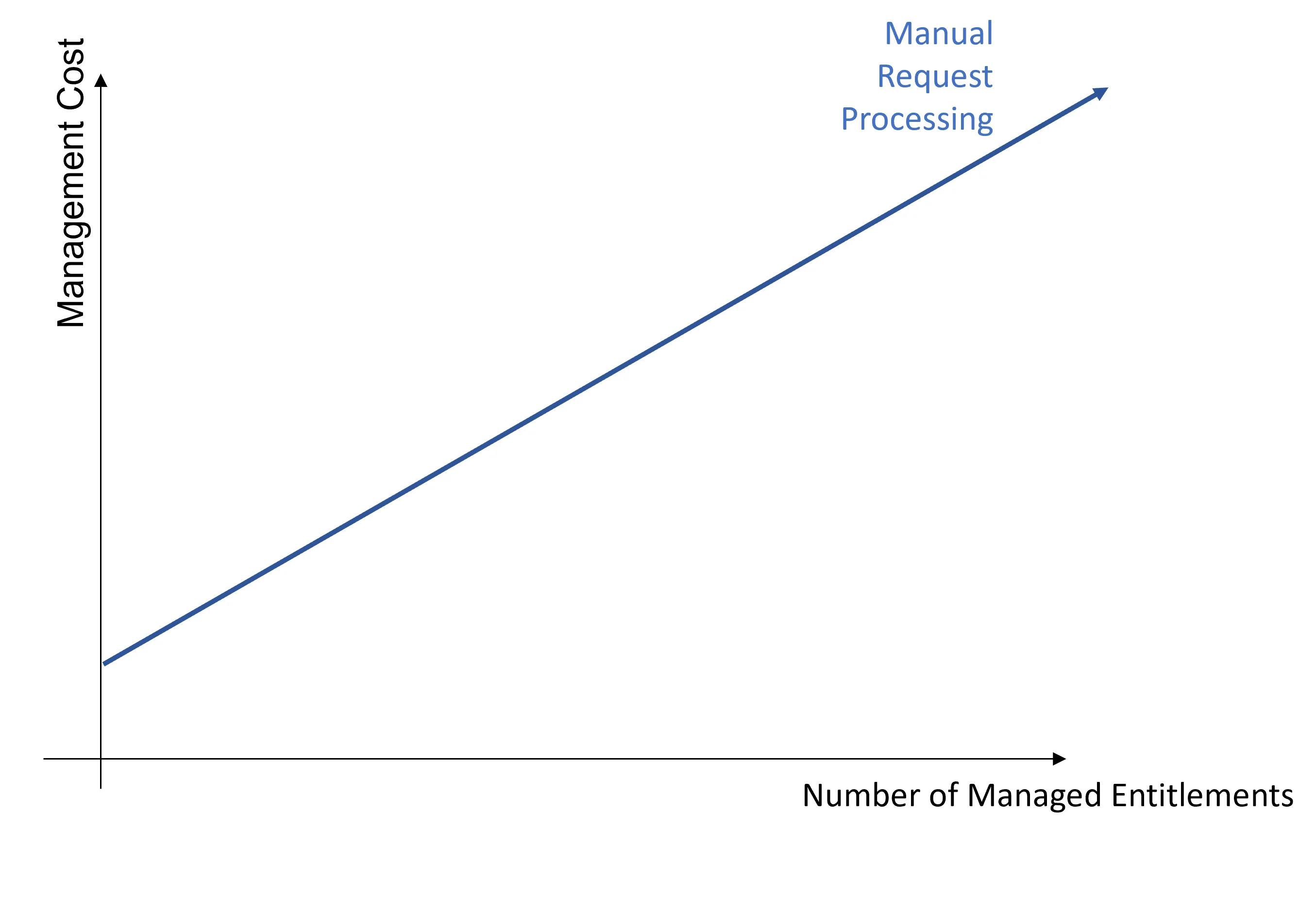

So far, Usercube's configuration has enabled users to use workflows to add and remove entitlements to/from identities. These assignments can be fulfilled manually or automatically, but the decision-making process that defines who gets what entitlement is still manual. Manual assignment poses the following risks:
  • Delay can happen: on the day a worker joins an organization, they rely on a manual action to get all the entitlements required for them to start working. Even with roles aiming to help managers to understand actual entitlements, delay happens.
  • Errors can happen: human mistakes are expected in role distribution, even though largely mitigated by the role review process and certification campaigns.
  • It is time-consuming.
The entitlement management cost mainly varies according to the number of managed entitlements. Manual processing for entitlement requests implies a linear growth of the management cost according to the number of managed entitlements.
Optimal Cost Chart - Manual Assignments

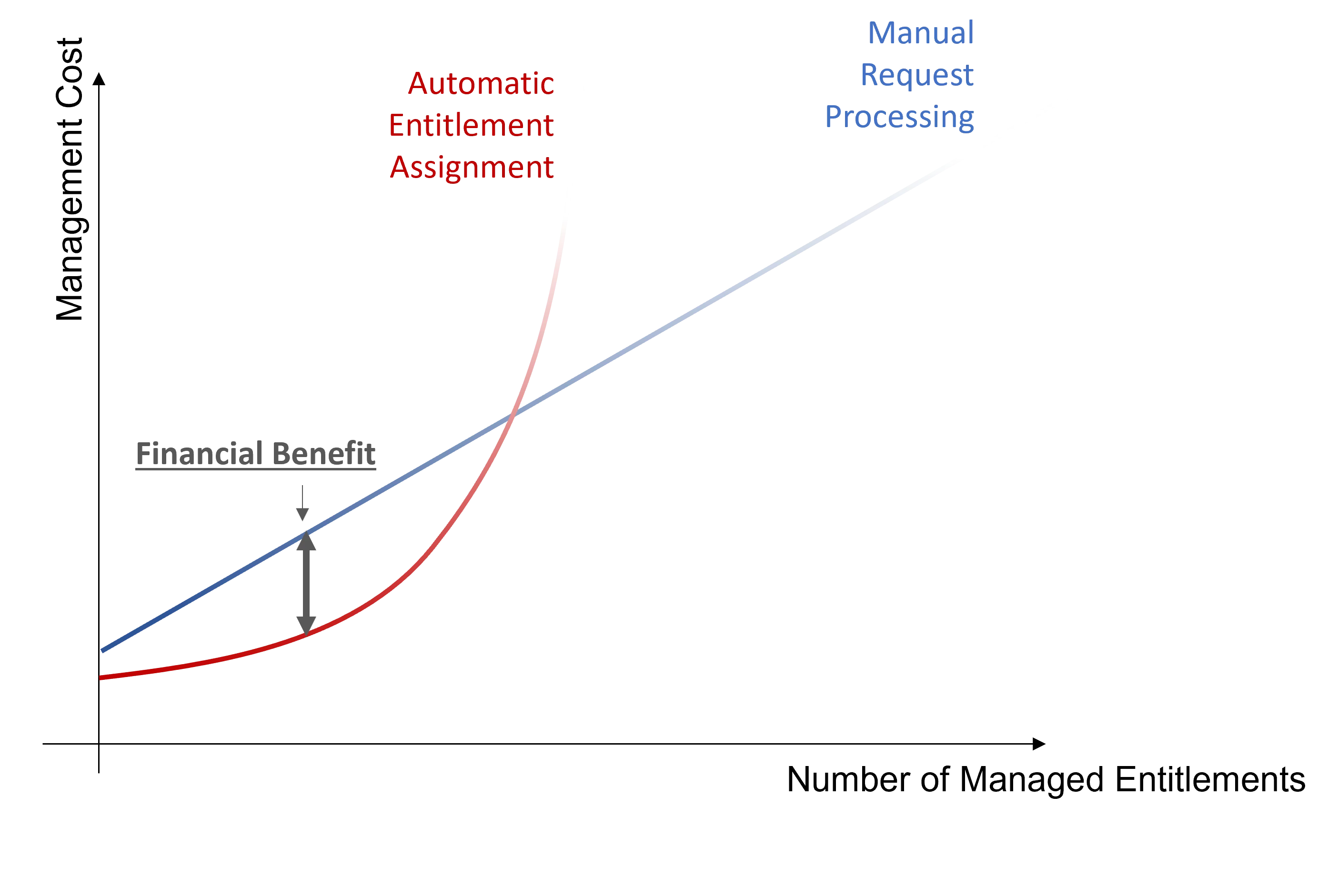

Automation benefits
There is a high potential gain coming with the automation of assignment decisions:
  • Machine Learning masters the error rate, as it is used as a parameter for Role Mining, i.e. masters false positive assignments (entitlements assigned to a user while they ought not to) which constitute a security breach, and false negative assignments (entitlements not assigned to a user who needs it) which are functionnaly blocking;
  • Machine Learning achieves lower error rates than people;
  • Machine Learning can compute the role model way faster than a person. Consequently, the model can be computed more frequently and thus sticks closer to reality.
Optimal Cost Chart - Automation Benefits
Automation helps integrators find basic assignment rules and face the previous risks, thus reducing cost.

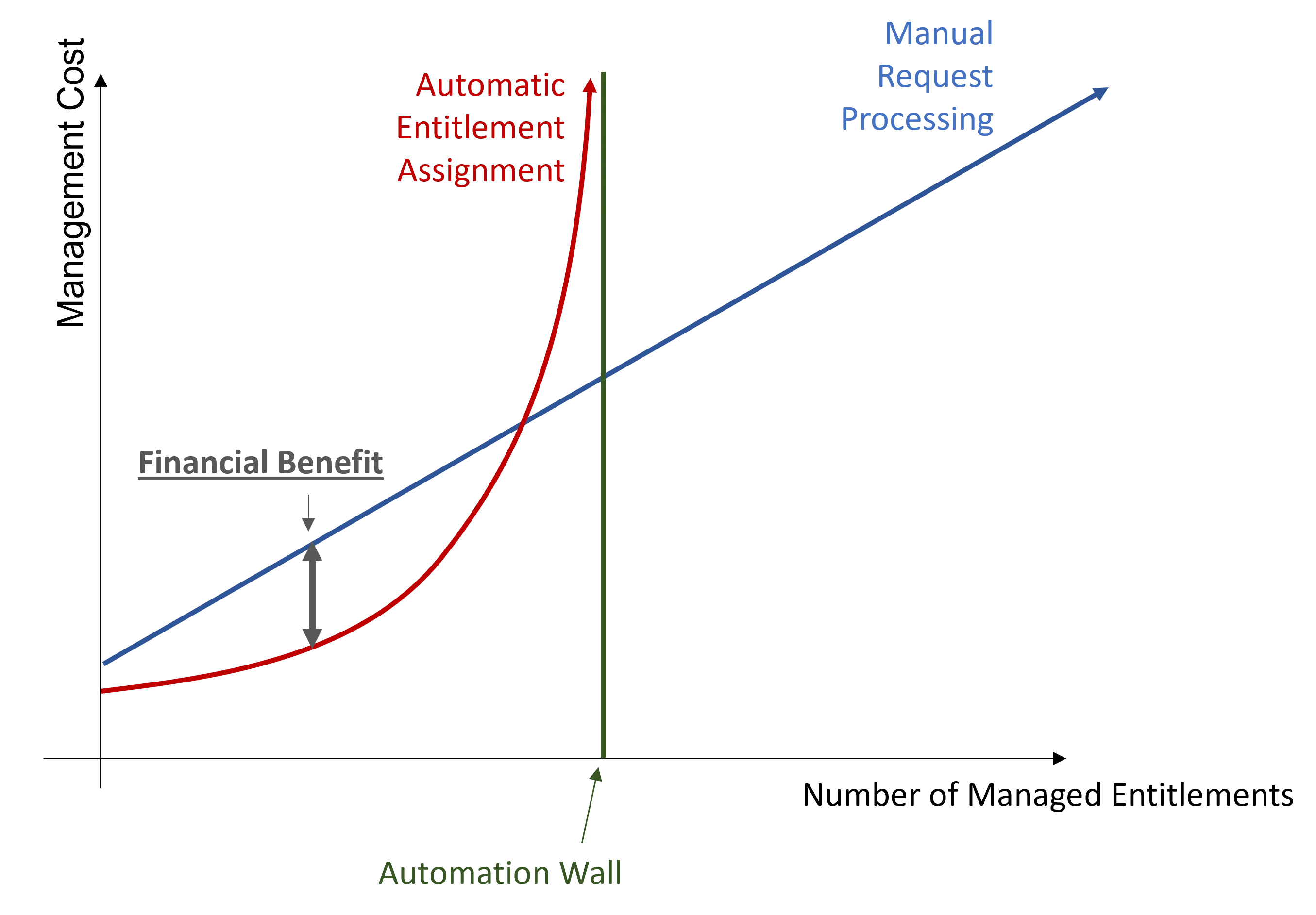

Automation limits
However, automation implies an increasing number of rules. And a high number of rules implies a certain complexity in rule model understanding, and consequently hiring expensive expert contractors to write the right rules. It drives up costs considerably and draws you near the automation wall.
Optimal Cost Chart - Automation Limits
The automation wall represents the automation threshold that cannot be overcome. It mostly comes from the fact that with limited data, automation capabilities are also limited. Everything cannot be automated.

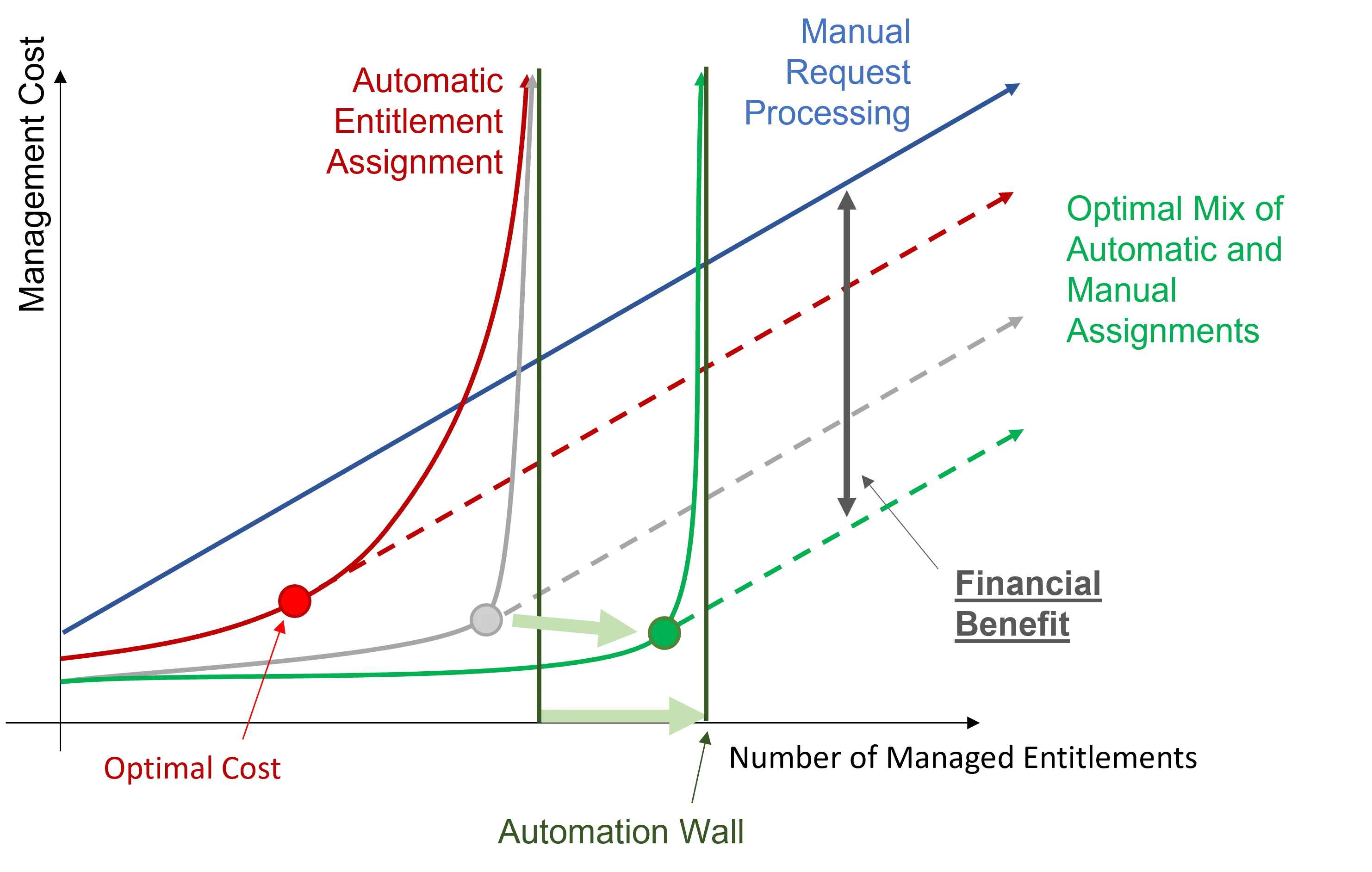

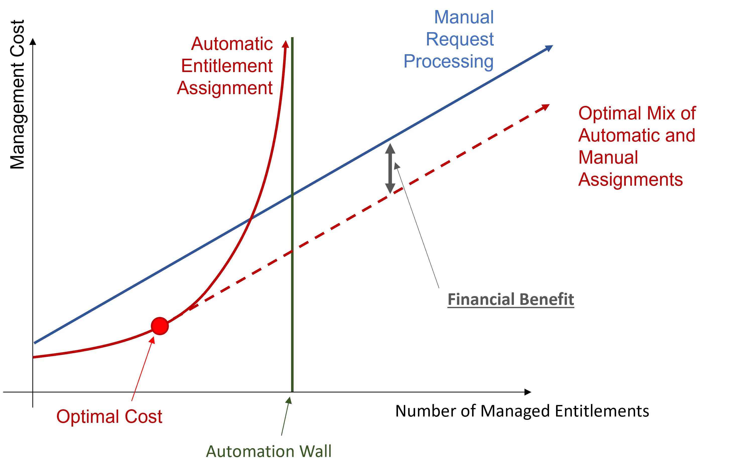

Automation strategy
The idea is to stop automation when the automatic cost curve increases faster than the manual cost curve. The optimal profitability is represented on the chart and can be achieved via the optimal mix of automatic and manual assignments.
Optimal Cost Chart
Automation strategy consists in using Machine Learning through Role Mining to get closer to the automation wall. And, as Role Mining doesn't enable overcoming said wall, the goal is to move the wall further away by improving data quality and quantity.

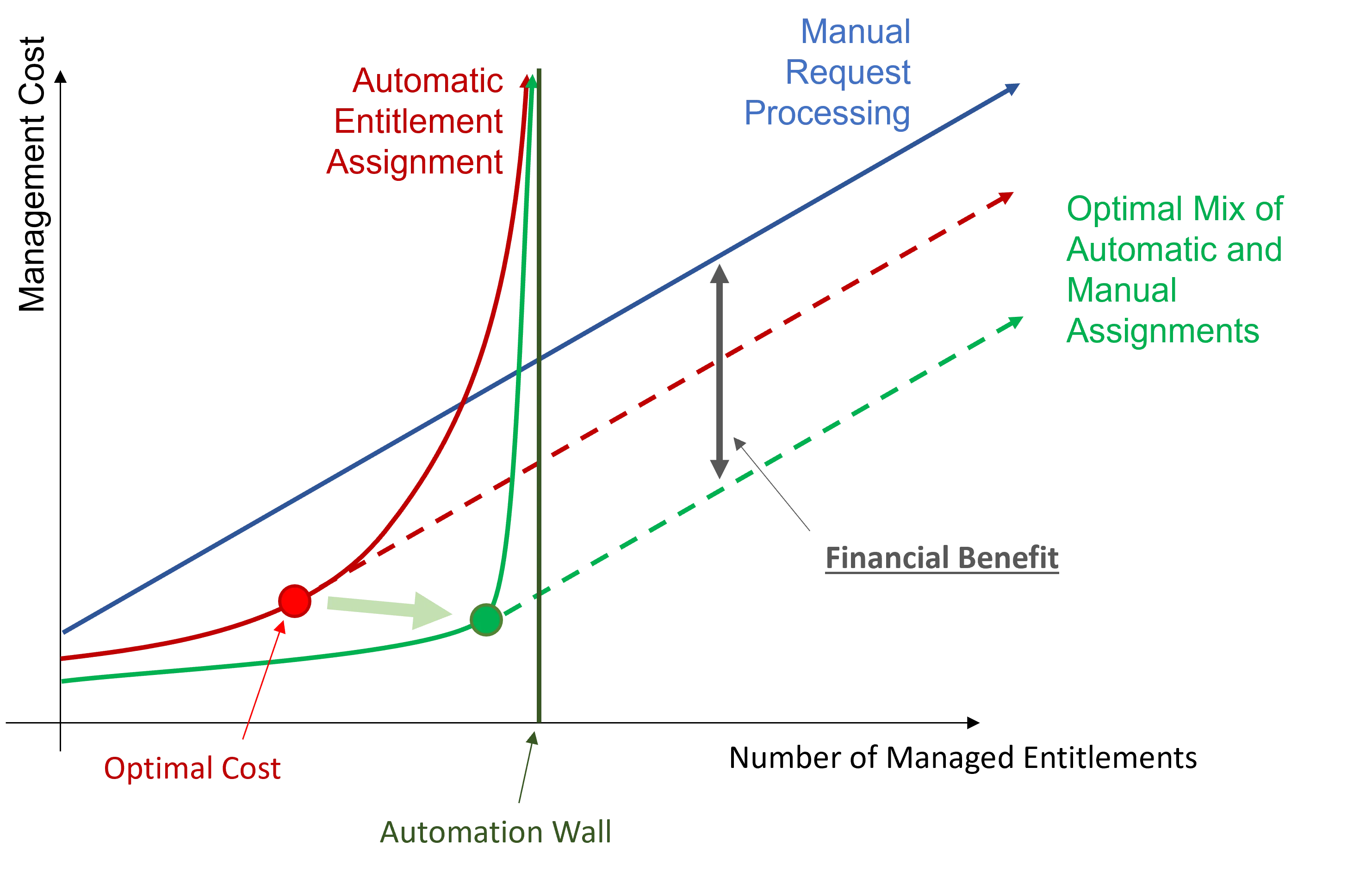

  1. Perform Role Mining to approach the automation wall.
    Role Mining covers more use cases than writing assignment rules manually. It diminishes the error rate and implies a lower execution cost. And thus, it brings the optimal cost closer to the automation wall.
    Optimal Cost Chart - Role Mining
    Enlarge the number of managed entitlements by tolerating errors:
    Automation reduces the error rate by avoiding human mistakes. Errors can still occur such as "false positives", i.e. users receiving inappropriate entitlements, thus creating security issues. However, experience shows that a slight error tolerance in Role Mining can highly benefit automation.

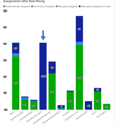

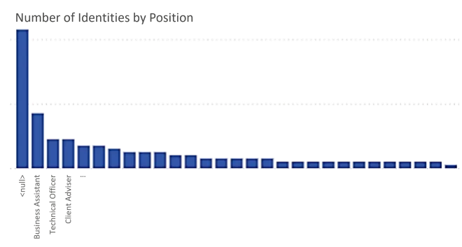

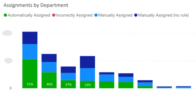

  2. Generate and analyze reports with tools like Power BI to assess the automation wall and identify improvement areas.
    For example in the following Power BI chart, automation is, on average, highly implemented except for SharePoint Projects. This fact reveals a low level of awareness among the workers about their respective projects. This is a typical area for improvement in data quality.

  3. Improve data quality and quantity to move the automation wall.
    Whether automatic or manual, assignment decisions are based on existing data analysis. Data quantity and quality therefore define the position of the wall.
    Improvement in existing data quantity and quality entails the possibility of managing a higher number of entitlements.
    Optimal Cost Chart - Improved Data
    A high quantity of data simplifies data analysis and inferences in assignment rules.
    A high quality of data also simplifies data analysis and enables better accuracy in assignment rules.
