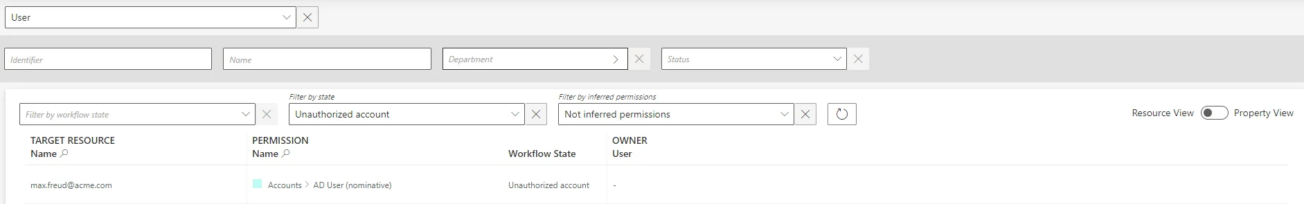

  2. Get to the Resource Reconciliation page, accessible from the corresponding section on the home page.
    Home Page - Resource Reconciliation
  3. Select Unauthorized account as the Workflow State. Orphaned accounts appear with no owner.
    Resource Reconciliation Page
  4. Choose the default resource view or the property view with the top right toggle.

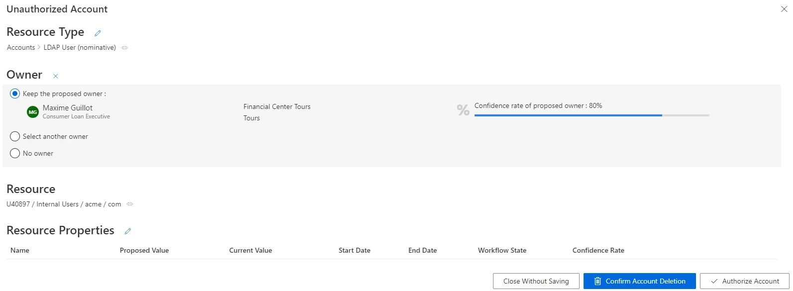

  5. Click on the line of an account with an owner.
    In the following example, the nominative LDAP account linked to the resource U40897 / Internal Users / acme / com has the owner Maxime Guillot with an 80% confidence rate.
    Select Decision
    The displayed confidence rate means that a rule actually assigned the account to the identity, but with a confidence rate too low to imply full automatic assignment. Approval will be required.
    The Resource Properties frame shows all the properties of the resources. They can be updated by clicking on the edit button.
    Edit Button
  6. Select the appropriate decision.
    Decisions must be made with caution as they cannot be undone.
  7. Click on Confirm Account Deletion or Authorize Account according to the previous decision.
