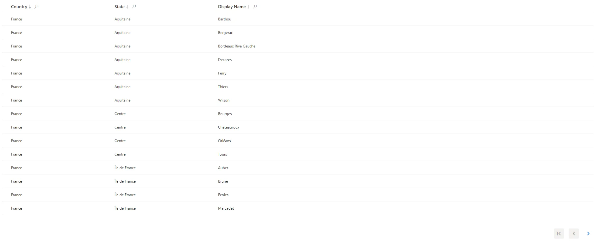

table
The following example displays sites as a table.
<DisplayTable Identifier="Directory_Site" EntityType="Directory_Site" DisplayTableDesignElement="table" IsEntityTypeDefault="true"> <Column DefaultSortPriority="1" DisplayBinding="Region.Country.DisplayName" IsDisplayInSummaryView="true" IsResizable="true" IsSortable="true" CanBeFiltered="true" ColumnSize="2" DisplayName_L1="Country" /> <Column DefaultSortPriority="2" DisplayBinding="Region.DisplayName" IsDisplayInSummaryView="true" IsResizable="true" IsSortable="true" CanBeFiltered="true" ColumnSize="2" DisplayName_L1="State" /> <Column DefaultSortPriority="3" DisplayBinding="DisplayName" IsDisplayInSummaryView="true" IsResizable="true" IsSortable="true" CanBeFiltered="true" ColumnSize="8" /></DisplayTable>
Example - DisplayTableDesignElement Set to Table

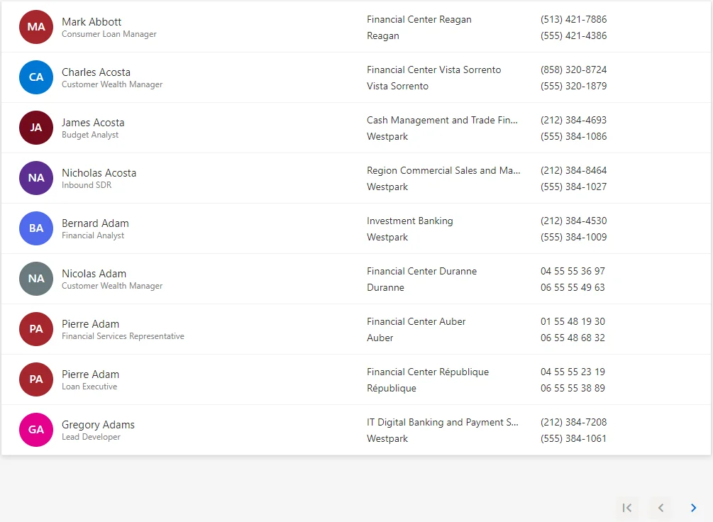

list
The following example displays users as a list.
<DisplayTable Identifier="Directory_User" EntityType="Directory_User" DisplayTableDesignElement="list" IsEntityTypeDefault="true"> <Column DefaultSortPriority="1" ColumnSize="6" IsDisplayInSummaryView="true" SortBinding="MainRecord.LastName" Tile="Directory_User_Tile1" /> <Column ColumnSize="3" IsDisplayInSummaryView="true" Tile="Directory_User_Tile2" SortBinding="MainRecord.FirstName" /> <Column ColumnSize="3" Tile="Directory_User_Tile3" /></DisplayTable>
Example - DisplayTableDesignElement Set to List
For resources to be displayed as a list, the display table must also be configured with tiles.

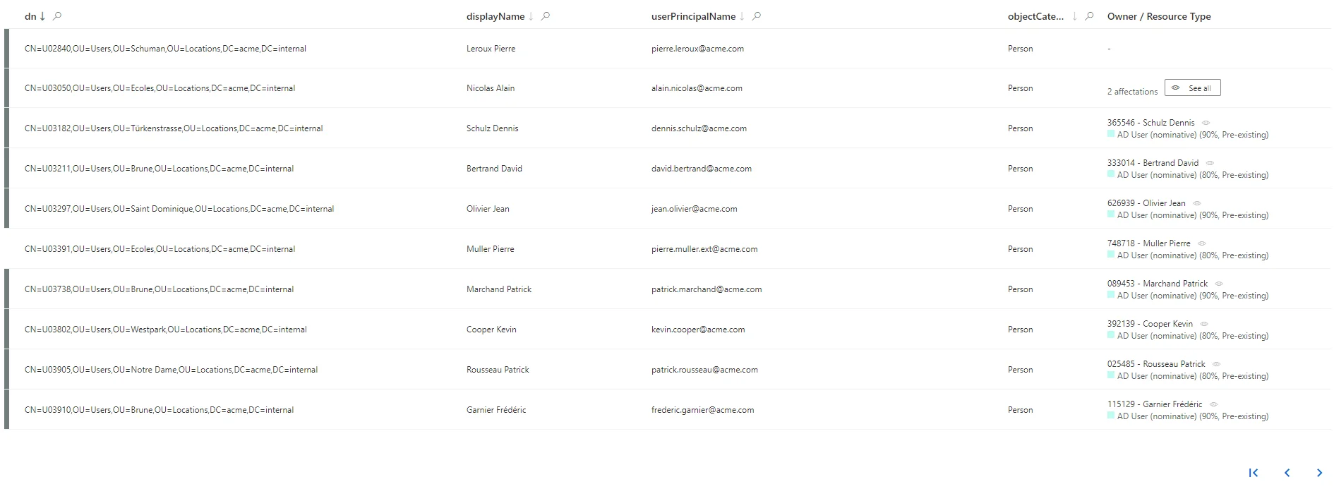

resourcetable
The following example displays AD entries as a table, with an "Owner/Type" column.
<DisplayTable Identifier="AD_Entry" EntityType="AD_Entry" DisplayTableDesignElement="resourcetable" IsEntityTypeDefault="true"> <Column DefaultSortPriority="1" DisplayBinding="dn" IsDisplayInSummaryView="true" IsResizable="true" IsSortable="true" CanBeFiltered="true" ColumnSize="5" /> <Column DisplayBinding="displayName" IsDisplayInSummaryView="true" IsResizable="true" IsSortable="true" CanBeFiltered="true" ColumnSize="2" /> <Column DisplayBinding="userPrincipalName" IsDisplayInSummaryView="true" IsResizable="true" IsSortable="true" CanBeFiltered="true" ColumnSize="4" /> <Column DisplayBinding="objectCategory" IsDisplayInSummaryView="true" IsResizable="true" IsSortable="true" CanBeFiltered="true" ColumnSize="1" /></DisplayTable>
Example - DisplayTableDesignElement Set to ResourceTable
