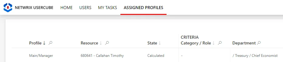

For example, Timothy Callahan is here assigned the Manager profile with the Department dimension
set to Treasury/Chief Economist.
Thus, with the previous access control rule, Timothy Callahan will get certain permissions on users
whose main department is Treasury/Chief Economist.
