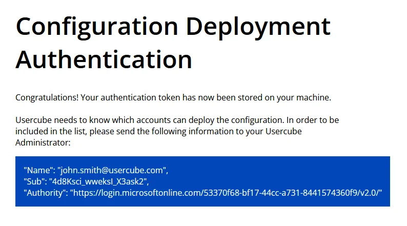

  2. Log in to the IDP to be redirected back to this screen:
    Usercube-Login.exe Success Screen
    Once authenticated, an identification token is stored on your local machine for the authentication to Usercube's deployment and export processes.
  3. Copy the entire text within the blue square and send it to your Usercube administrator.
    The administrator will add the identity information to the configuration of your Usercube instance, to allow the configuration deployment/export.
