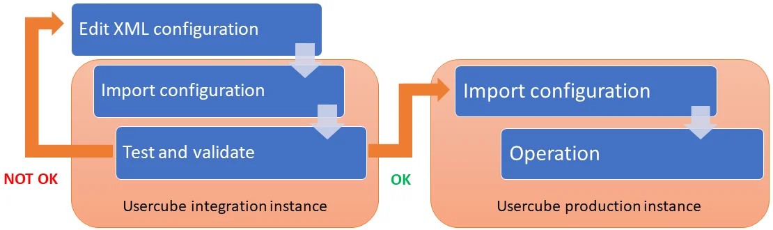

The Usercube project's integration cycle consists in developing a configuration by successive imports in a test instance.
Integration cycle
