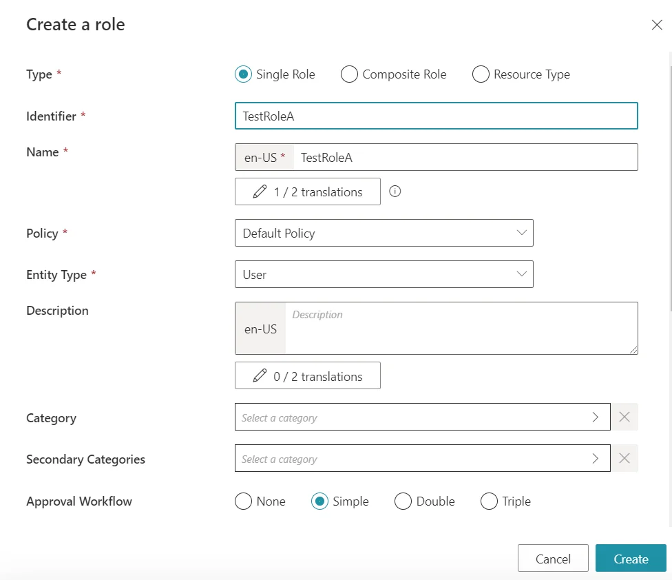

Since we have manually edited the Active Directory, we first need to run an AD synchronization job. Then we create one Single Role for each group in the Active Directory. We will name them TestRoleA and TestRoleB for Directory > User, :
Single Role Configuration Example

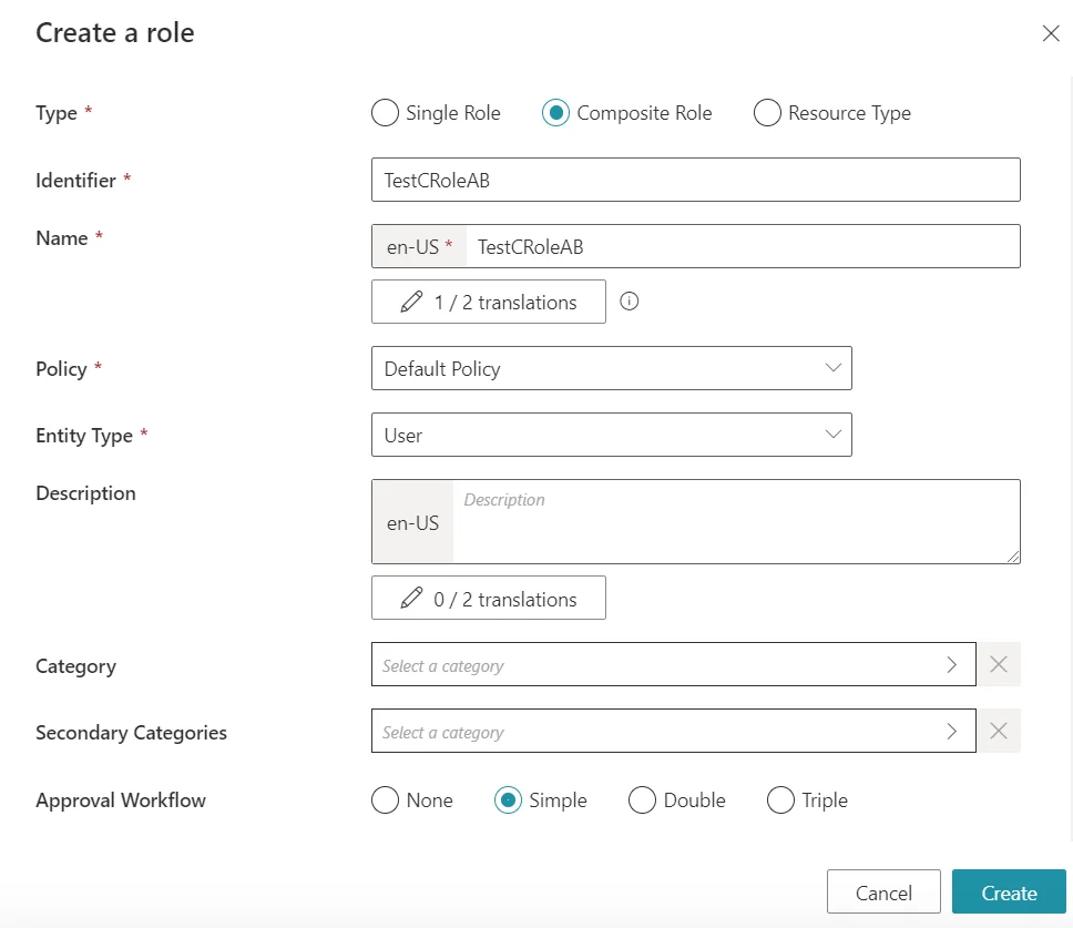

We will also create a test Composite Role to showcase indirect Composite Roles. We will name it TestCRoleAB:
Composite Role Configuration

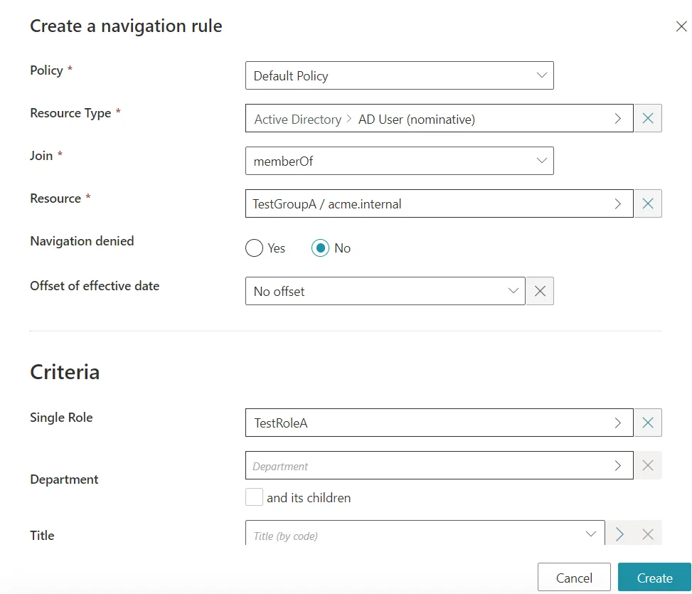

Then we will also need to add some rules. We first need to add one Navigation Rule for each group to link them with their respective Single Role:
Navigation Rule Example

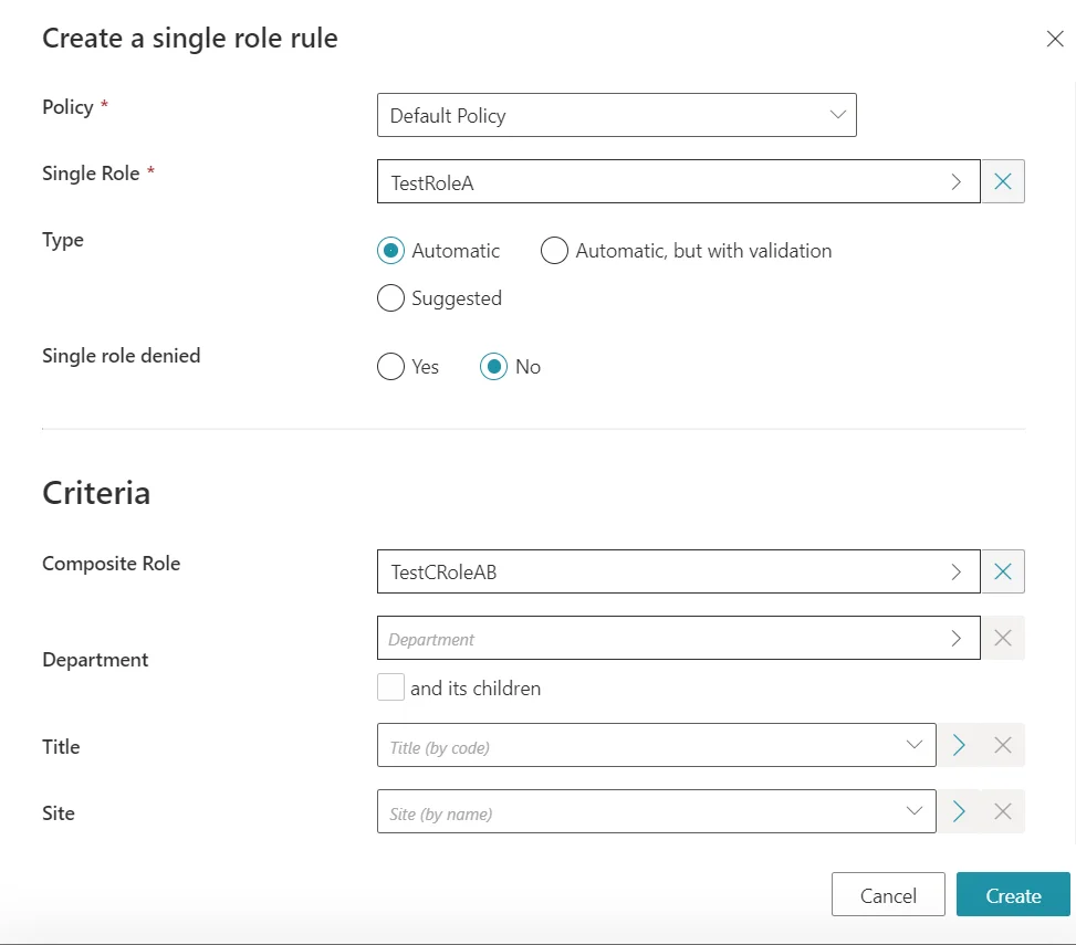

And finally, we need to add Single Role Rules to link our two previously created Single Roles to the new Composite Role:
Single Role Rule Example
Even if two rules of a kind are needed, only one is pictured. Do not forget the other one.

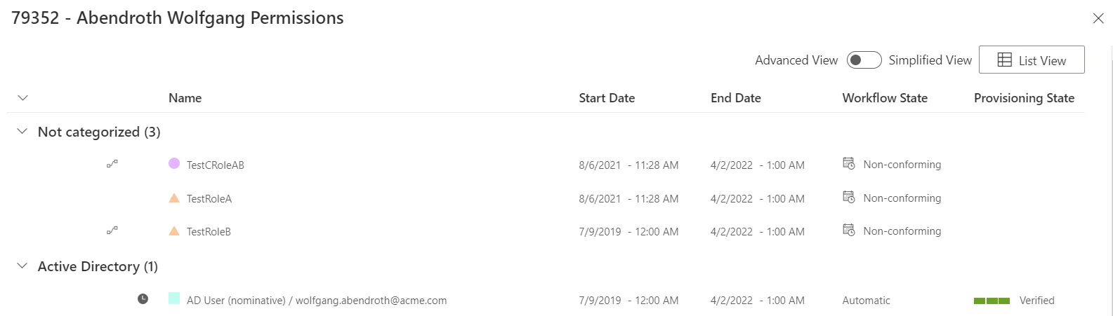

Indirect permission display
After running a Compute Role Model task, Indirect Permissions should now appear for your test user.
The next screenshots were taken after adding the direct assignment directly inside the Active Directory. As such, the direct permission is also flagged as Non-conforming.
If you first go on the View permissions tab of your test user, the only new role that appears in the Simplified view is the indirect Composite Role TestCRoleAB:
View Permissions Simplified
To display Indirect Permissions, you need to switch over to the Advanced view. TestRoleA and TestRoleB should then appear:
View Permissions Advanced
