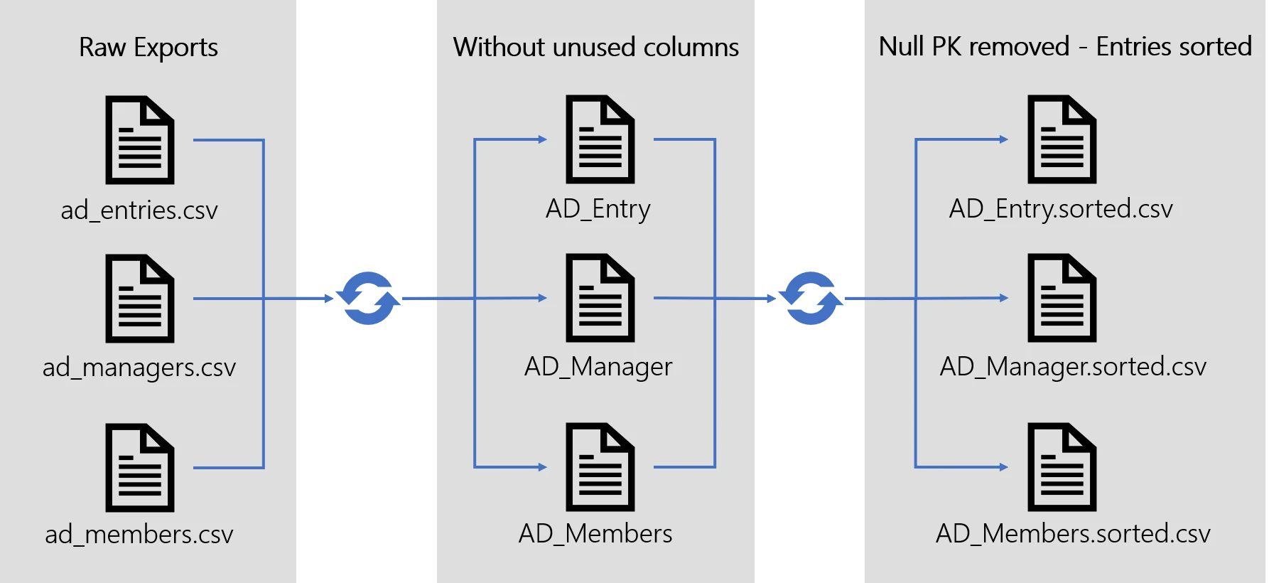

Example
The figure models the complete Prepare-Synchronization steps applied to an Active Directory export. The matching Connector defines an Entity Type AD Entry and two associations (members and manager).
Active Directory Prepare-Synchronization Example
