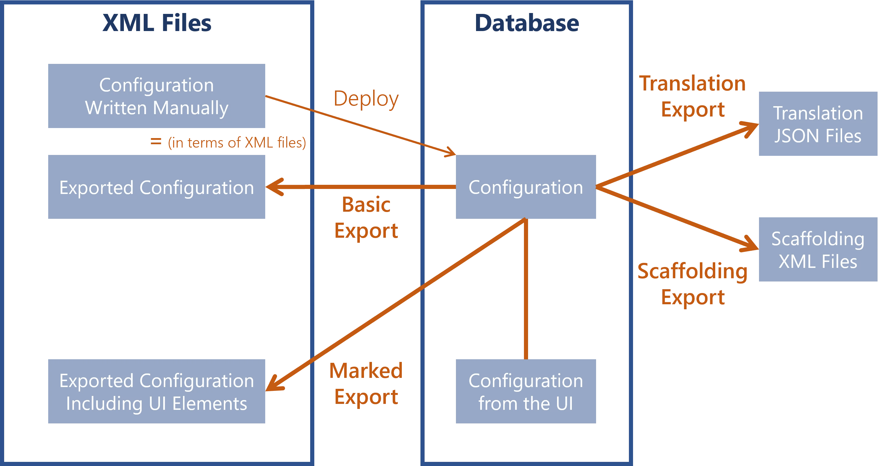

While the deployment process is about taking the configuration elements from the XML files to insert them in the database, the export process is about taking the configuration elements from the database to generate XML files:
  • a basic export will export the XML configuration that was latest deployed to the database, including images like logos and favicons;
  • a marked export will export the whole configuration as XML files, including the configuration elements created via the UI;
    As Usercube can be configured by writing manually in XML files and/or using the UI, the marked export helps combining both.
    NETWRIX recommends configuring Usercube via the UI as much as possible, and completing the configuration via XML files when needed.
  • a translation export will export the translation JSON files;
  • a scaffolding export will export the XML configuration generated by scaffoldings.
Schema - Export Process
For all export types, NETWRIX recommends using as output directory a folder other than the one containing the old XML configuration. This way, the exported configuration does not overwrite the old one, and:
  • the changes can be clearly viewed in a file comparison tool;
  • the interesting changes can be selected individually and inserted in the old configuration, to update the configuration while keeping any manual changes such as comments.
