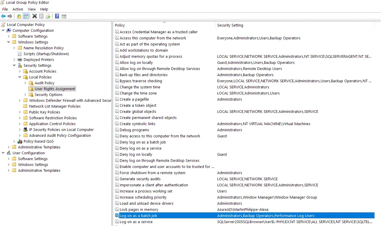

Implementing this connector requires an account with the permissions:
to access all relevant folders and files and read their entitlements;
Log on as a batch job in the local group policy, when the connector's authentication mode is batch.
