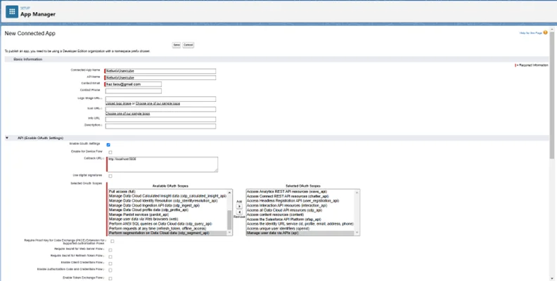

Connect the application
To connect to the Salesforce application do the following:

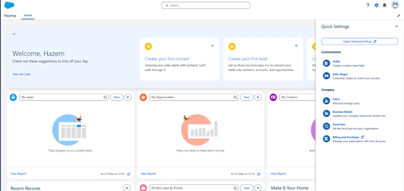

Step 1 – Log into Salesforce using an admin account.
salesforce-advancesetup
Step 2 – Go to Advanced Setup.

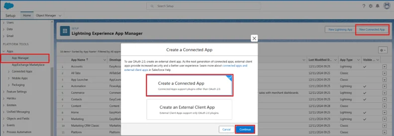

salesforce-newconnectedapp
Step 3 – Go to App Manager and Create a Connected App.
salesforce-enableoauth
Step 4 – Fill in the details of the application: Application Name, API Name, Contact Email, select Enable OAuth Settings, and complete the mandatory information as callback URL and OAuth Scopes.
Step 5 – Save the Application.

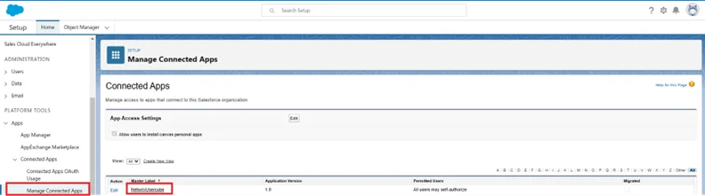

salesforce-manageconnectedapps
Step 6 – Go to Manage Connected Apps and click on the newly created application.

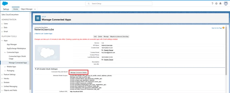

salesforce-manageconsumerdetails
Step 7 – Click on Manage Consumer Details.

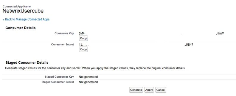

salesforce-consumerkey
Step 8 – Copy the Consumer Key and Consumer Secret in your Keypass.

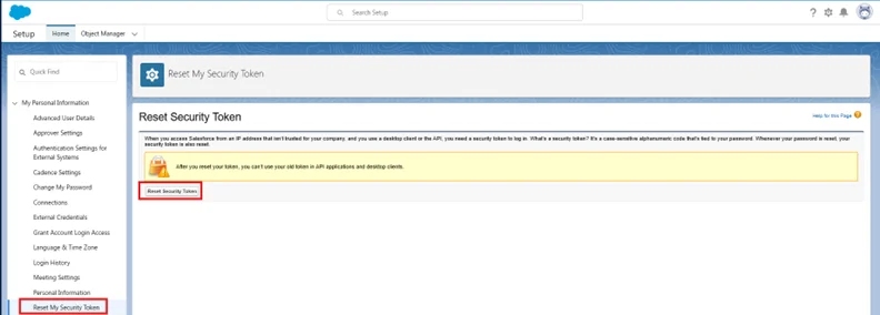

Reset the user token
To reset the user token do the following:

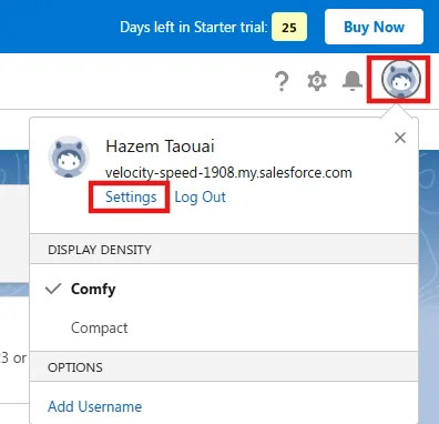

salesforce-usertoken-settings
Step 2 – Click on Settings under the profile details.
salesforce-resetseuritytoken
Step 3 – Click on Reset My Security Token.
salesforce-checkemail
Step 4 – An email containing the new token will be sent.

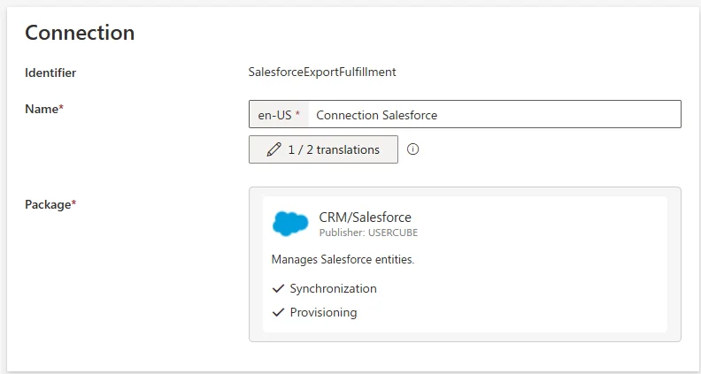

Step 1 – Log into Usercube using an admin account.

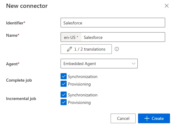

salesforce-connector
Step 2 – Create a new Salesforce connector.
salesforce-connection
Step 3 – Add a new Salesforce connection.

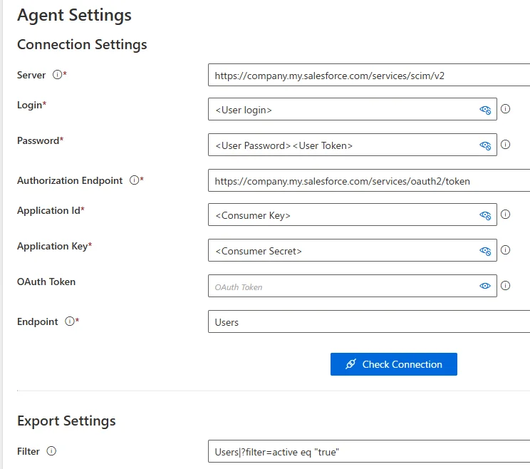

salesforce-agent-settings
Step 4 – Fill the fields in the Connection Settings and choose the Filter.
The configuration of the Salesforce connector is completed.
