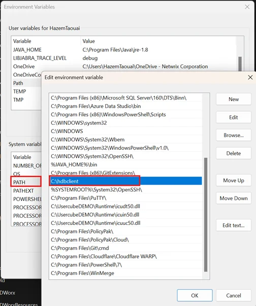

Step 2 – Unzip the “hdbclient.zip” archive to C: drive and add the path to the Path environment variables.

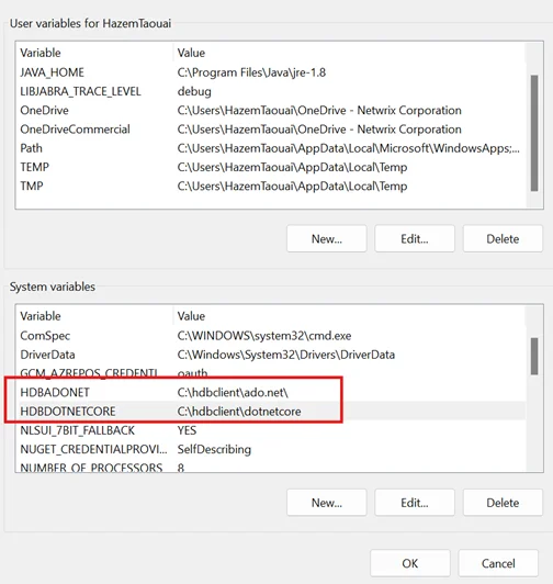

Step 3 – Create environment variables: HDBADOTNET=C:\hdbclient\ado.net and HDBADOTNETCORE=C:\hdbclient\dotnetcore.

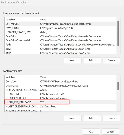

Step 4 – Disable DLLs search by adding the environment variable NLSUI_7BIT_FALLBACK=YES.

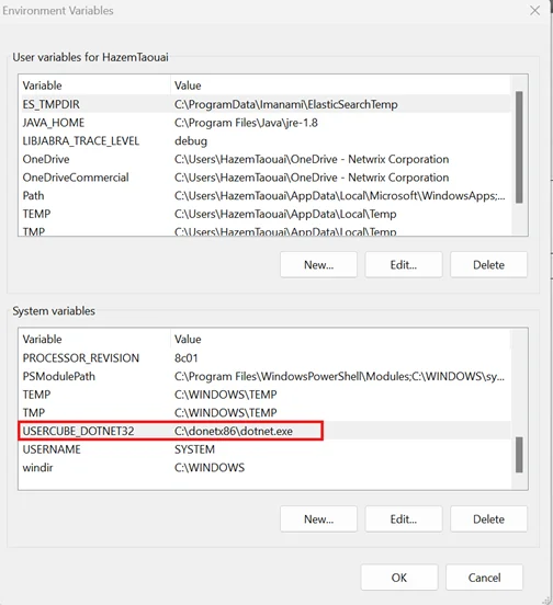

Step 5 – Add new environment variable USERCUBE_DOTNET32 containing the path to dotnetx86 (e.g.: C: \donetx86\dotnet.exe).
