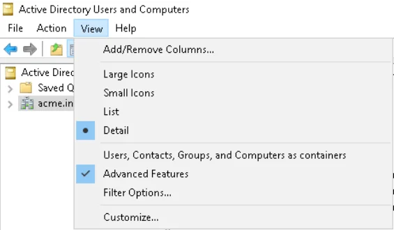

- enabling rights inheritance in the Advanced Security Settings.

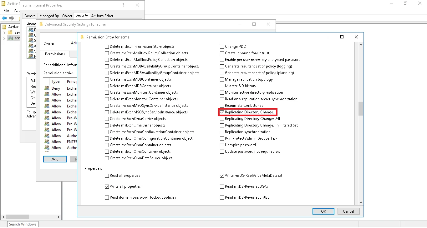

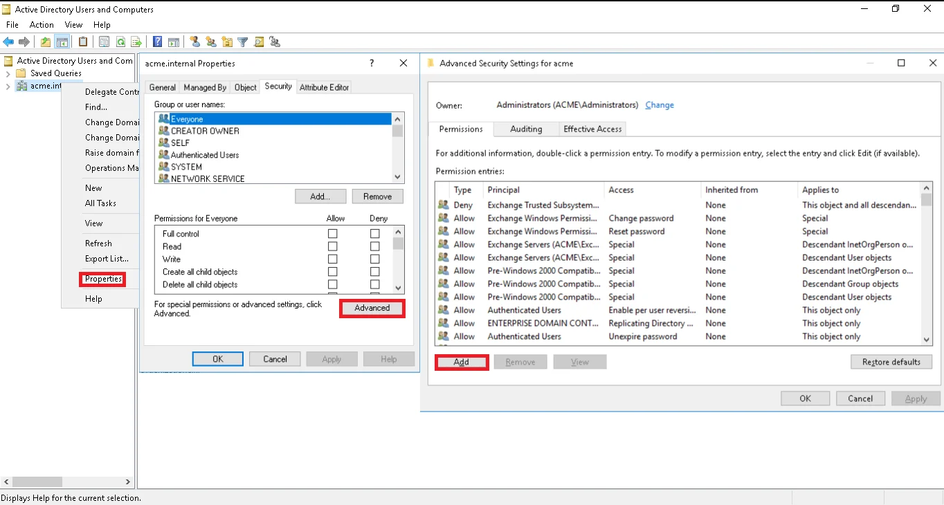

Enable Active Directory Permissions
To enable permissions, the Active Directory administrator must open the Advanced Security Settings dialog box for the domain root and select the Replicating Directory Changes check box from the list.

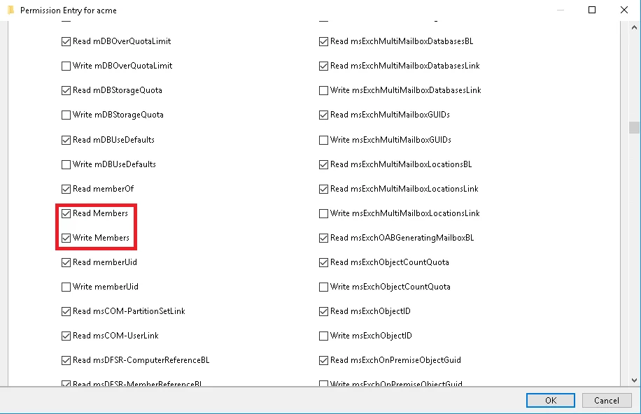

Also, in order to change groups' membership, in the Applies
field, select
Descendent Group object
and select the Read Members and Write Members check boxes from the
list.
