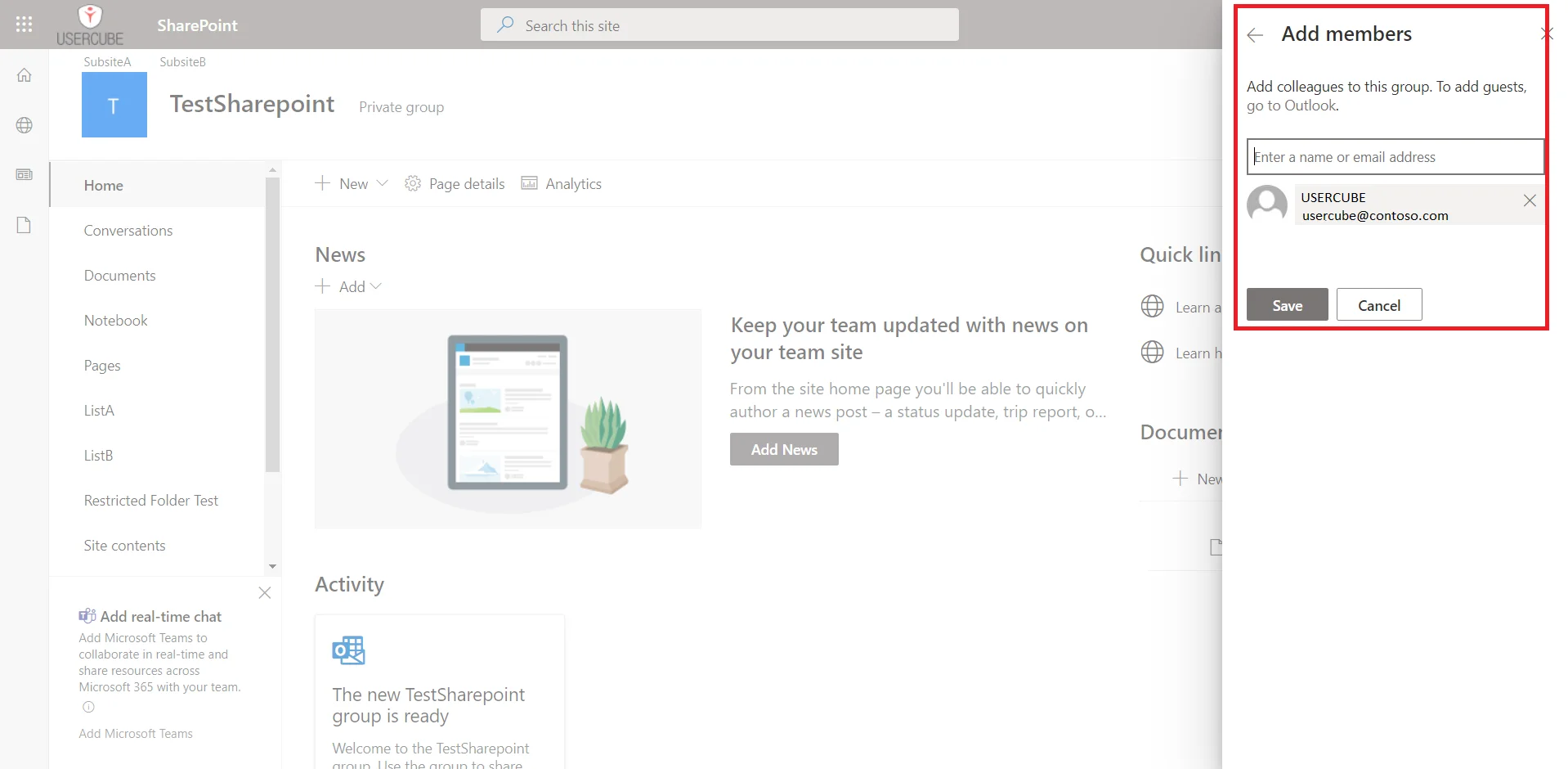

- Go to the Members List in the right corner.
- Click on the Add members button.
- Enter the name of the Usercube service account or its email address.

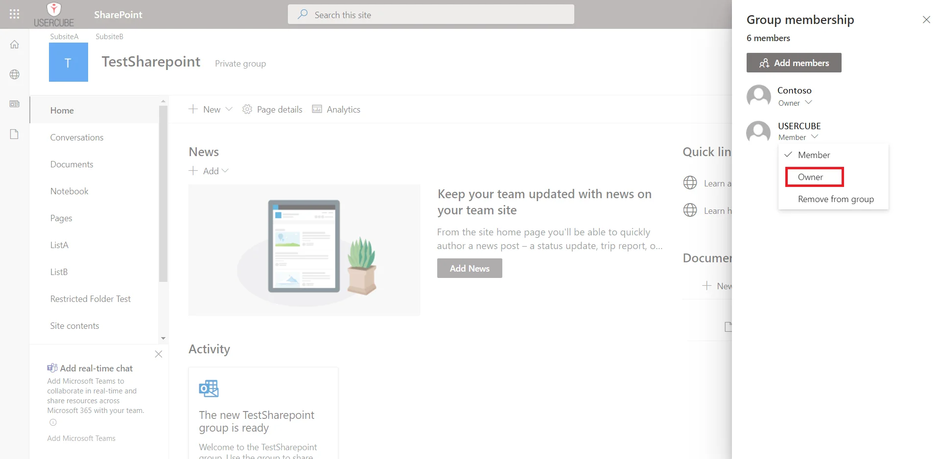

The service account is now a member of the site. However, to scan the site, the service account needs to be owner of the site.
- Under the name of the Usercube service account, click on the arrow.
- Choose Owner.
