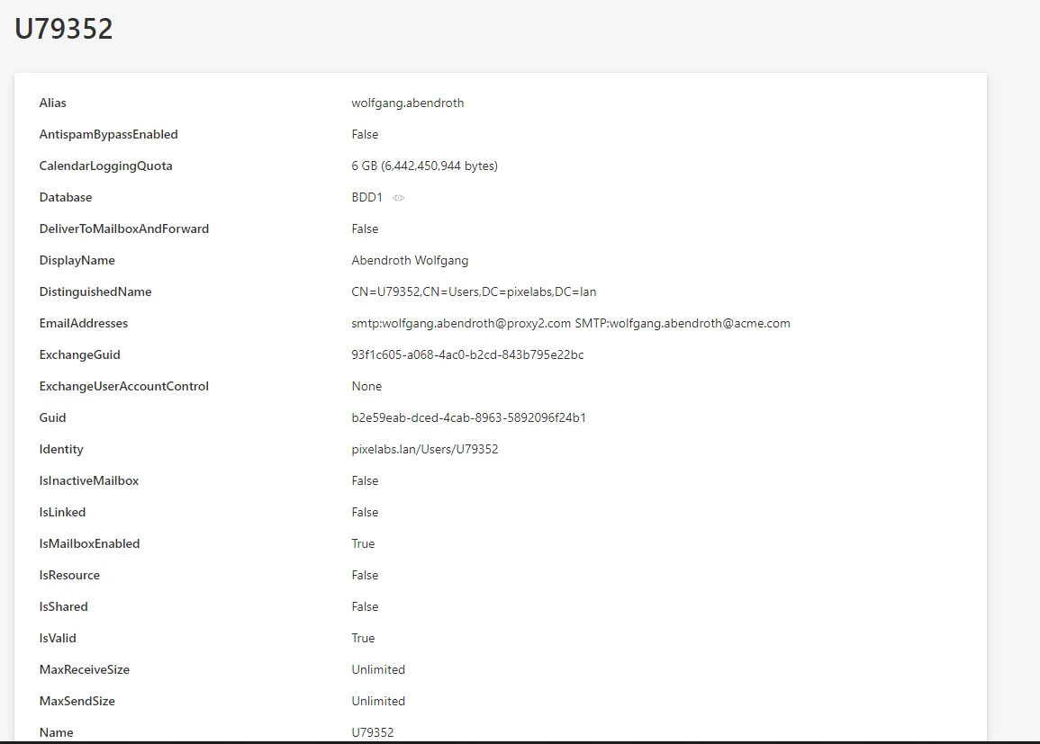

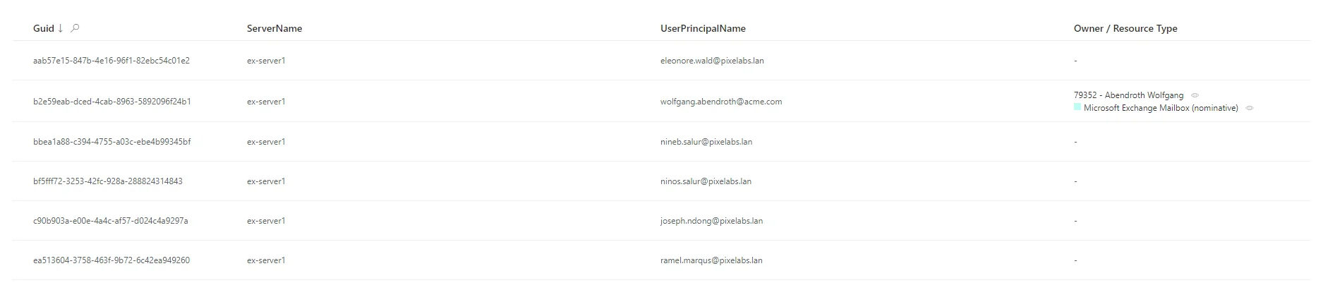

Interface display
The Synchronization job should be found in the UI, under the Job Execution menu, with the name input in the Job's DisplayName_Li attribute.
From there, the Synchronization job can be launched and debugged (if needed).
After execution, Microsoft Exchange resources and databases should be in the UR_Resources table of
the SQL Server database.
The results can also be viewed on the UI:
