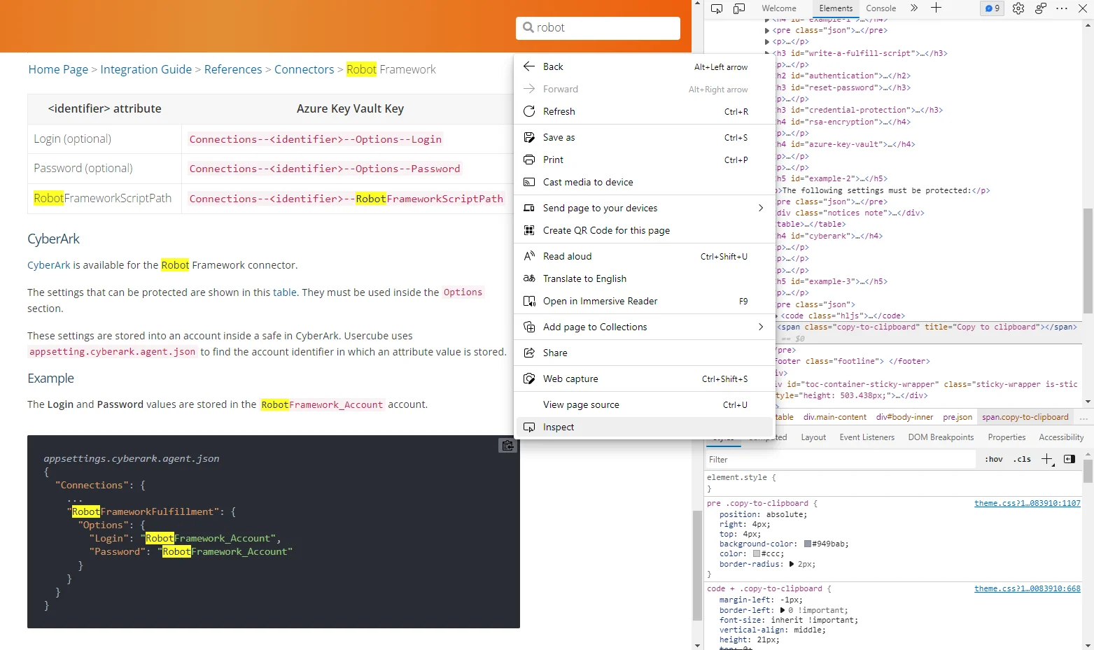

The basic structure of a web page is defined with HTML. It is accessible with the inspect tool, which can be opened by pressing the F12 key on most browsers. For Selenium, we want to find information on specific parts of the page. Inspecting an element can be done by right clicking the element, and clicking Inspect.
Inspect Tool
Suppose the goal of the script is to copy the content of the code block, and paste it to a file, to ensure that the file is up to date with the documentation. To do this, the Robot Framework has to click on the copy to clipboard button with the keyword Click Element.
Locating elements
As stated in the Robot Framework SeleniumLibrary documentation, the keyword Click Element requires an element locator. The element locator identifies which element the Robot Framework should click. To ensure the right element is clicked, the element locator should only match the one element which should be clicked.
In the HTML, the button has a class class="copy-to-clipboard". The element locator class:copy-to-clipboard matches the button. However, there are other buttons with the same class on the page. The easiest way to click the right button is with an XPath element locator.

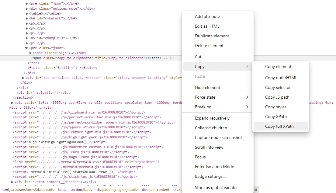

XPath element locators
Each element on the web page has an XPath, and each XPath uniquely identifies an element. This means that we can always use an XPath locator. To get the XPath of an element, inspect the element, then right click it in the HTML, and click on Copy > Full XPath.
Copy Full XPath
For the copy to clipboard button, the XPath is /html/body/section/div[2]/div[3]/div[1]/pre[4]/span.
XPaths change as the page is updated. Using a location strategy other than the XPath strategy should reduce the maintenance needs of the script.
