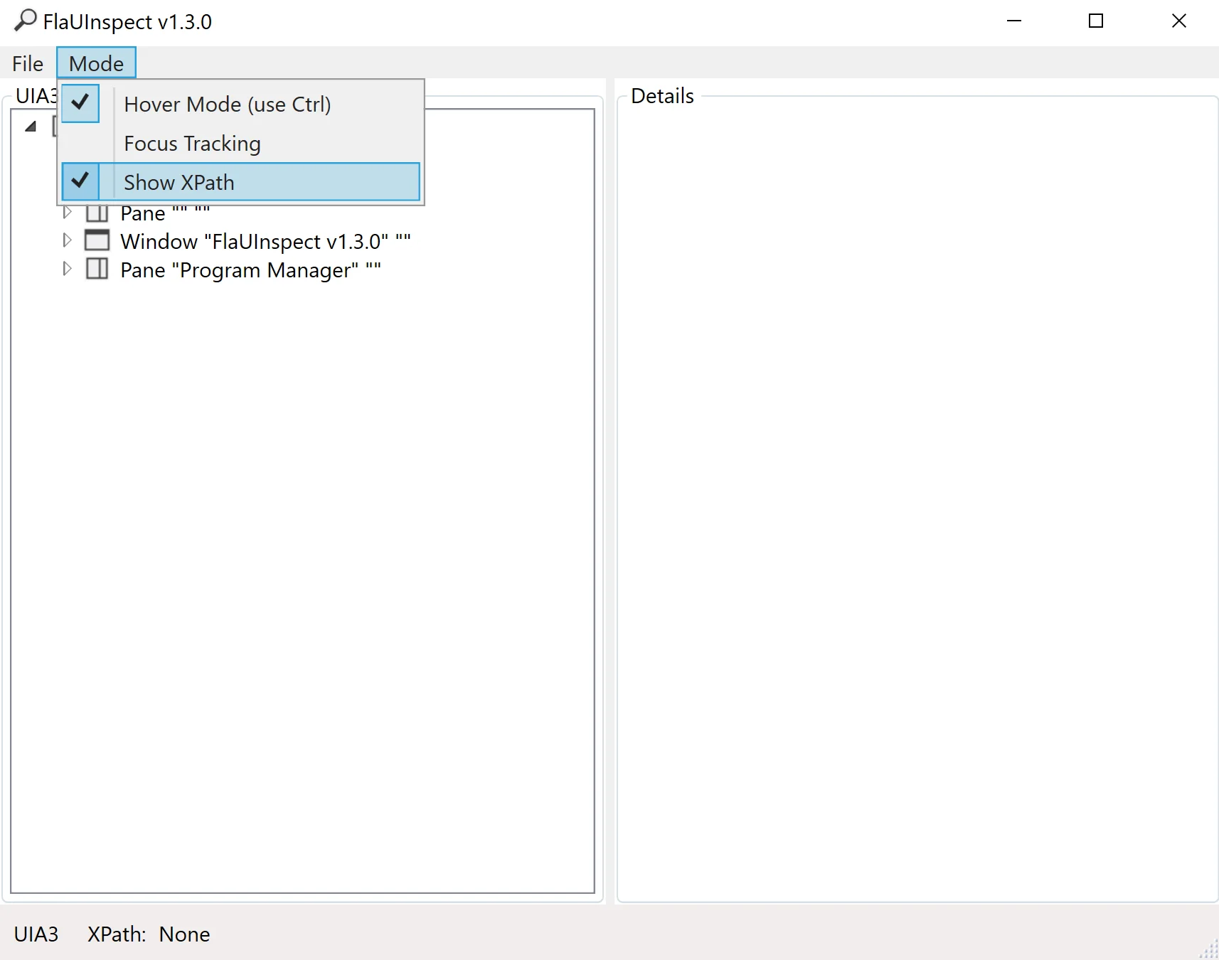

The FlaUI inspection tool shows each window that is open on the computer. To find the element the script is supposed to interact with, it is possible to manually search through the windows, and through the elements. However, the easiest way is to use the Hover Mode, which is accessible in the tool bar by clicking on Mode > Hover Mode (use Ctrl). To see the XPath, click on Mode > Show XPath.
Show XPath

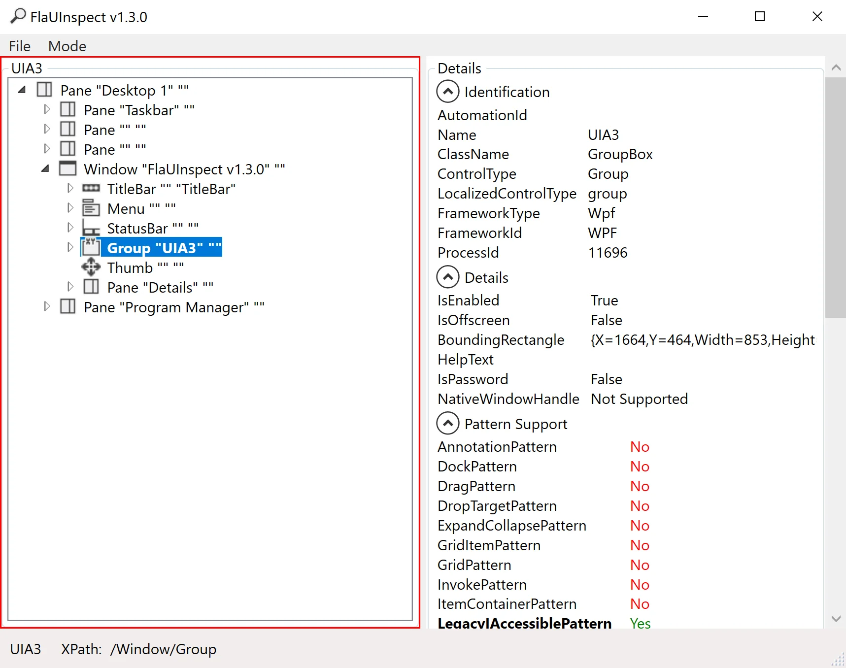

To see the XPath of an element, hover over the element, and press control. A red box should appear around the element, and the FlaUI inspection tool should show the element's information. The XPath should be at the bottom left of the FlaUI element.
Highlight Element
