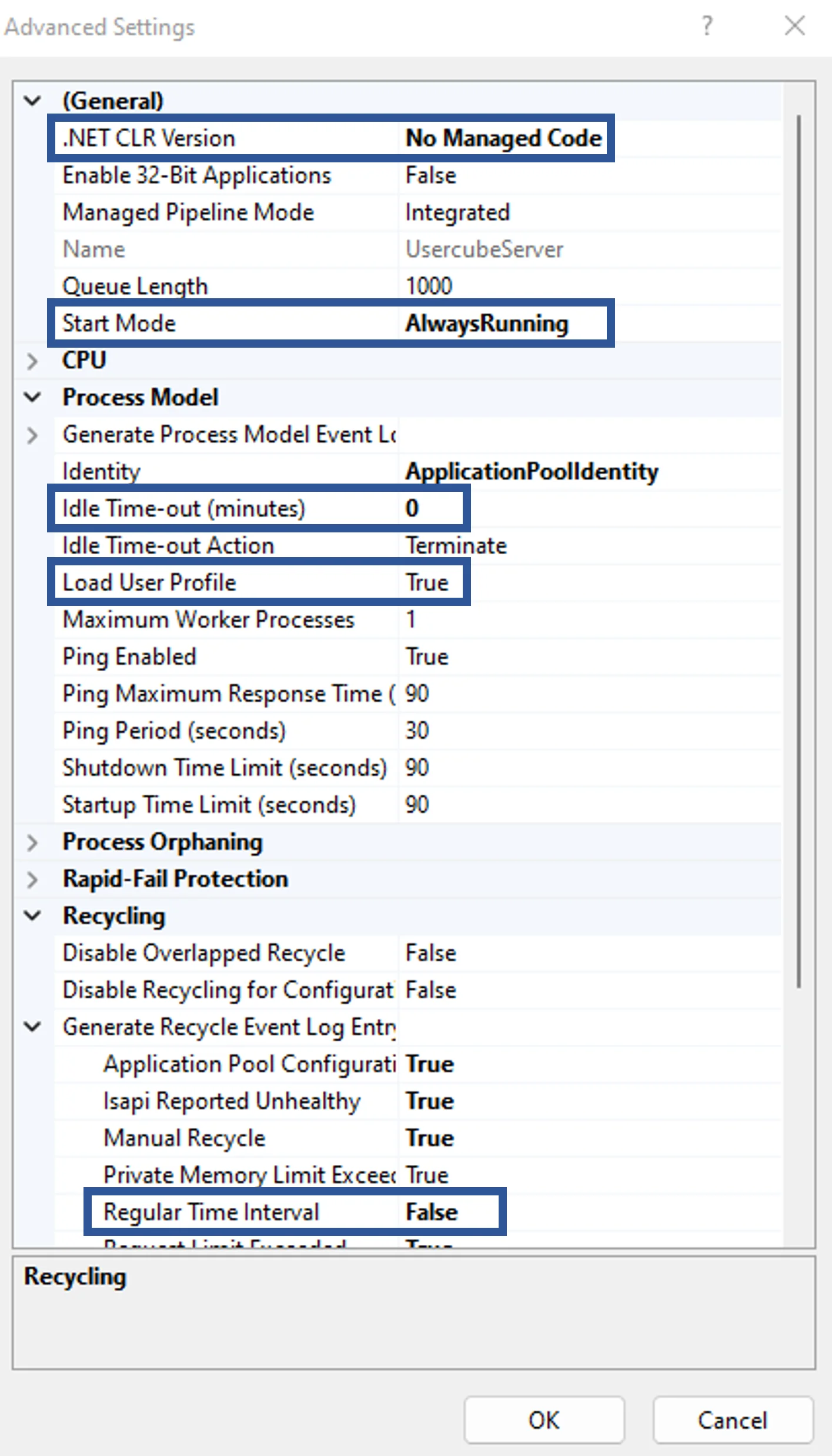

After creation, the following settings are recommended:
  • Application Pool > Usercube<Organization> > Advanced Settings > General > Start Mode set to AlwaysRunning;
  • Application Pool > Usercube<Organization> > Advanced Settings > Process Model > Idle Time-out (minutes) set to 0 and Load User Profile set to True;
  • Application Pool > Usercube<Organization> > Recycling > Regular time intervals set to 0.
    Recycling the application pool creates a discontinuation in the connection between server and agent, which can disrupt some of Usercube's features such as the job scheduler. IIS already recycles the application pool at each setting change, thus NETWRIX recommends not using periodic recycling.
The following is mandatory:
  • Application Pool > Usercube<Organization> > Advanced Settings > General > .NET CLR Version > No Managed Code
To sum up IIS settings:
IIS Settings
