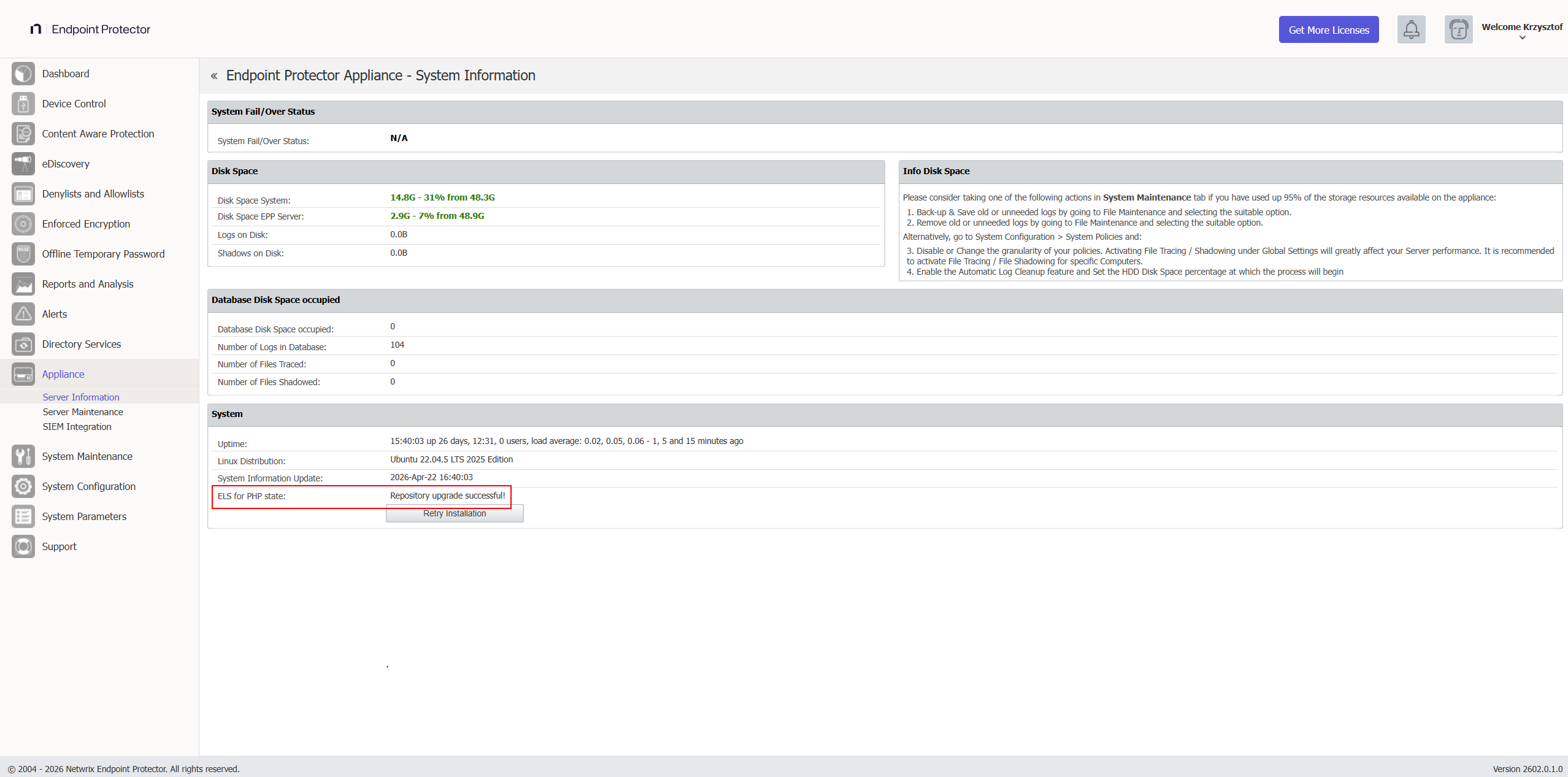

How to verify ELS for PHP is active after import:
  1. Navigate to System Configuration → System Licensing → Import License and upload the license file that contains the php_els field.
  2. After import, go to Appliance → Server Information.
  3. Confirm that "ELS for PHP = Active" appears.
Appliance → Server Information — license
If you imported the license successfully, the Server Information page shows:
Appliance → Server Information — ELS for PHP = Active after license import
If errors appear instead:
Appliance → Server Information — ELS for PHP = Error after license import
Resolution: If ELS for PHP isn't Active after import, contact Netwrix Support or your account team for a refreshed license — the server can't receive OS and patch updates without it.
